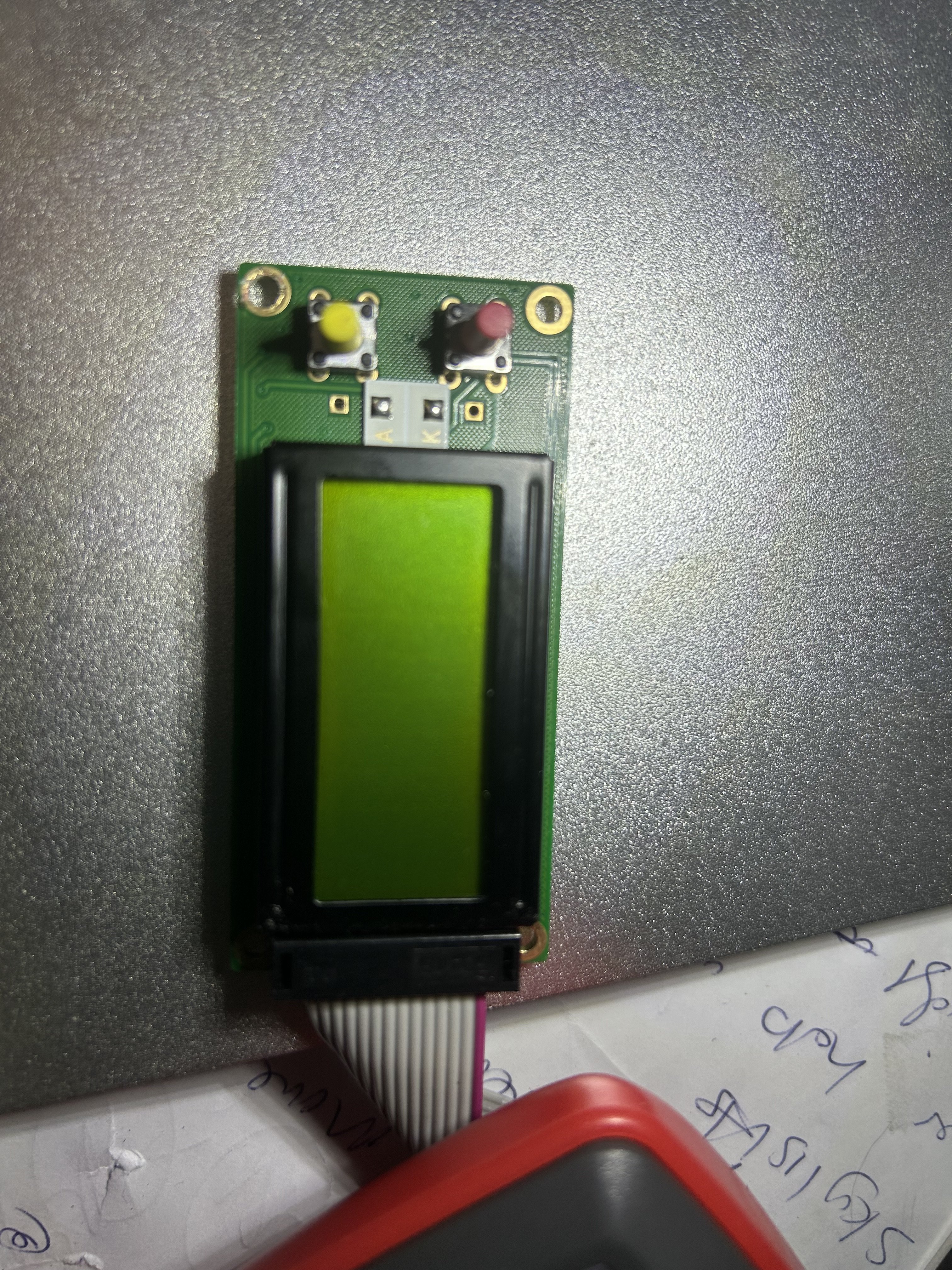

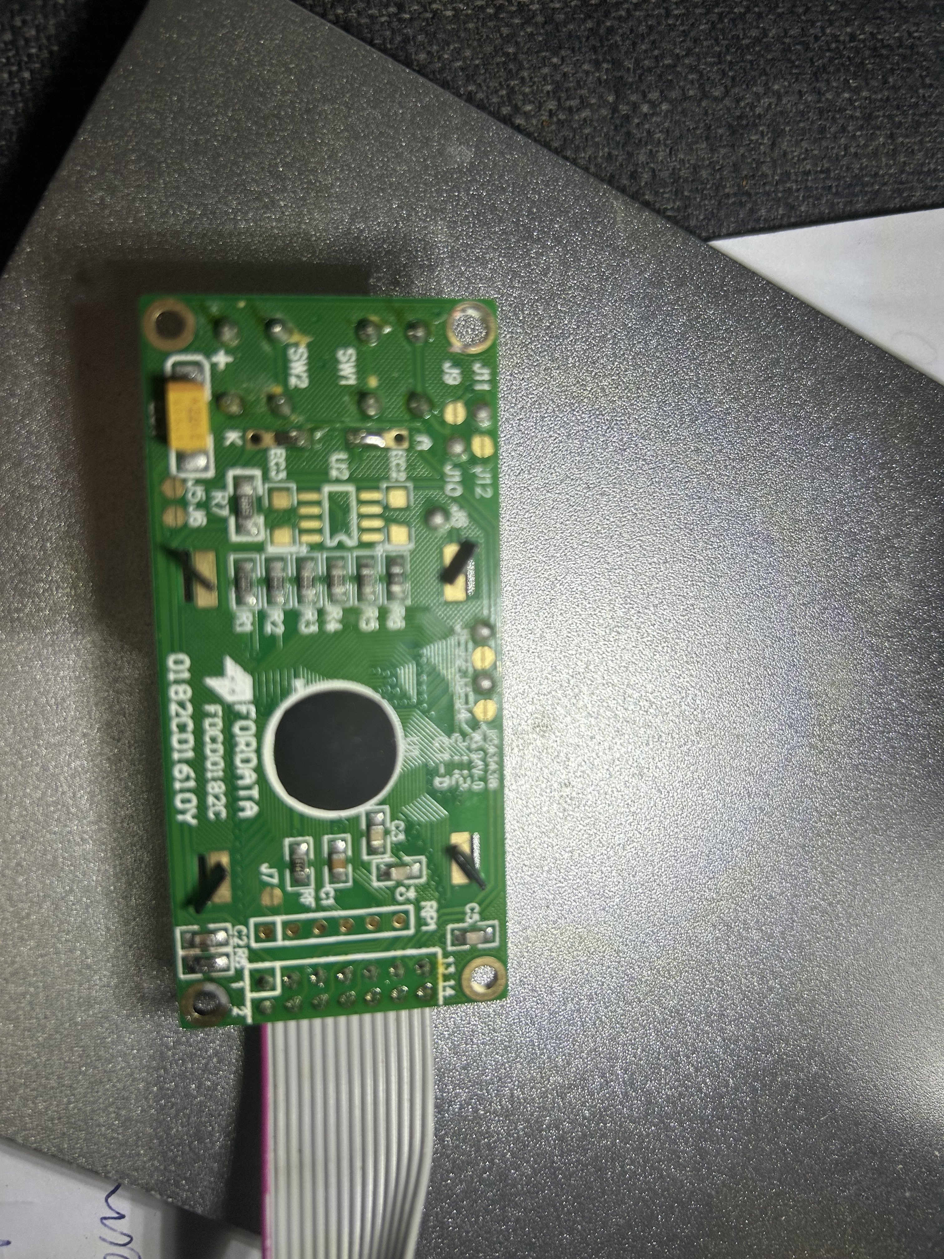

Had to give up on this! The lcd display seems to be at fault but I could not find an exact replacement, nor could I find a faulty component on the display either.

Thanks for this, when I had the unit out I checked the internal blade fuse it was good, The lcd backlight flashes on when I power the unit on so I think it's getting voltage? The batteries are fully charged as the EHU is connected
