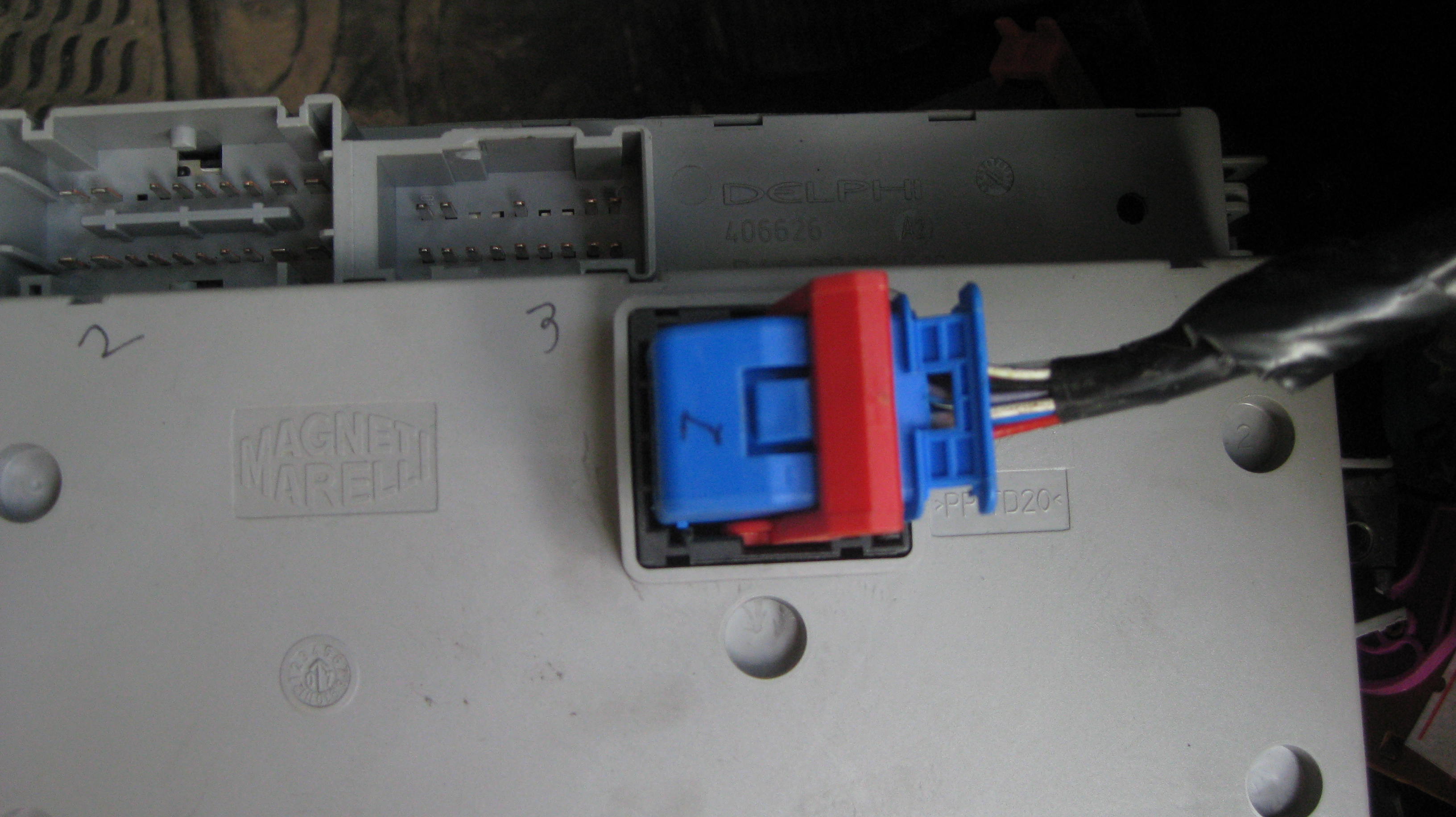

I managed to take some photos of the offending socket on the back of the Fuse Board. This central socket is made up of a White , Green and black Dil connectors clamped into a housing . The problms is on the Green socket that has approx 10 wires coming out. I cant trace where they go though. Any ideas on how to get hold of a wiring diagram that would tell me ?

I have got a vague recollection that the green block you show is connected to that block I was blathering on about...
It's the pink wire that reminded me....
I may be mistaken - memory is a strange thing - but I can usually find my way home without sat nav if I'm shopping locally. After a couple of tries... ;)
