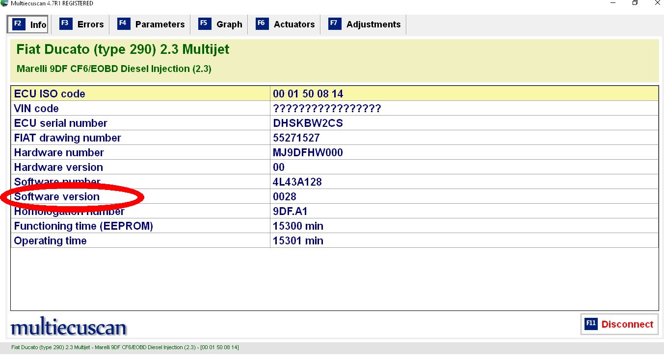

Will a Software update turn my van into a 1/4 mile Monster? No i don't think so . There were a number of software versions possibly used in the twin egr version from 16,18,23,24,25,28,32. It would be interesting to know what version you have. Mine left the factory Nov 2016 and was updated to V028 march 2019 at first service. V28 is the last version issued for manual V32 is for automatics normally but some people (manuals) have convinced dealers to update to 32. Now question is why so many versions? We know there were issues with regeneration and cracking of DPF leading to blocked LPEGR cooler.

Hi theoneandonly, yes to all of the above and v28 I am informed is the most recent👍I’ve located this thread on out and about, Remapping a 2018 Ducato:
It gives encouraging info on stronger 3L gearbox on the 150, the MHF forum also gives a thumbs up for the software upgrade. I’m an electrician, what do I know?? Cheers
Evening the 1 an Only, It doesn’t surprise me that, that question prompts ‘thumb up bum, mind in neutral’, not too many old skills left😞
Lost without a diagnostic! I have now (son bless), sound advice…watch this space and once again, thank you very much 👍
