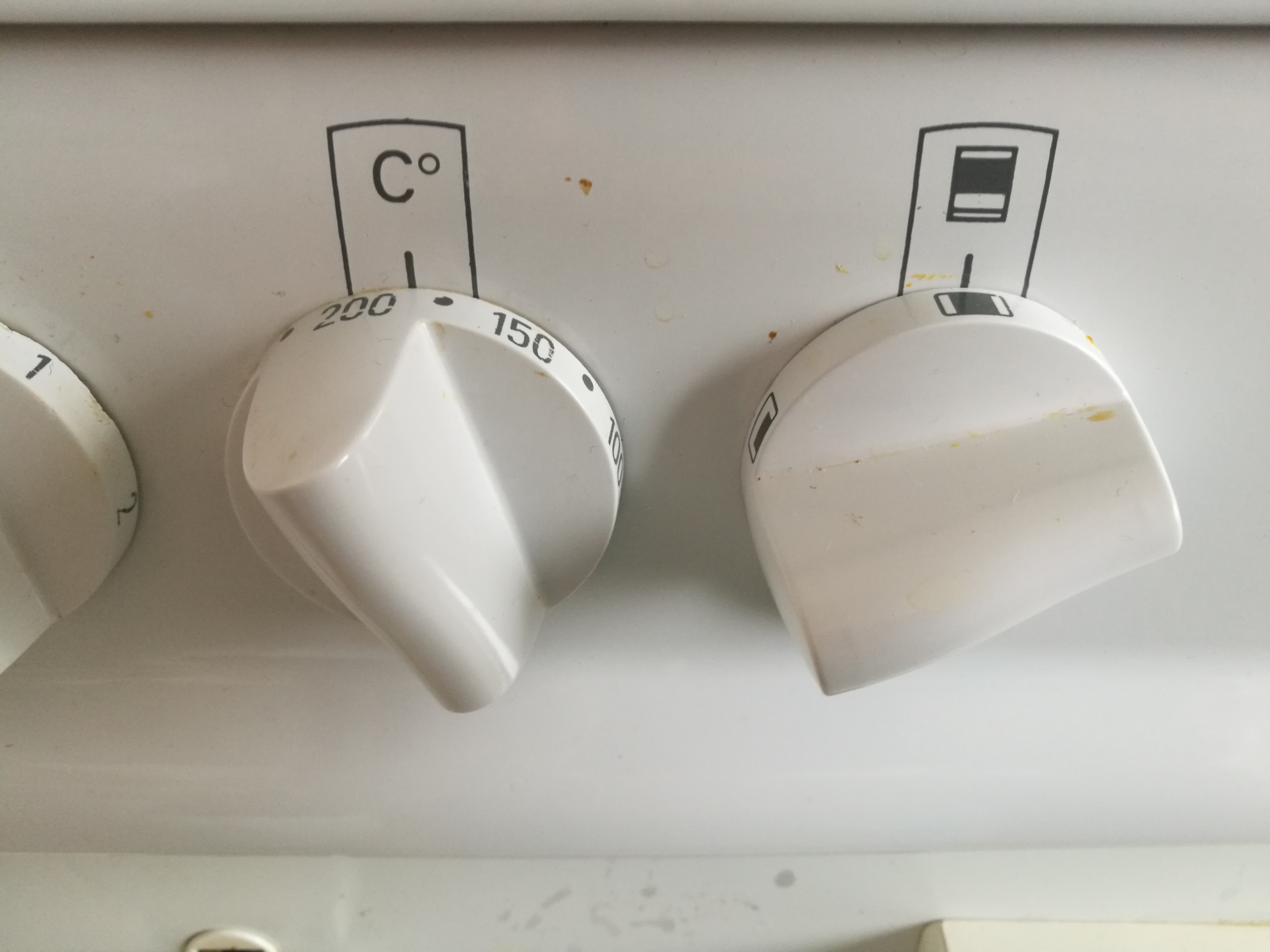

Hi! Sorry that it has been some time since i updated to here the results of my ecu baking. I baked my ecu in 190°C for 9 minutes at last october and all the problems are gone. I've been driving now over 6000km after baking, couple of times to Russia and back (i live in Finland) and i'm so happy how well the baking worked out!! :D
