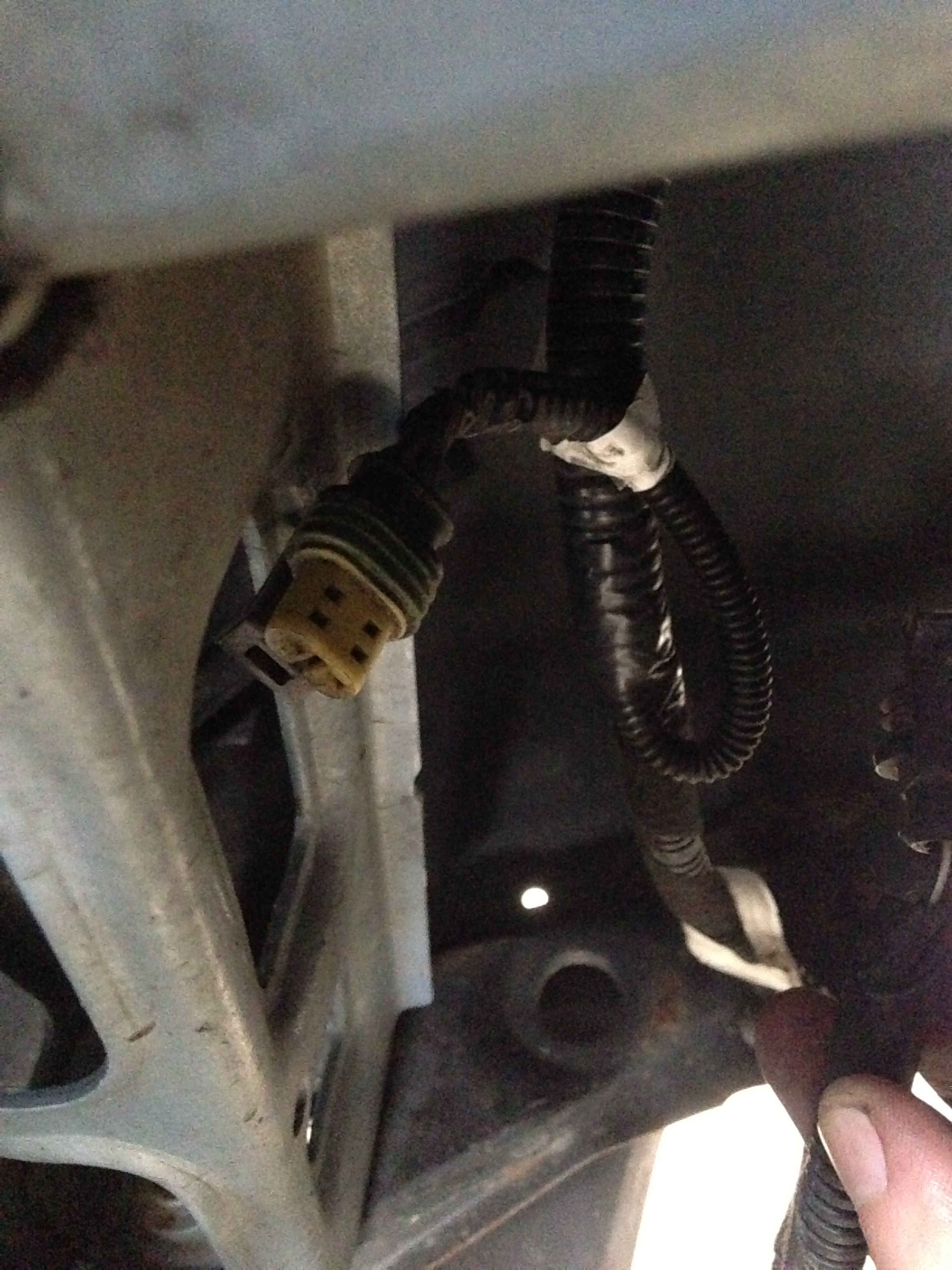

One thing I just noticed though, is that there's a bundle of wires with two electrical connectors not attached to anything. They're on the driver's side right at the front and are just hanging there loose. I'm assuming this can't be a good thing - does anybody know if this could be something to do with the problem? The other end of them seems to be connected to the headlight unit, but all of the lights and indicators work fine. Photos in the next message...
Photos showing the loose connectors and where they seem to join the back of the headlamp

That wire belongs to something else.

Grey is part of the a/c loom
Your like me - I have the same connector but no ac components at all!!
It was when the production line ran out of the specific loom for your car
Instead they stuck a higher spec loom in, cheaper then waiting for the part expensive loom in, cheaper then stopping
The same with the yellow connection, that appears to be a fog light connection
Ziggy
Thanks very much Ziggy for clearing up the mystery wire! Looked more ominous than it is then.
