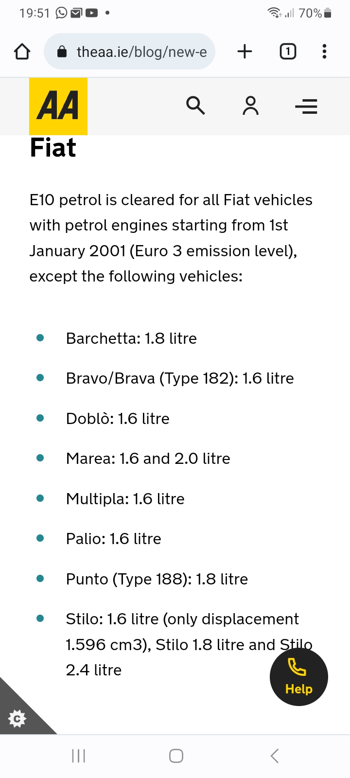

Hi everyone. Has anyone had any issues running there older Fiat's on E10 petrol. Mine is a 1995 Gt Punto and all recommendations say its not to be used at all in anything older than 2001 Fiat Engines. It also says if it non compatible to continue using E5 which would be great but unfortunately here in Ireland it's only E 10 that's available everywhere I've looked. Any suggestions?
