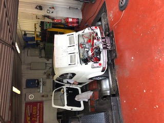

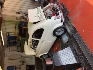

Hi Tim, I would council the following - firstly check ALL adjustable areas - valves, points, plugs, advance, timing. Make sure you don't have any leaks that could become serious when the engine is under stress. Don't over fill with oil - half way up the dipstick is sufficient, when the engine is revving hard the crankcase pressure builds up and the engine will just blow the oil out of the breather. Make sure you take spare oil anyway. clean the breather too. If you have any spare parts (jets etc) for the carb take them you will save money. Check the gearbox level - don't overfill as it will blow out of the seals. Tell the operator what you want (exactly) and set a limit on the max rpm to use - you have to drive it home after all.
(y)(y)(y) when the run is being completed check for any unusual noises - if there is ANY sign of the engine protesting STOP. Expect to feel nervous during the run it's your baby after all (y)(y)(y)
I would change the engine oil prior to going and clean the filter too. Allow plenty of time and enjoy the experience.
Tyre pressures should be spot on too. Before the run allow the engine to idle for a while to stabilise temperatures and during the run make sure the operator uses the bay cooling fan to max effect - enjoy (y)(y)
Ian.
