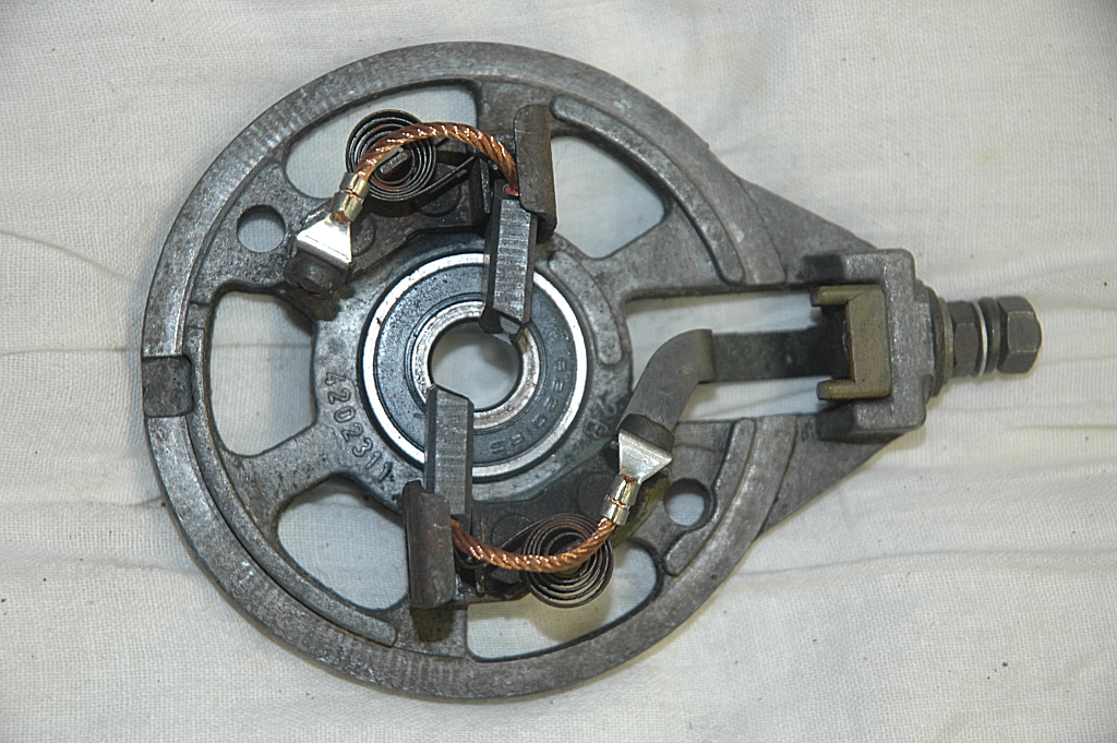

I think you will need to pull the dynamo out. It will be possible to remove the front pulley and brush end plate when the dynamo is still mounted to the car, but getting the brush end plate back on will be the difficult part. If you look at Chris’ last photo in post #3 you can see that the brushes are spring loaded towards the commutator (Commutator is not in the photo but it is significantly wider that the bearing hole in the brush end plate).
With the dynamo out of the car you need three hands to put the end plate back on. (Step 8) Two hands to hold the brushes wide enough apart to clear the commutator and one hand to then ease the end plate into position. With the dynamo in the car I think this would be difficult to say the least.

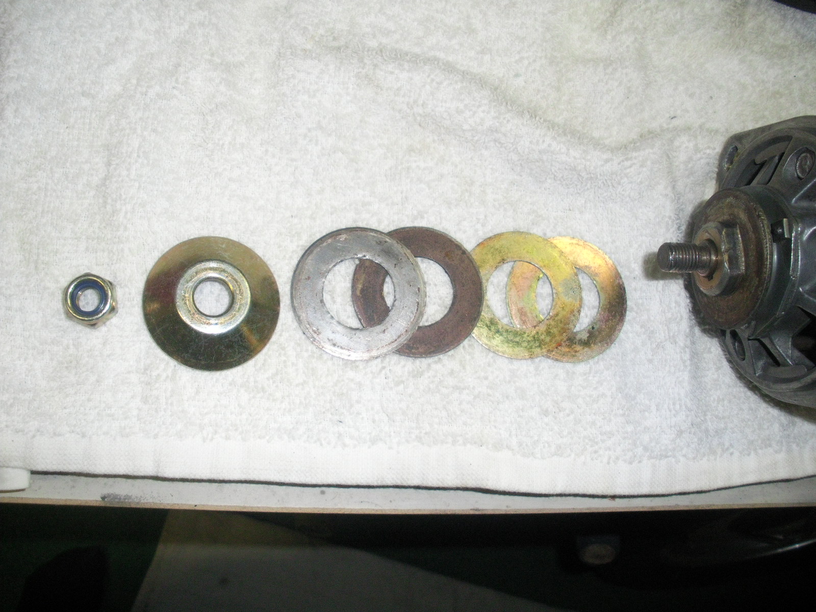

Put a ring spanner on the nut on the front of the dynamo to lock the shaft and loosen the fan nut at the back with your socket. (If at this point your body is contorted into an odd shape and you can't actually look look at what you are doing, you are on the right track.) Be careful, after the nut there is thick cone shaped spacer and then after that there is the potential for flat spacers before and after the fan unit. (See my second photo.) Take the nut off then the cone spacer and then any flat spacers. You will get to the point where the next part in sequence is the actual fan unit. Any spacers after the fan unit will only be evident after you pull the dynamo out. They will be hanging onto the end of the shaft. (I think these are the most important ones. They control the position of the fan unit within the tinware. Too many spacers and the fan rubs at the back. Too few and the fan rubs at the front. You only find this out when everything is back together correctly. If it is not correct you basically have to pull the unit out again and add or remove spacers.)

Chris' second photo shows what I could not. You can see the bolt that you need to loosen and on the other end of the red strap you can also see the pin I was takling about. Loosening the bolt takes pressure off the pin so it can removed.
