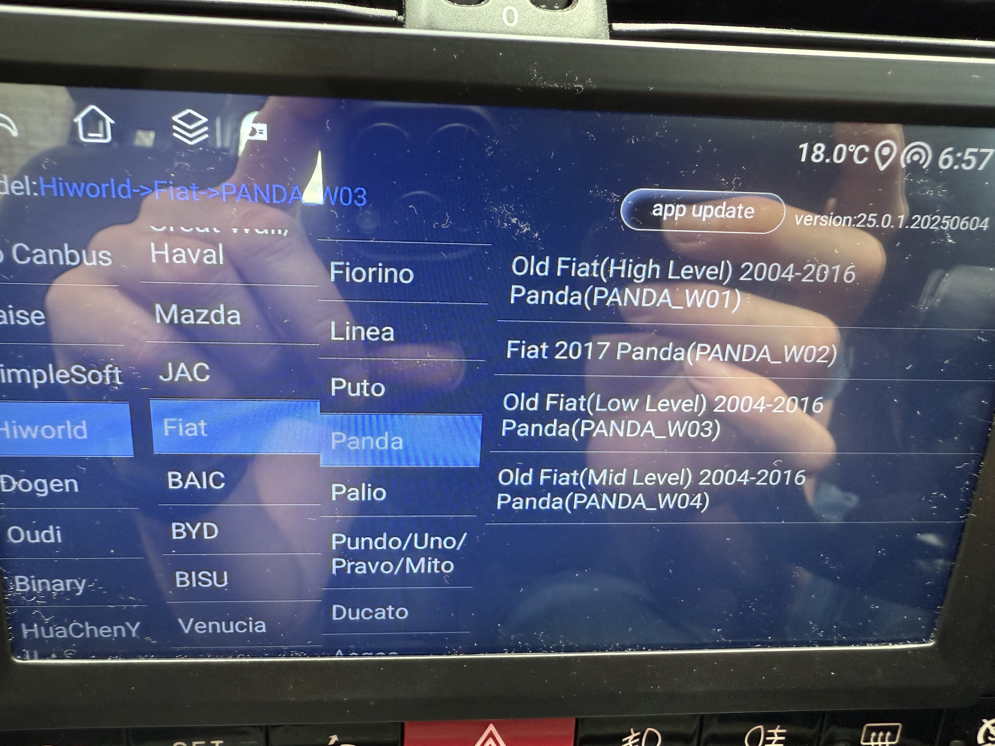

All works fine but the reversing guidelines are not dynamic does anyone have any experience in whether that is configurable in an android head unit and supported in the panda please?

You need to get into the android system with a passcode (then go into the settings like in the 1st video)
Like shown in these two videos:
(The codes shown may well not be the code for your head unit model)
Thanks Zaphod.
I have set the can to the only setting that gives steering wheel controls and completes a proxy alignment correctly! Dynamic reversing lines appear to be turned on in settings. .
