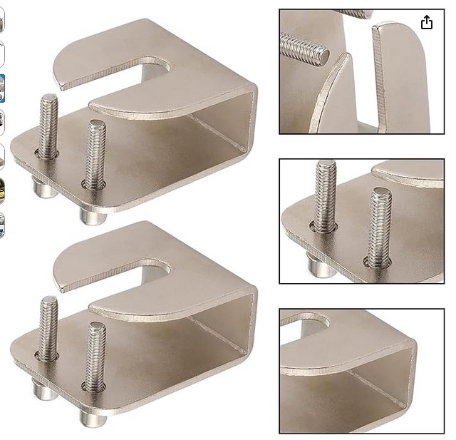

Had to leave the Panda a few days sat on the front, as life got in the way (and daughter could use my 500 anyway) As you can't get screw-in replacement ends for these cables, Dave at Intaservices said we could purchase clamp-type things that were for a Vivaro that would keep the ball-and-socket-type ends together (he'd used them before) (photo attached) We duly bought some off Amazon with the intention of fitting them ourselves, but when it came to it they were hard to get to without taking battery and tray off (at the least) and the recommended clamps wouldn't fit on very easily.
So, as I said, we left it for a bit (building a porch in the dry days we were gifted with, was more essential 🤪) Then armed with long crowbar in case the joint parted company again, and careful gear changing, we took the Panda over to Dave, who with the aid of the lift - "easier" to get at from underneath rather than removing anything - and the application of a bit of heat to the bracket to aid with a bit of gentle re-shaping, it was all done. So for £30 and a pair of clamps (one for future use) at around £7, I reckon we got off lightly.
Hope this idea helps others, there's loads of these clamps for sale, and at lots of different prices. You pays your money and you takes your choice.
