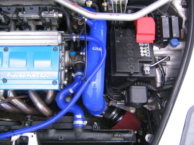

As time went on and I fitted a full super sprint exhaust system and was introduced to the GSR INDUCTION HOSE.
This is a replacement silicone hose which replaces the black twisty bendy hose and has been specifically designed and tested on the Barchetta to which gains of 10-12 hp can be achieved when coupled with a high flow filter such as that mentioned above and a few other mods and tuning is also done. My own tests on a rolling road will confirm this.
I believe the extra gains are down to the smooth surface area of the hose compared to that of the original ridged and bendy hose .
Now I have installed and made a few other modifications to my B but at the time of fitting the free flow Exhaust system from SuperSprint.
Coupled with the Silicone GSR replacement induction hose and free flow filter
At tests on a rolling road my B showed 146bhp but was lacking fuel at high revs so I then replaced my fuel pump to a Maboro high pressure and regulator and further testing and gains increased to 151bhp. :D:D
See pictures.

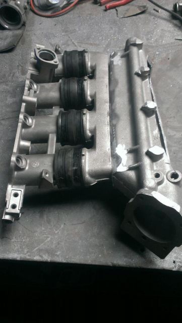

In search of more power from the B I have since then went on to have had a complete one off redesign of the original intake manifold built . Which was designed and built in the UK from Dave (MR FIXIT Engine Tuning) I have not been back on a rolling road to test this although I can confirm much more power was felt at mid to high end. Its easy to take the MPH needle over :D:D:D
See pictures .

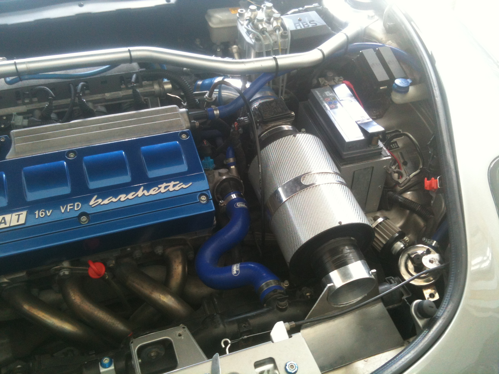

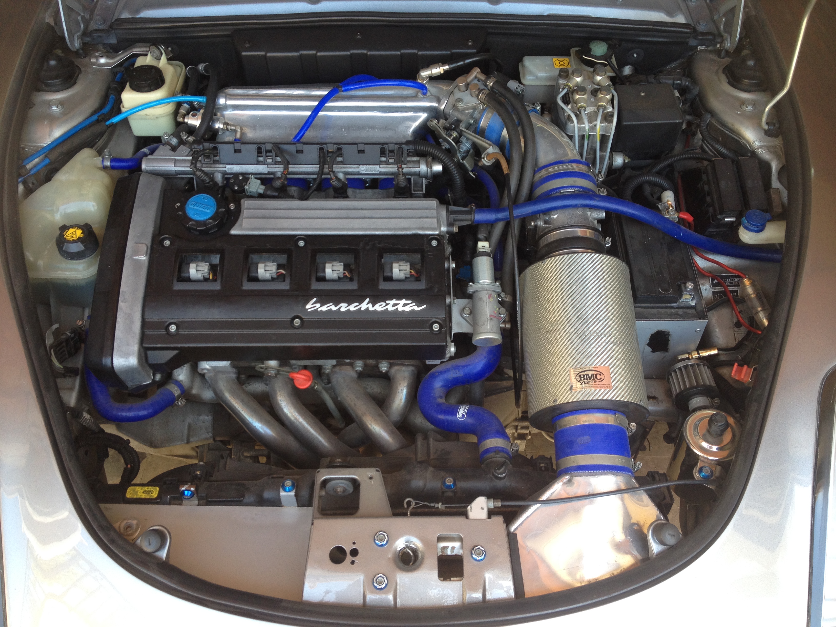

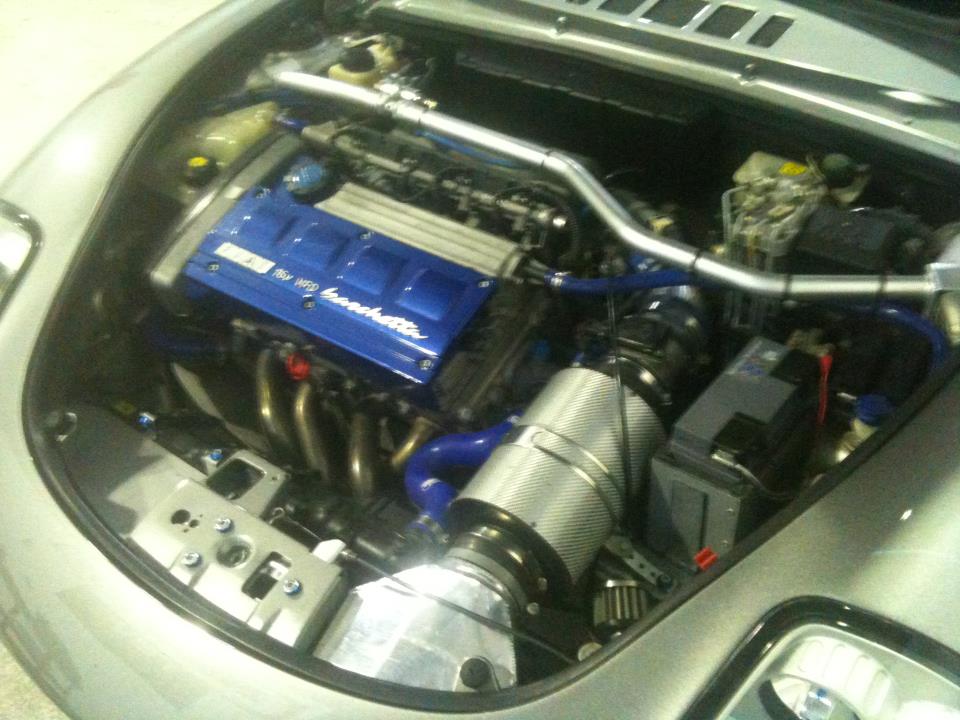

A fellow B owner in Italy who has now also had this redesign intake made by Dave who frequently races his B is always out in front of the others B owners which proves the new design works and increases power. :D :D:D
Over the years I have tinkered with my B and since gone a little further with my particular set up and design and made my own intake pipe and coupled with a sealed air filter and direct air scoop which is designed to have a ram air effect. At tests on a rolling road it was still around the 150bhp at this stage so seems to work and perform just as the GSR system.
My own personal reasons for this design is that my B is not an every day driver and usually is just taken out for a blast now and then. The ram effect does seem to have an effect at higher speeds and pushes air through the enclosed filter cooling it before entering the induction system.
See My KC3 Project Silver pg 62 onwards. for pics and design.
My current set up and induction is as the last pictures show although i have no performance charts to confirm it performance at present although my feelings are that I have gained a further 8-10 bhp from the new design intake manifold which should have me around the 160bhp or more mark.
Along with a new ported and flowed performance cylinder head I have now had built by Dave with higher lift cams which of yet has to be installed, my intention is to have a 170bhp+ naturaly aspirated Barchetta .
Hope my input has helped in any way. :)

The KMC filter you are showing is not a poxy little cone filter. There appears (not that I have discected one) to be plenty of scope for large surface area and thus better flow rate and longer performance life.
The induction length is short and appears to take air from a front facing cool area and is shielded from engine bay temperatures, unlike a quick bolt on cone filter.
Lower air temperature = increased charge density = more power
I also note that the GMC filter requires the replacement of the standard battery with a smaller lower rated unit. This is fine in a race/track/occasional use car but for an everyday car, parked outside, colder winter temperatures, etc. may not be a practical proposition.
Not knocking it at all. Just emphasising that balancing the requirements is a game of give and take and sacrafice.

Thank you, s130, great to know you approve of my design, and yes the battery is a lot smaller and as you say maybe not best suited to an every day driver, but then one could consider running new cables to the rear and fitting a battery in the boot. I had to experiment with a couple of small battery's but found this little beauty from Varta which has been very good.
With regards to the BMC enclosed filter I was once told by those that have dissected it, the actual filter inside unit is not so great and so may experiment at some stage with replacing it with something that could potentially flow better further improving the overall design & performance.
Also on the things to do list to further improve the under bonnet design and engine are to Ceramic coat the Exhaust Manifold to lower the under bonnet temperature and improve gas flow.

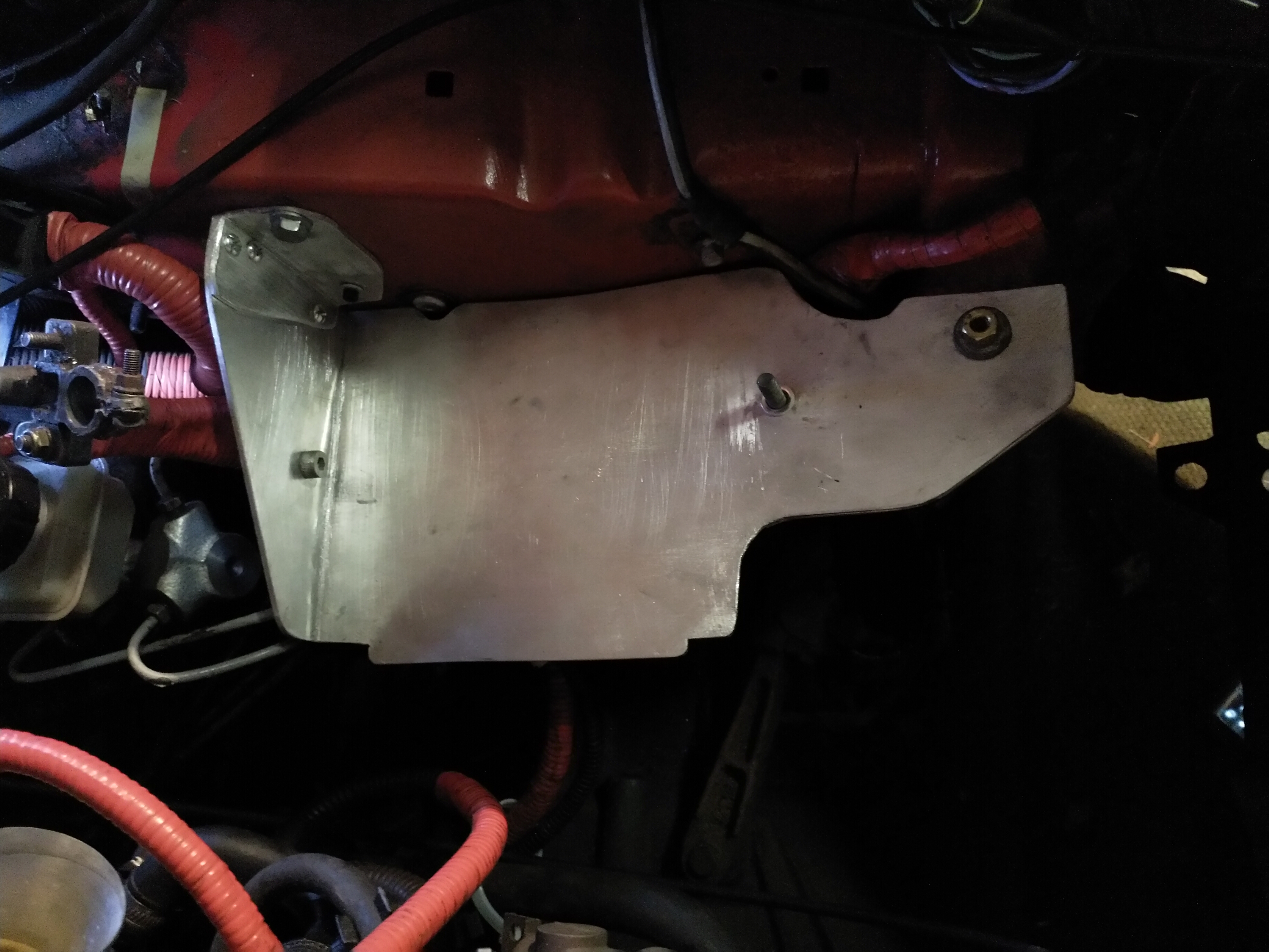

I see that the exhaust manifold heat shield has been removed in some of the pictures. I thought about this but it seemed to me that the exhaust pipe is extremely close to the lower rad hose. So, I assume this is not a problem or is there a rerouted hose available.
Yours right the task of the heatshield is to deflect the heat from the manifold away from the fan and plastic that is in the area.
I replaced my original shield with an original item. But that soon cracked and rattled at certain revs. I then made one, but that just looked ugly and cumbersome.
So I had my manifold Ceramic coated, inside and out. Does it reduce the heat, I have no idea. But as yet I see no melting of parts or issues with the shield removed.

So that I can fit my new filter I've finally got around to replacing my rusty battery tray. For now I've made it from aluminium plate, I will see how this performs regarding durability. The location of the battery tray I've moved back towards the bulkhead, not having ABS gave me the room to relocate the battery.
