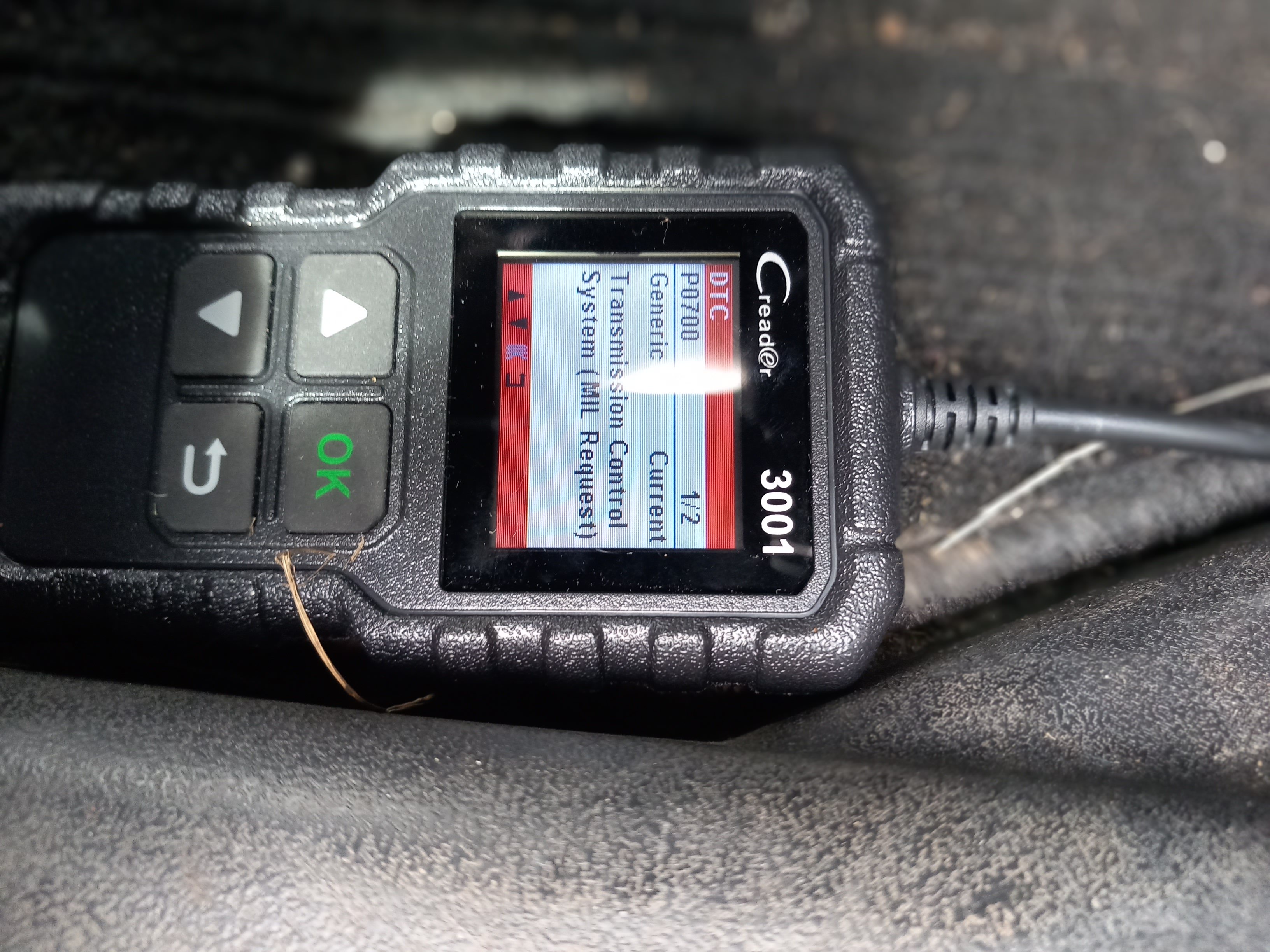

There are various things which have to be correct to allow start-up, when they are all OK then the starter inhibit relay is powered and car can start. If it will start in manual mode but not automatic then something is being misread or has a missing signal.
Almost impossible to diagnose remotely, but
MultiECUScan (with the correct cable) can read all gearbox values, which will point towards whatever is not working correctly.
