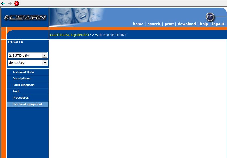

Thanks downloaded that, burnt to CD, installed. Seems to install OK. But nothing is displayed when I select items from the menu. Nothing is displayed at the end of the menu tree? Menus display fine. The error in the log file is
07/08/2020 10:32:37 N. 53 WHERE=HTML::LoadTextFile SOURCE=eLearnCDROM DESC=File not found
Picture attached
Any ideas?

Is the eLearn CD in your CD drive when you run it? Only the viewer software is installed on your computer. The location of the original disc (the CD-ROM drive you installed from) is fixed during installation and the program expects to find the data files at that location when you launch the viewer.
The alternative, which I use, is to copy the eLearn ISO image to my hard disc, mount it and run the install from there. The location of the data files is then fixed as your ISO image, so each time you want to run eLearn, you have to mount the ISO image through Windows (or your OS) then launch the eLearn program (viewer).
The only issue I find is that sometimes the ISO image can mount to a different drive letter than it used during install. I found that dismounting and remounting the image normally fixes that, but there is a Windows utility called WinCDemu that allows you to choose the drive letter to be assigned when invoking a mount command:
https://wincdemu.sysprogs.org/
Thanks for your reply.
Yes to all of that. My original solution was the virtual disk. Went back to CD to see if that was the issue.
Just tried on a separate PC which works. So need to work out why my PC is not working. Mine does not come up with the Acrobat licence agreement dialogue either. I did not have Acrobat installed. Installed that but that doesn't fix it either.
Anyway now I know I can get it to work on a PC I'll try more options to troubleshoot mine.
Thanks again
Fixed now. Just in case anyone else has a similar problem. The install was complaining about msxml4.dll. Once I installed this from Microsoft all was well
