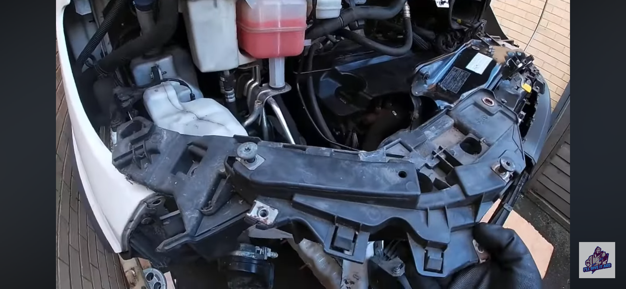

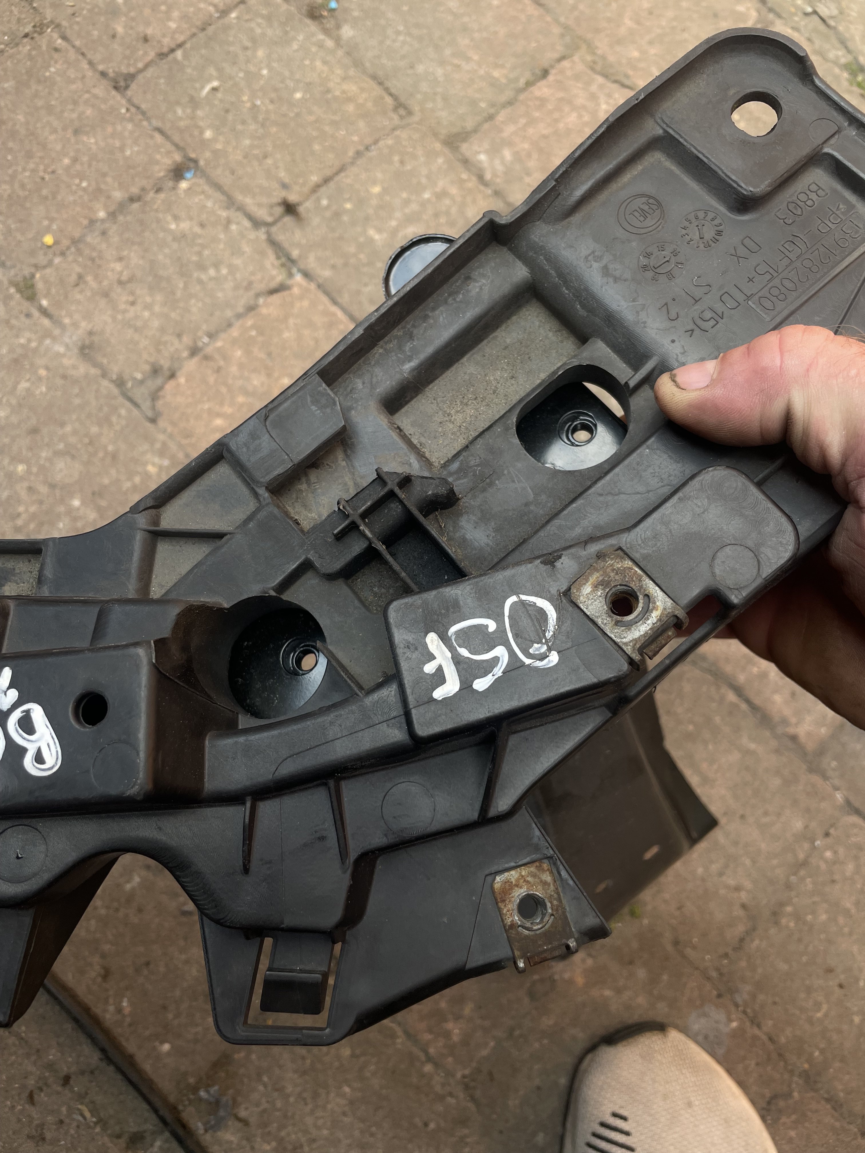

Seanwinder22 Established member Joined Jun 3, 2022 Messages 380 Points 154 Location South Yorkshire Aug 31, 2024 #1 Help needed trying to locate fixings needed to bolt down the headlight brackets to the brace panel Image shows 2 large holes then another 2 holes Does anyone know what I need please ? Attachments IMG_7768.jpeg 1.7 MB · Views: 238 IMG_7769.png 3.1 MB · Views: 146 IMG_7771.png 2 MB · Views: 204
the green vanper Distinguished member Uploaded 10+ resources/downloads Joined Feb 7, 2023 Messages 2,854 Points 1,031 Location Silesia Sep 3, 2024 #2 Hello, According to this: 55401/10 - FRONT HEADLIGHTFIAT NUOVO DUCATO MY 2014 (2014-....) eper.fiatforum.com You're missing these: 21375113080CLAMPING KIT RIGHT!750 21375112080CLAMPING KIT LEFT!750 Or at least it looks like what you need. The original parts are available on a Polish equivalent of ebay, so being at your place I'd check ebay and the dealership first.
