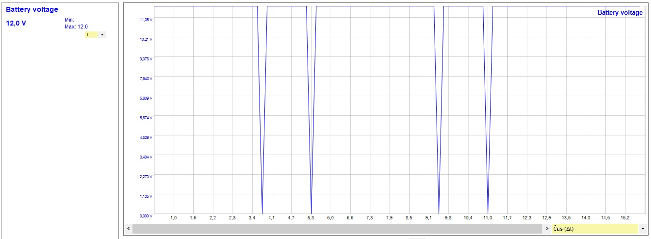

In the meantime, I've researched the problem a bit and here's how it goes.
When I connect to the engine ECU and let multiecuscan graph the battery voltage read from the engine ECU, I get a straight line of 12.68V.
I connect to the robot's ECU and have the battery voltage plotted again. I will get this
As you can see, the voltage is only 12.0V (wrong, the battery was about 12.68V, the temperature was -2C) and the graph shows clearly visible blackouts. The same outages are visible even if I let the hydraulic fluid pressure from this unit be plotted.
My plan is to get to the ECU, measure the voltage on the power pins1 GND and 27 KL30 Supply, if I measure 12V there will be a problem in the cables, if 12.68V I disassemble the ECU.
I don't have a better plan.

Thanks, I'll look into it. I deduced the CAN bus error from the communication failures and from the P0856 error, which appeared twice.
Error on the CAN bus, but does not explain why the battery voltage measurement in the robot ECU shows 0.68V less than the reality and than the engine ECU correctly shows.
Plus, I remind you, outages in CAN bus communication are only when communicating with the robot ECU and not when communicating with the engine ECU. if at all it is a communication failure and not a measurement failure inside the ECU.
From the above I would say.
- the problem is either a bad ground or power line to the robot ECU, that's why the ECU only measures the battery voltage at 12.0V instead of the correct 12.68V.
* The second possibility is a faulty capacitor in the power supply inside the robot's ECU. If there is an electrolytic capacitor it could have lost capacity or has a high ESR, if there is a tantalum capacitor it could have broken and it has a cold junction.

If the control unit is reporting 12.0 volts rather than 12.8, this could be a sign that there is a little bit too much resistance in the supply wiring, for example a fuse/fuse holder which is tarnished. I don't know what the current drain of the control unit is, but it may vary quite a lot depending on what it is doing. If it suddenly tries to draw more current (for example to operate a solenoid) this could cause sudden extra voltage drop in the supply line, and the 12.0 will dip down even further.
I suggest you double check the supply voltages going into the ECU, ideally with an oscilloscope so that you can see any short-term changes or dips. It may be that the reported error is fundamentally being caused by a DC supply voltage issue rather than anything related to the electronics. For completeness, check that the two ground connections are all OK.
