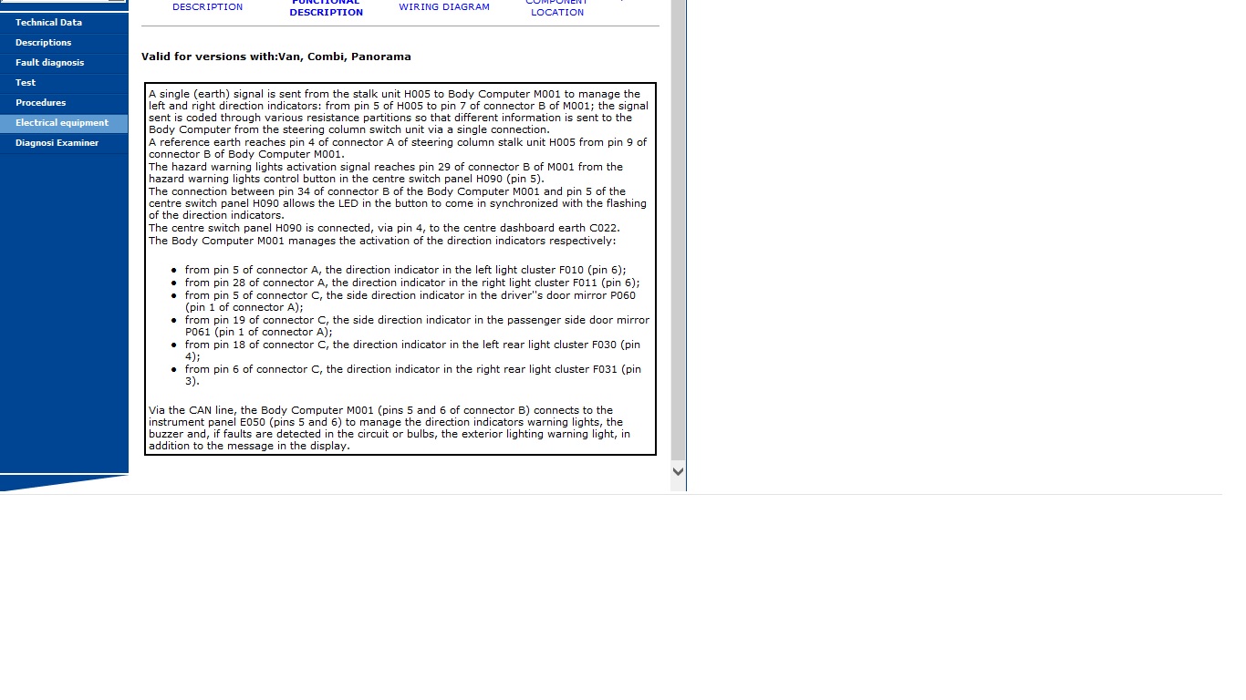

is it an X250 variant? If so the indicators are controlled by the Body Control Module. I have attached the functional description.
Thank you RayC, I will read and digest.

He Alan,, yours will be an X244 then , (2.8JTD) I have an 05 one under my Bustner. There are manuals to download on here, (eLearn) and these should have wiring diags in them,,,,,I say should, but you know, some bits ain't there.LOL. There wil be someone here who will assist very soon, this a good forum, I have found it is one of the best, and, the regular helpers in the Ducato section, contains a high proportion of Fiat trained blokes, AFAIK. Sit tight.........
I just re downloaded the eLearn disc image files,, it seems part 5 is corrupt, I have always had trouble with these files on download, and it is not simple to install and get working. You need to be adept at using a virtual CD drive and working with .iso images, its a faff, but doable.
F01, F37,F53 are mentioned in manual,, the wiring diag. is missing from my download! Several descriptions of the circuit are there tho'.
The locations of the various connectors is not stated which doesn't help. Typical.
