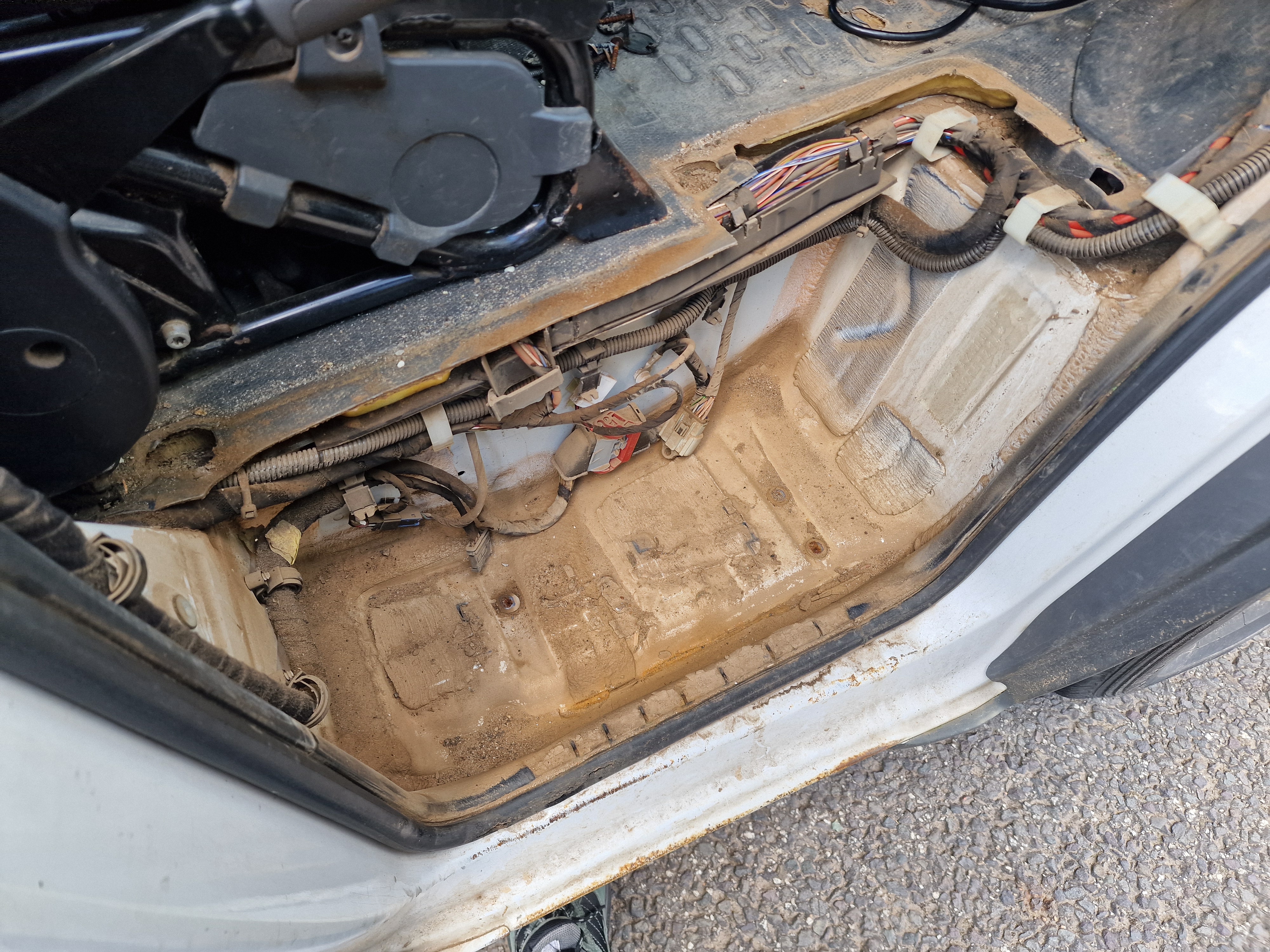

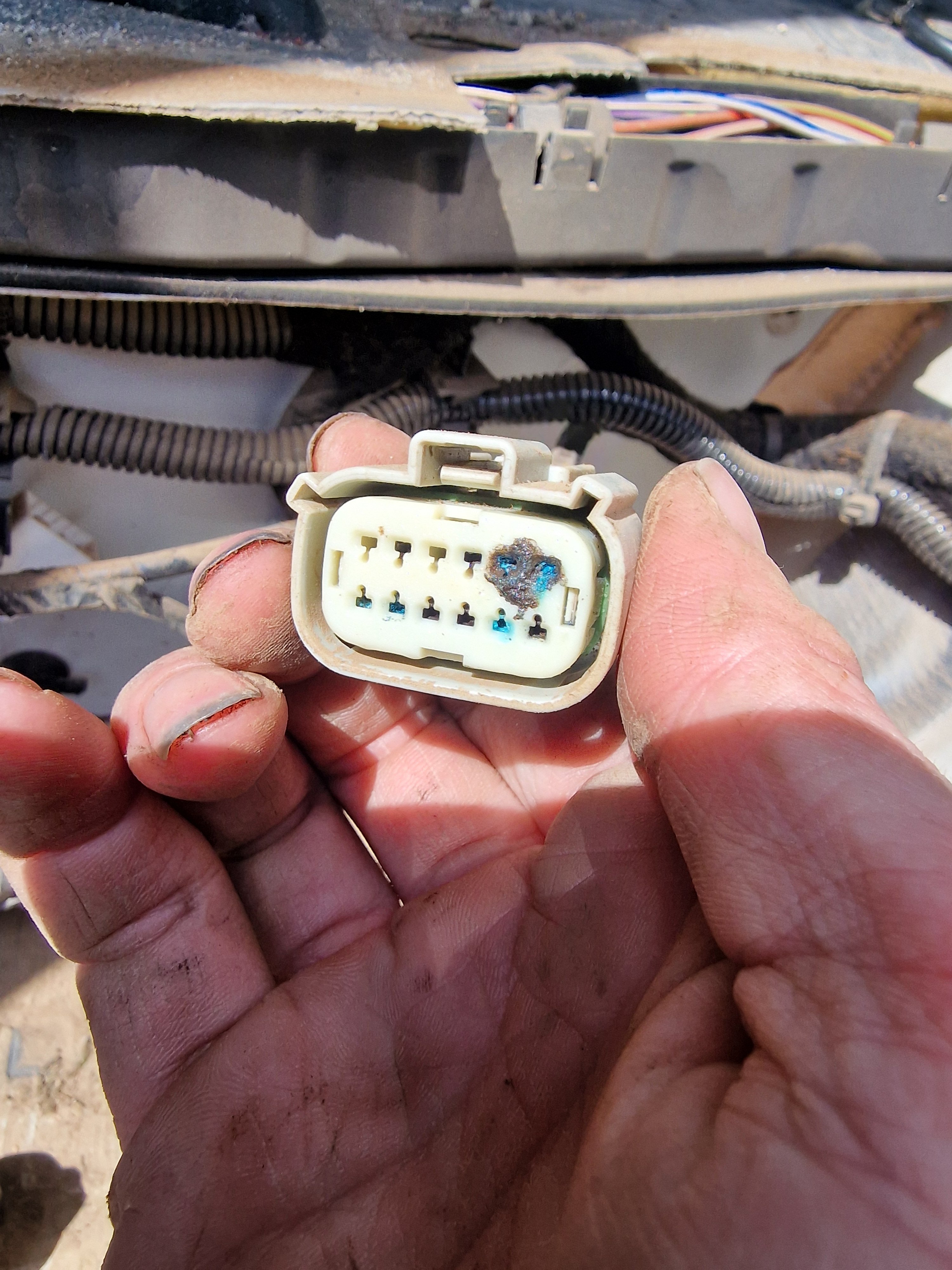

So after a long long time of searching, we found the cause of our electrical gremlins. It was a spare plug with a cap full of water in the footwell. Power and return feed had created their own connection through electrolysis, which gave variable voltage, but just enough to make the bcm think it was getting a wake-up signal. Cleaned up and all good now.

Hats off to you for finding the fault, amazing
