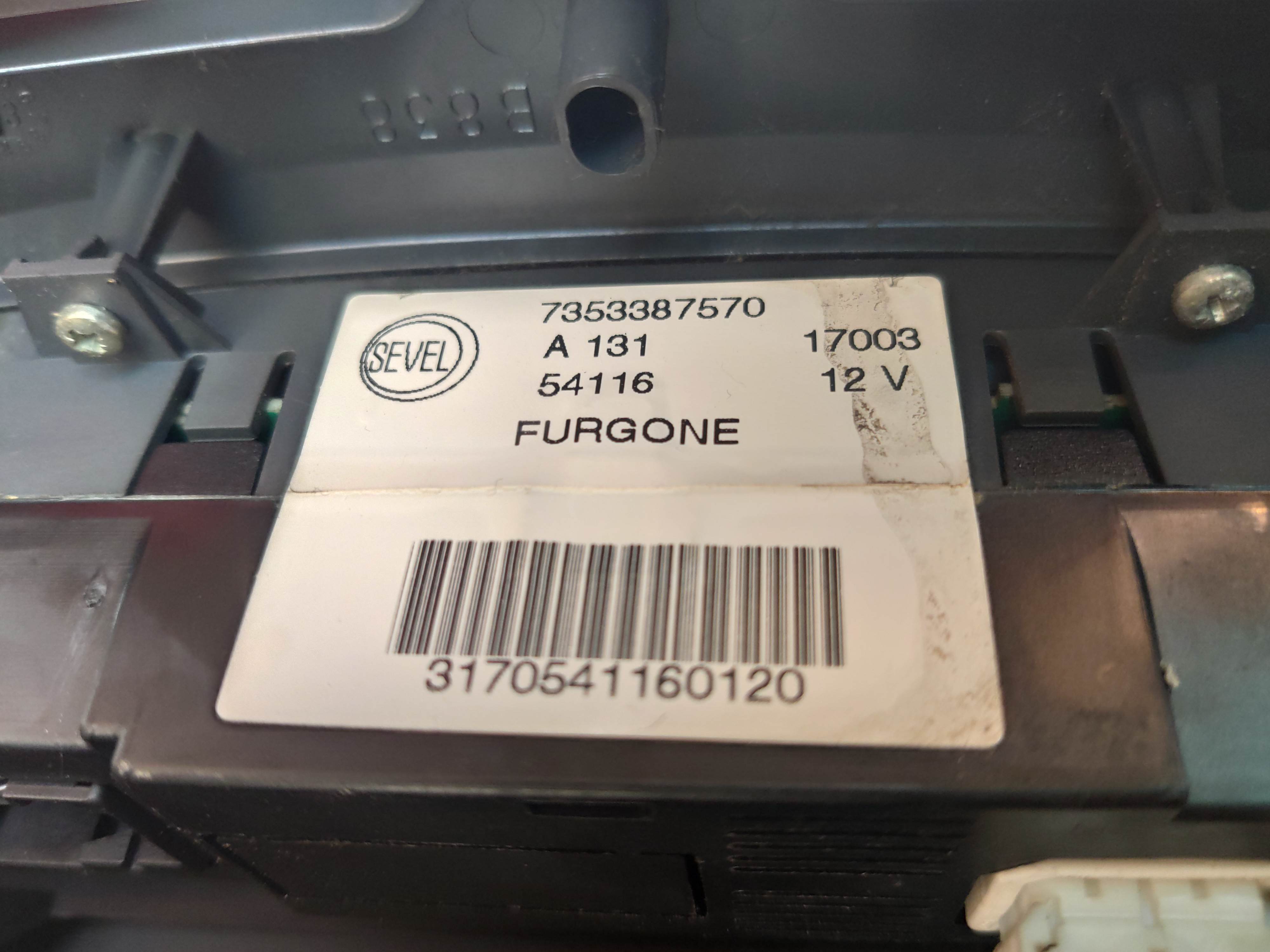

It seems to me that H090 is bad, I have disassembled it and I can see there are relays in there, but this is probably where it ends for me.
If I want to get replacement do I need exactly same number ?
Because I can not find anywhere on used parts sales , part with number "17003" ?
Or any other number will work without reprogramming ? Because I do not have any way to reprogram ECU , then I will probably make bypass with switch between pins 3 and 1,2 on connector B

A very interesting post. I have never looked inside the unit, as I have not had the need. Can you post a photo of the H090 internals?
On reading the testing carried out, I cannot see mention of 0V at pin 17 connector D. However this is dipped beam command, so perhaps you confirmed that dipped beams were on?
For part number I think that you should be searching with "Fiat 7353387570". This brings several results on ebay.co.uk, however price asked is about 100 GBP used. However the search results were for 7353387550, but did specify 2002 - 2006.
I do not think that the units can be programmed, just hard wired logic. It seems from my ebay search that there is some variation in part numbers. I am not aware of any wiring differences for x244 models (2002 - 2006), except for when options are fitted, so perhaps these different part numbers indicate design changes.
Looking at the printed part number (7353387570) this is not searchable on ePer, and I suspect it is the generic number for the fascia/surround.
What ePer does show is a different number for each combination of controls set within that fascia (i.e. a part number which consists of the fascia and the desired controls/indicators).
The following is an example; there are other listings for different base vehicle variants (though I suspect the correct selection would fit different variants).
The E0nn options are the included functions, and can be checked by hovering over the "i" Icon for each part.
You would need to search for the part with the desired/currently fitted functions included.
