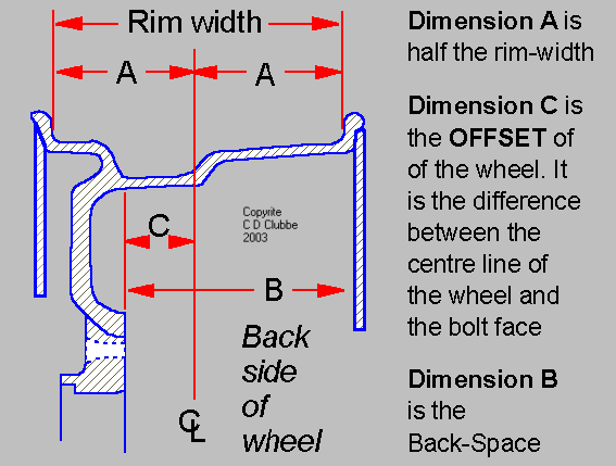

Hi.
I am looking for some wheels that would fit a 2009 Ducato Van. I know so far that they are 6 inch by 16 inch rims with six studs. Tyres are 225 74 R16. However I am not sure of the offset for the wheels. New Fiat part for wheels is 1346940080 but I cannot find further specs to make sure the new wheels i find will fit. I think that all 6 stud patters are the same and that the seating will be 60 degree cone seating so I think that all I need to know is the offset which looks like being positive with respect to the centre line of the wheel but I am not sure how many millimeters. Does anyone know such a thing or can suggest where to find this out???

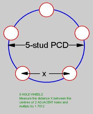

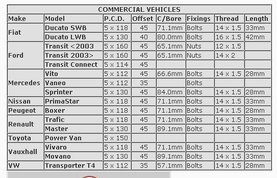

I have found out that:
Fiat Ducato wheels are 6 x 16 inch 5 stud with a PCD of 130mm and ET of 56mm. Cenral bor is 78mm so Mercedes Sprinter (PCD 130 ET 45mm) and VW Crafter wheels (PCD 130mm) should also fit the Ducato Van.
