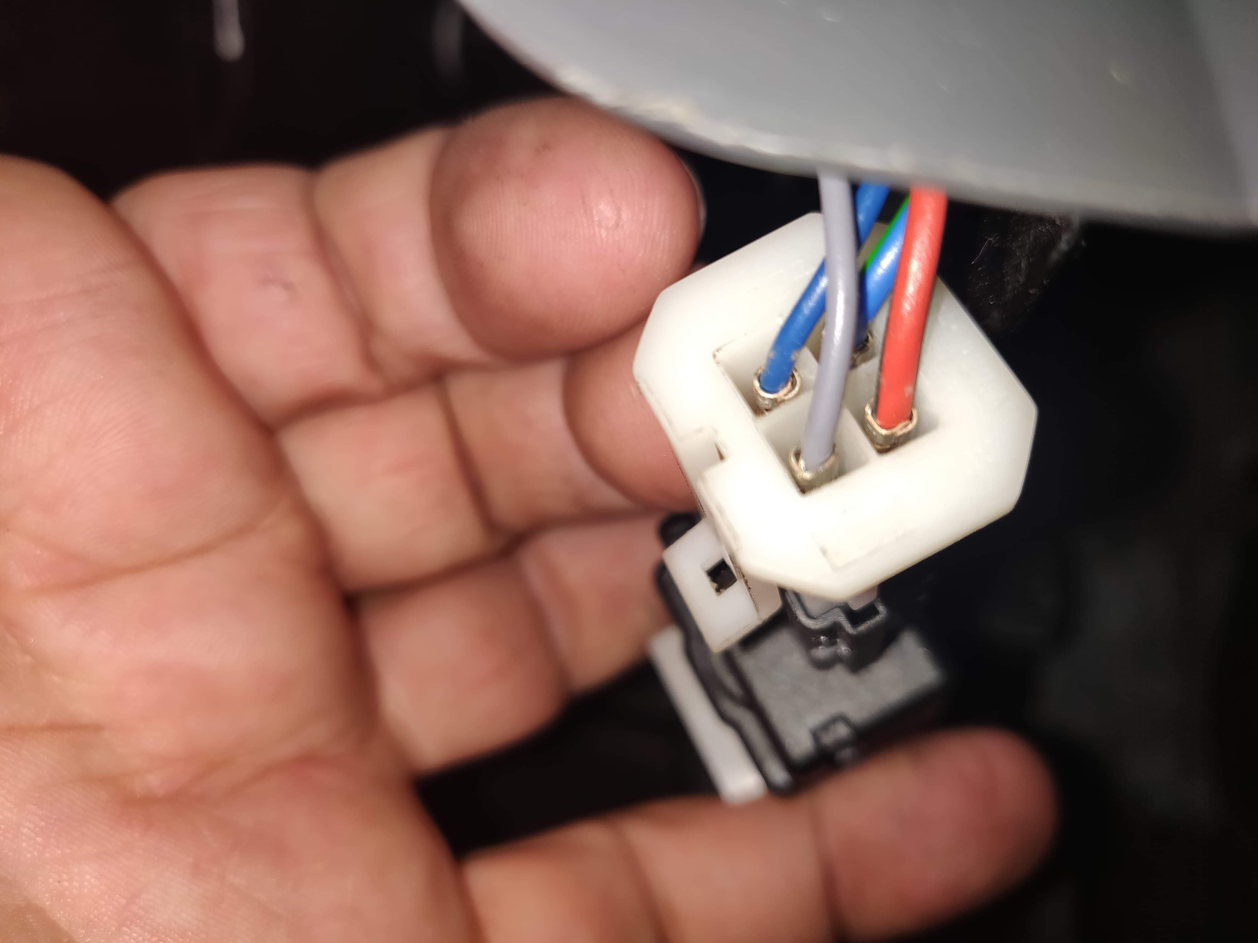

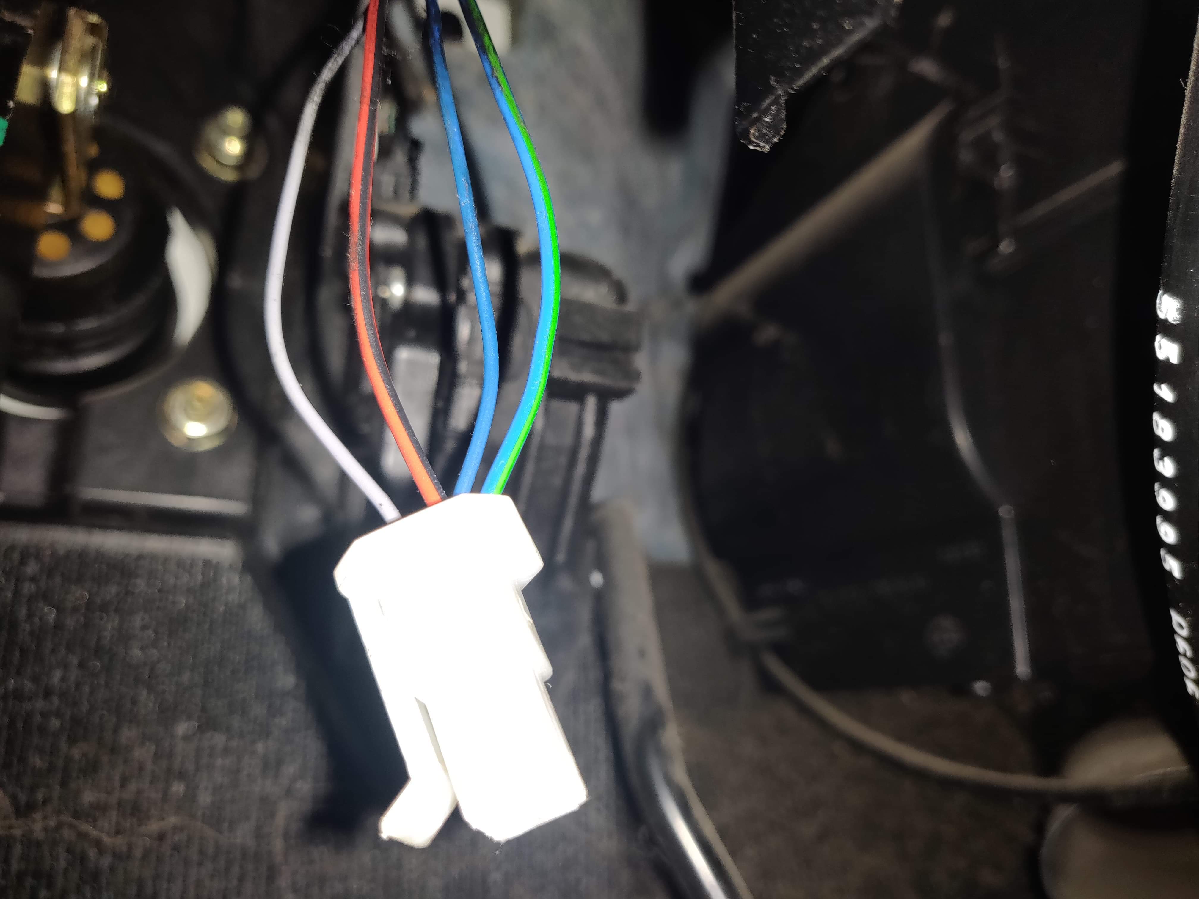

I’m assisting a fellow Ducato owner with his cruise control install. He has a 2.8 JTD from 2006. The cable to his brake light switch is different to mine, in that the colours are different and there is no intermediate connector to facilitate removing the cable for easy splicing with the Yellow stalk cable. We have connected the correct stalk cables to D018 and the Yellow to pins 3&4 of the BLS, but cruise control doesn’t appear to work.

After careful inspection, the colours seem similar to me.
Judging from the insulation crimping in the first photo, it is possible that previous work may have been done here.

Communicator, thanks again for your information and advice. As I said before, I'm assisting a friend remotely with this installation. I'm pleased to say he has successfully installed it. I still don't fully understand why, but connecting the Yellow stalk wire to pins 2 & 3 on the BLS made it fully operational. There was no power to the Yellow wire when connected to 3 & 4 of the BLS.

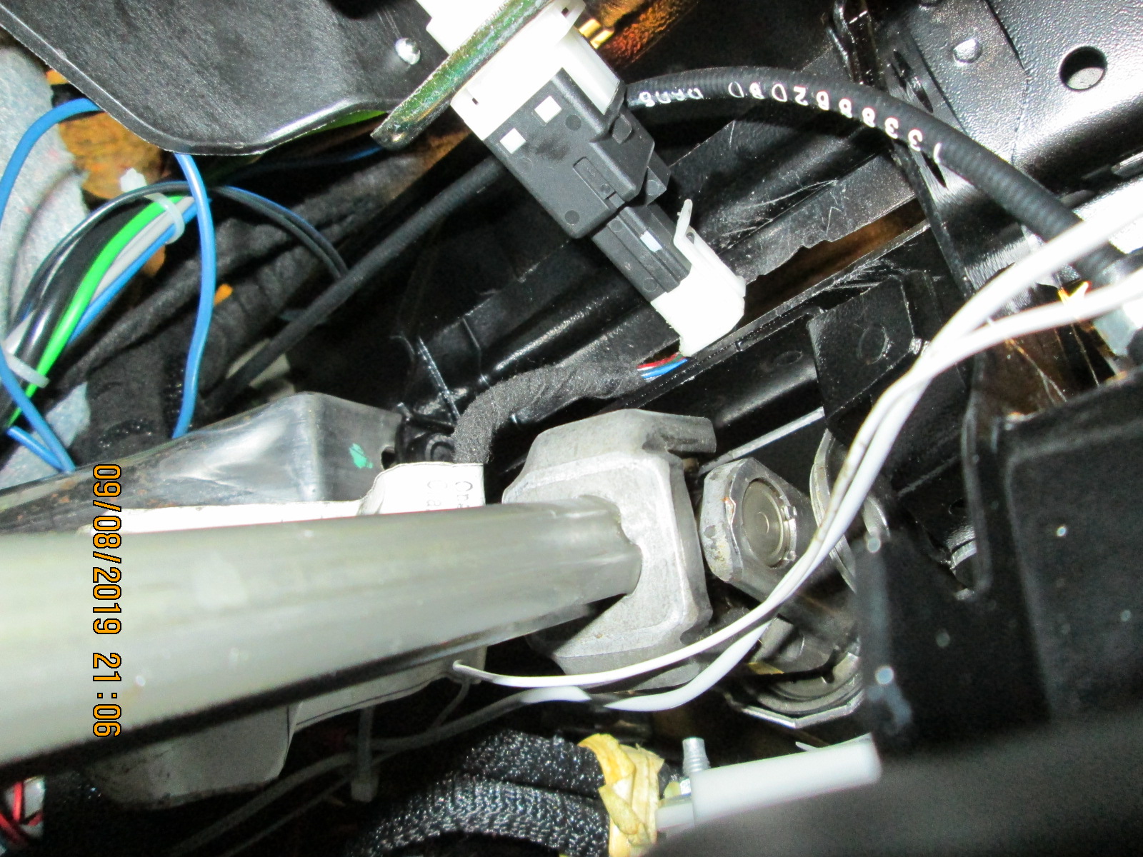

Have your changed the brake pedal (light) switch? You need the black and white two contact switch.

Hi thank you for reply. Yes we put 4 pin break light switch and, connect 2 blue (one is, blue with green) connected together.
