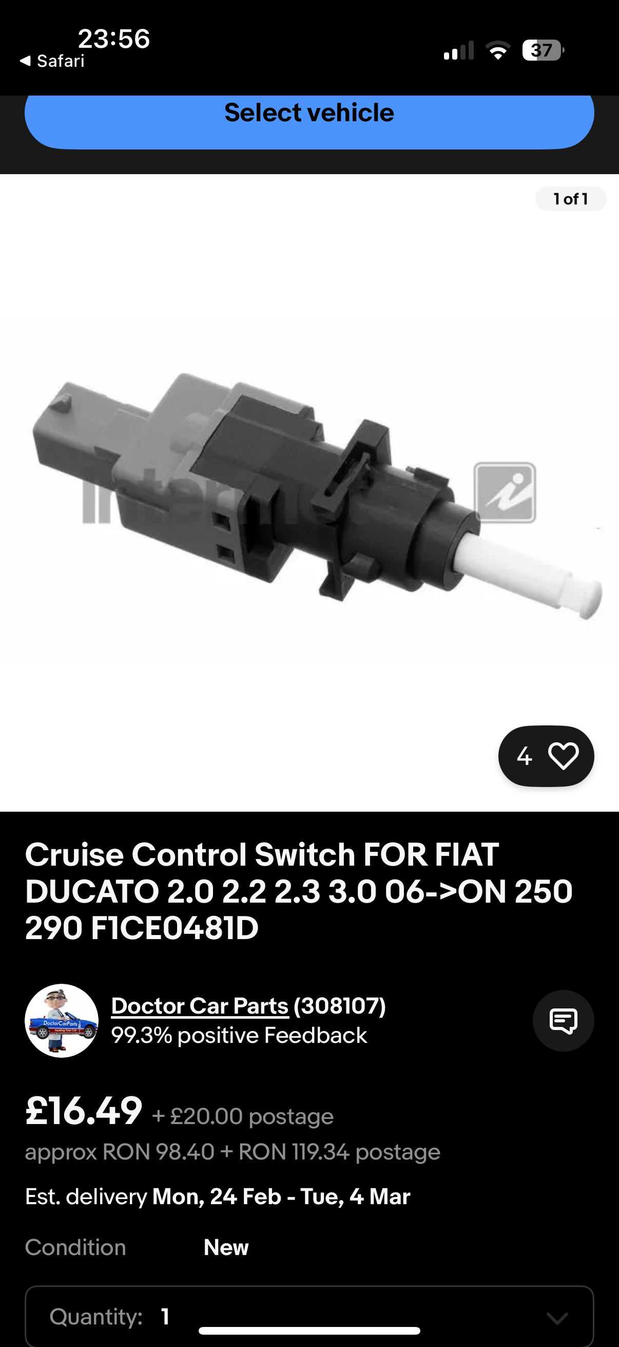

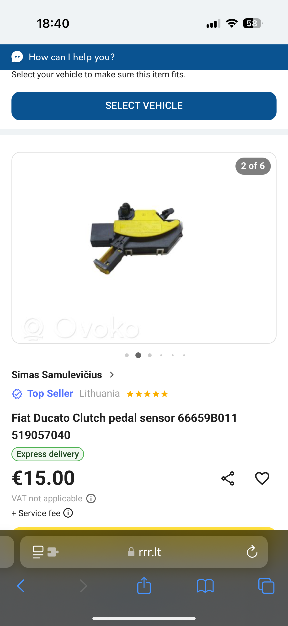

Hy everyone. l've converted a right-hand drive Fiat Ducato 2.3 2016 multijet to a left-hand drive. The left-hand drive donor dashboard had cruise control, but mine didn't. The main issue is that my clutch sensor is a potentiometer, while the “new” pedals' sensor is a button.
I attach the two type of sensors what is in my car now. I don’t know how to connect the wires from the potentiometer to the cruise control switch
Does anyone have any ideas on how I can get the cruise control to work?

Hello,
I'm afraid that it won't work.
You'll most probably need to change the switch.
Attached the cruise control and diesel engines monitoring management eLearn docs for the 2,3 EUR5 model.
There are other docs mentionned, if you need one of these for further analysis let us know.
