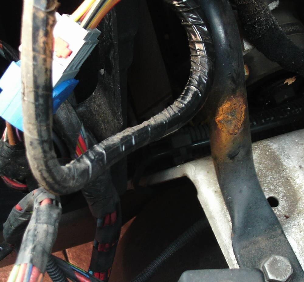

1. The X250 can suffer from the so called "rusty junction syndrome. This occurs at a location under the LHS headlight when a cable form rubs against a tubular frame member. See photo supplied by Reg65
2 In a recent post concerning key code failure, a member reported problems with connector pins at the engine control unit.
See post #24.
