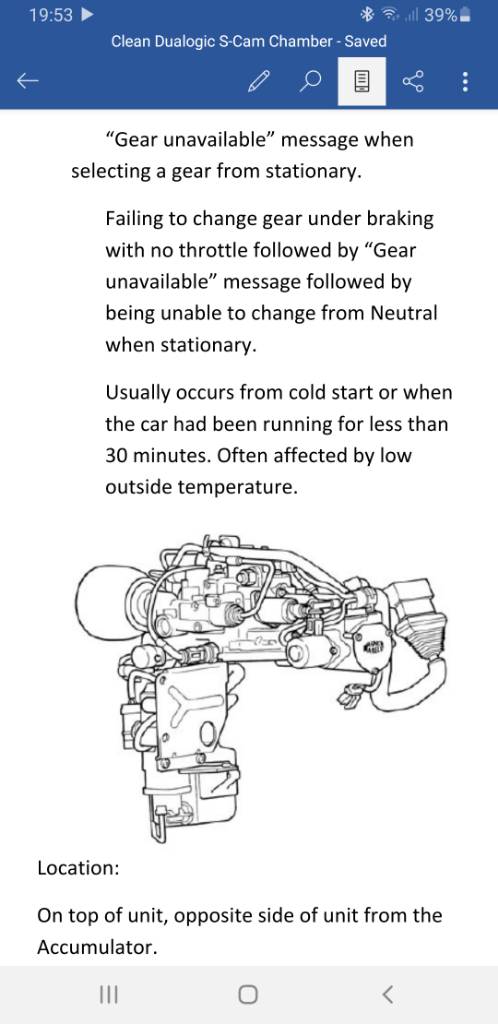

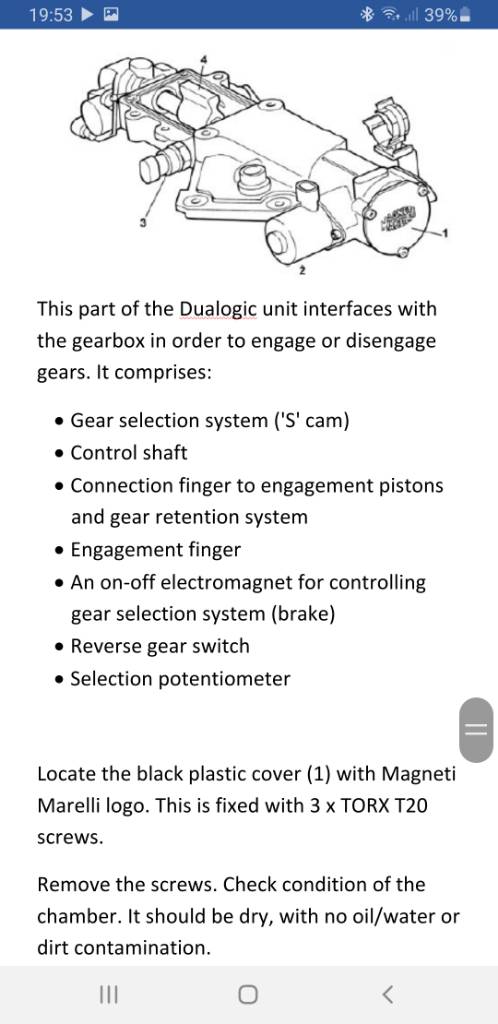

2... at the top rear of the unit is a black cover with 2 or 3 torx screws. This is the end cover for the "S-cam". It can get contaminated with water or other muck, and cause similar problems. There is a post somewhere on here about how to clean it out. I think it is in the GP section, and may have been written by forum user bencey, or perhaps burrowsdeano. Don't have a link to it available so you may have to search.

Will try and get a photo when I'm back at the workshop.
Attachments may help in the meantime. Screenshot_20210331-195338_Word.jpegScreenshot_20210331-195349_Word.jpeg

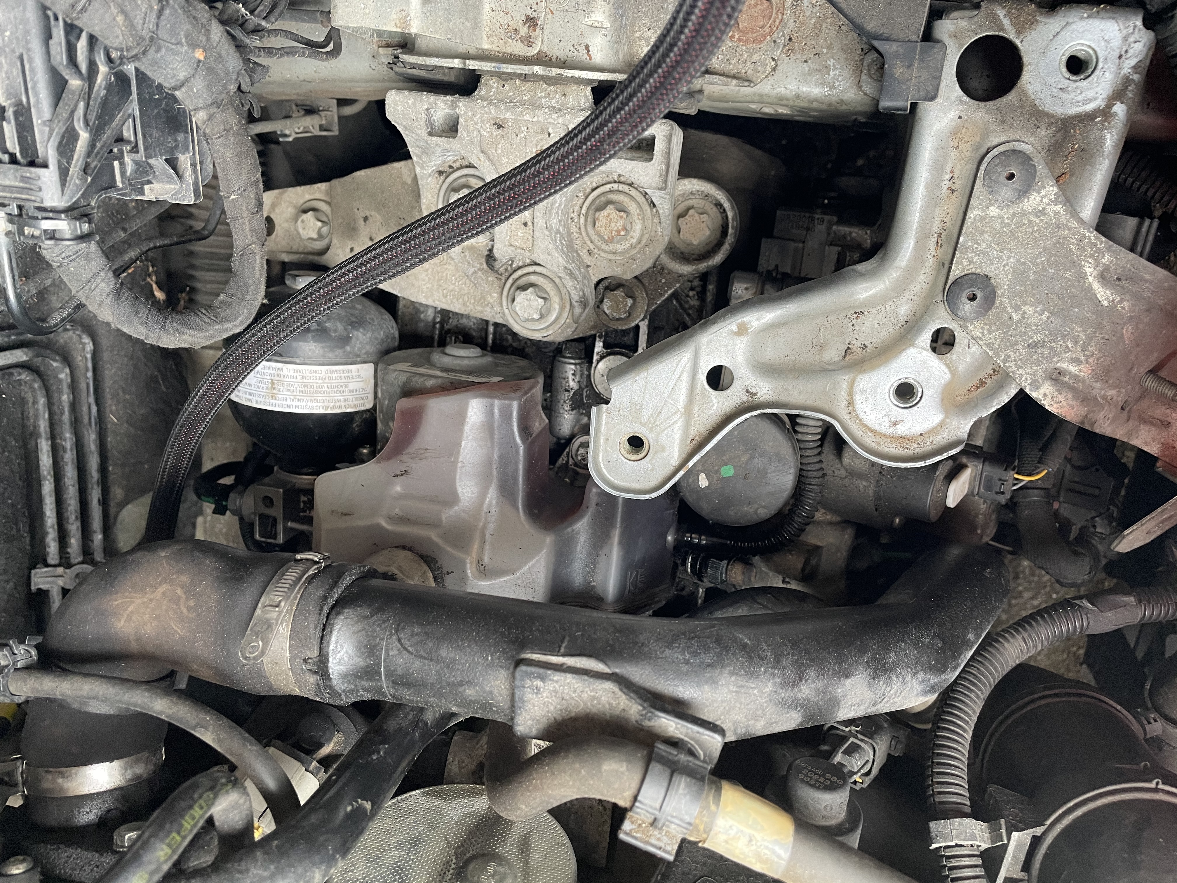

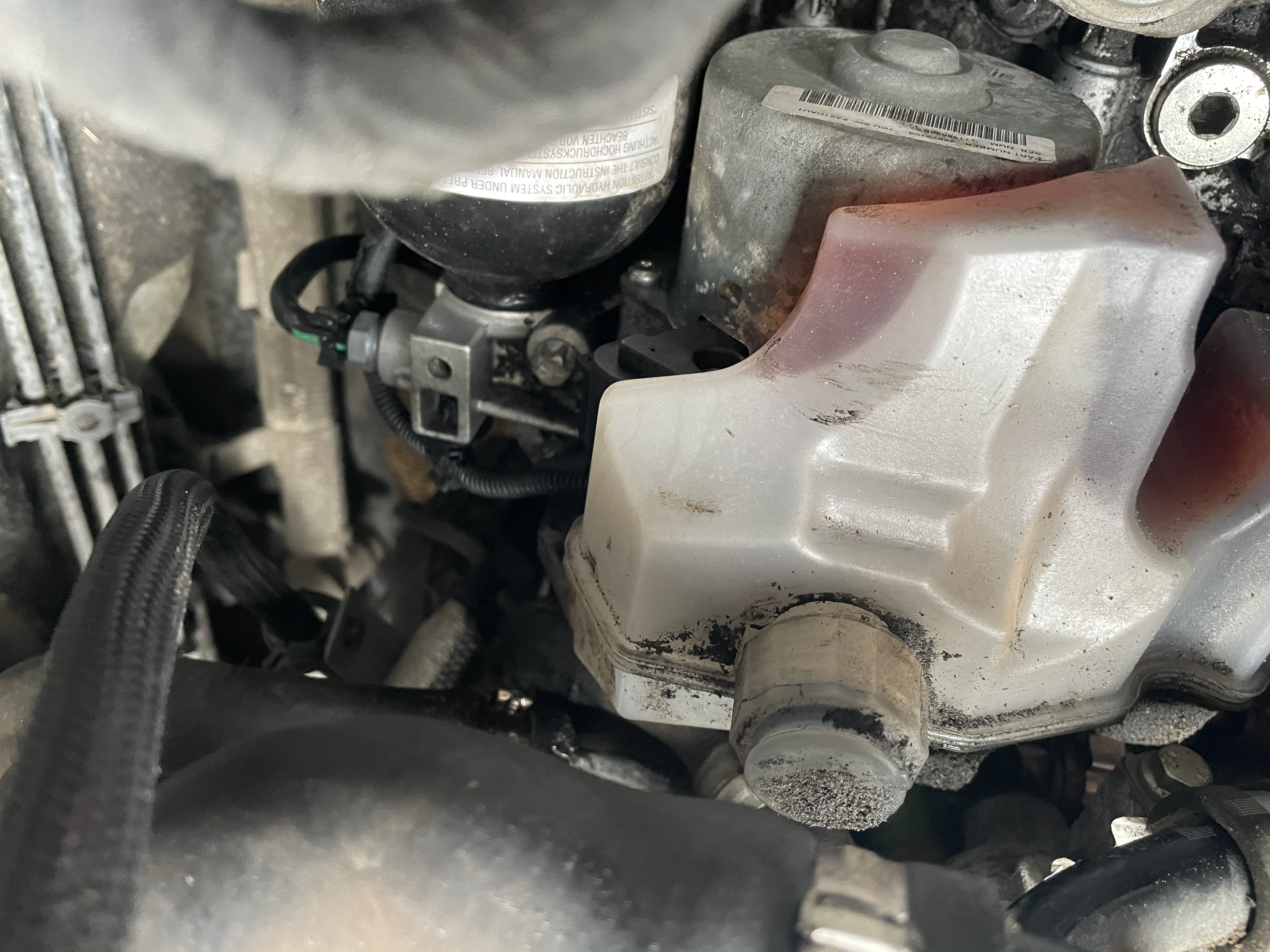

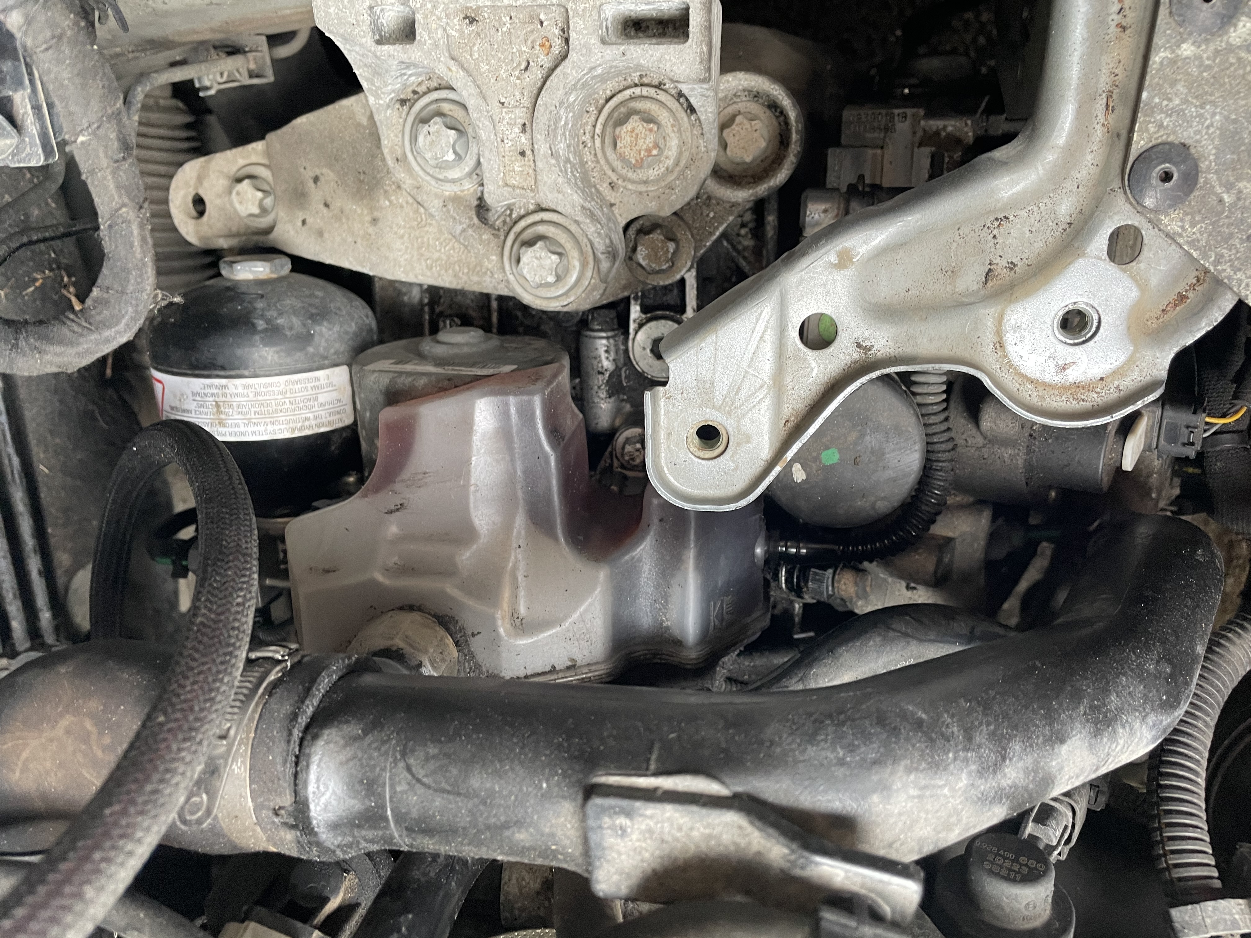

I think the unit looks different than the one I have on my car, from my understanding I have a CFC300 robot on my gearbox?
I’ve taken some pictures aswell to show you.
Thank you
