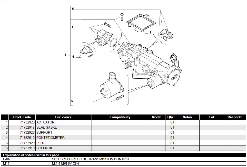

Hi would it be possible for you to send me part numbers of hydraulic o ring or seal for cfc328 clutch position piston seal please i think
Hi Paul, send me aPM so I can send you back the parts.pdf (4,5Mb)...
BR's, Bernie
Or maybe is it this you're looking for ?
BRs, Bernie
