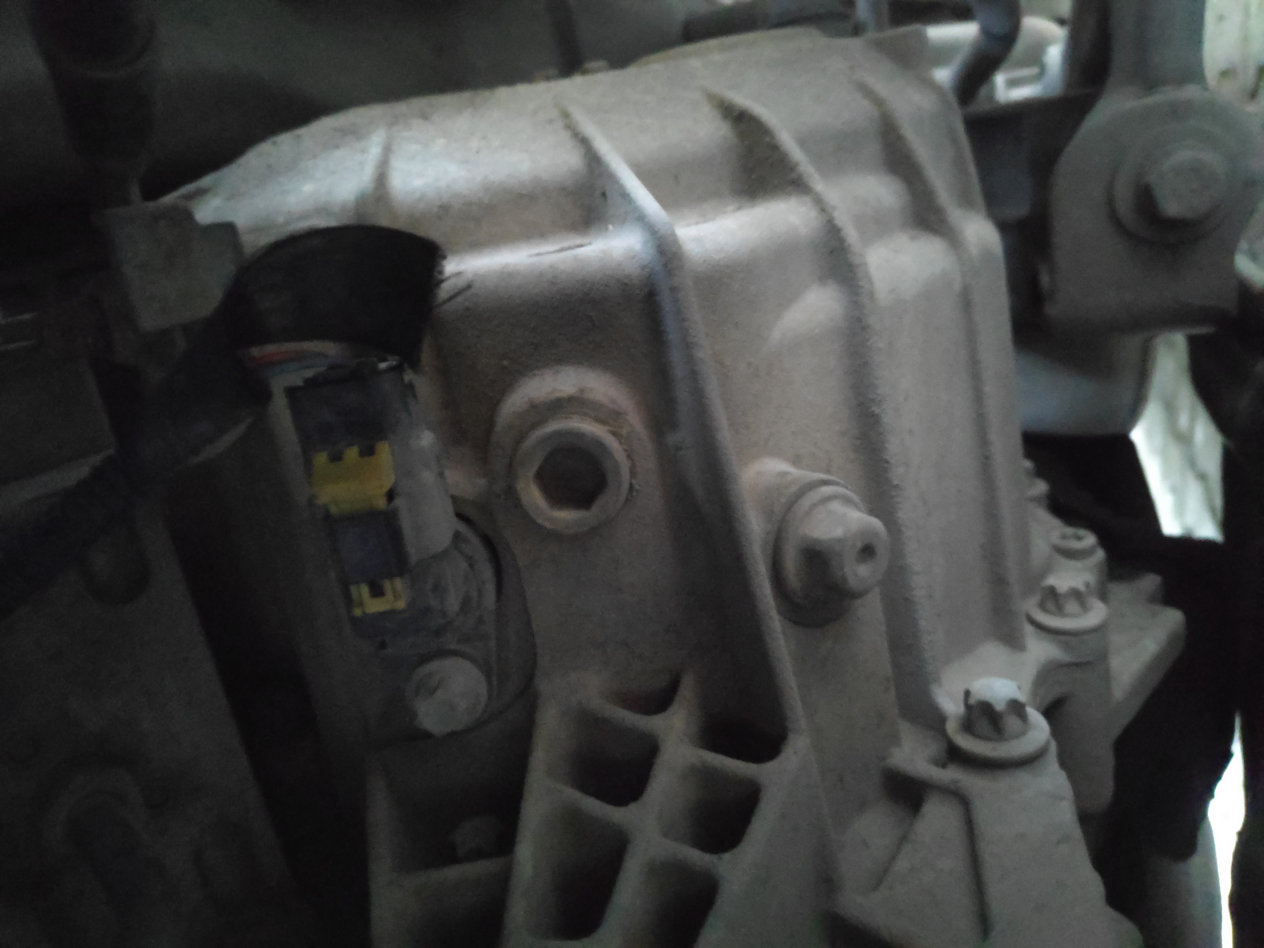

I've got a Qubo with the dualogic box and I want to check the gearbox oil level - wheres the fill stopper?

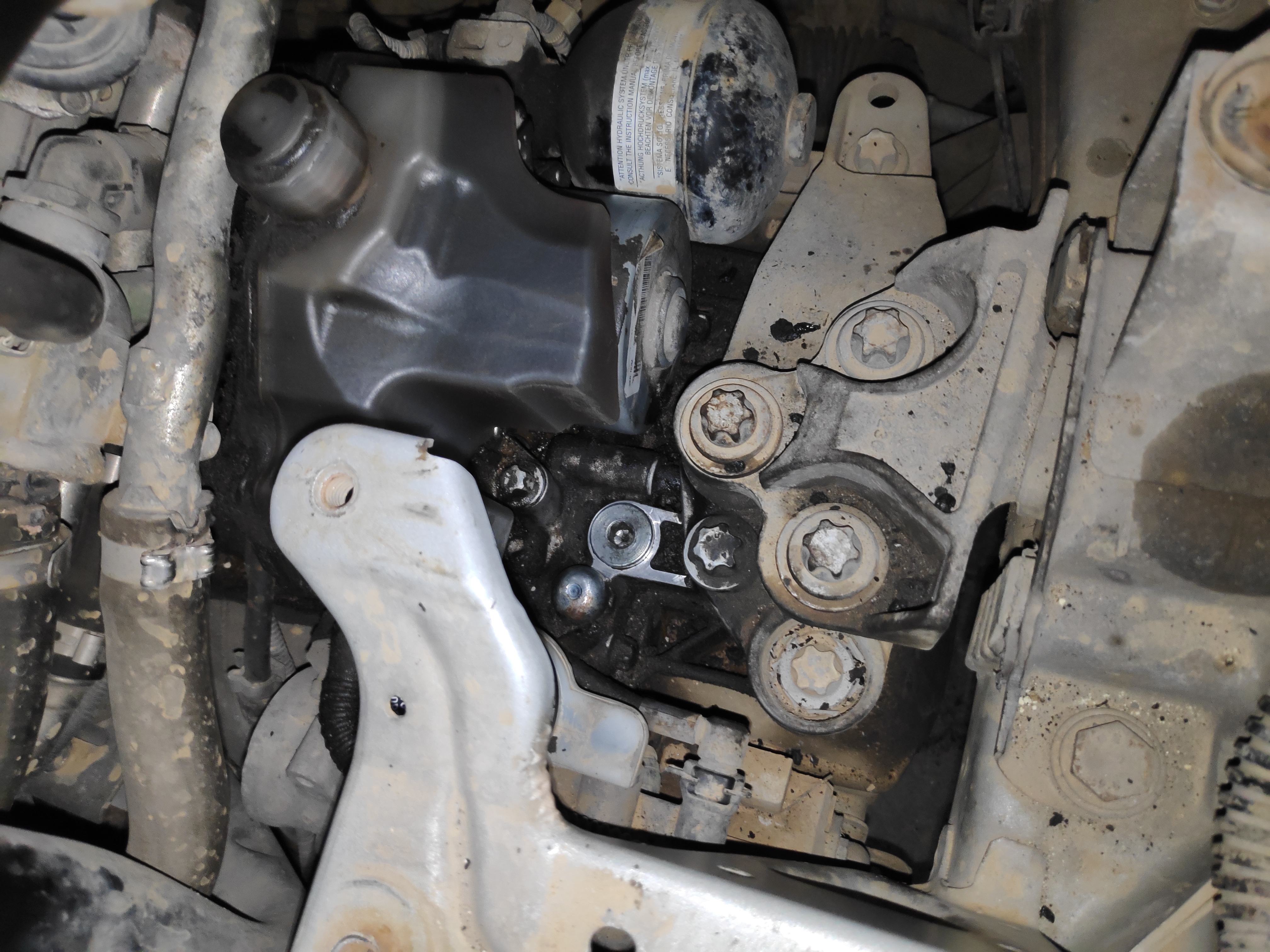

Acess to the Robots oil tank is probably a case of removing the 'baking tray'
If you take a few pics as you go through it thst would be great (y)

If wanting to mess with the Dualogic hydraulic fluid side of things then you'll need to have a registered version of MultiECUscan to calibrate and bleed the system as part of the process (y)
If you have the 6 speed M20 transmission, level plug is right below the shaft speed sensor facing to the front. The plug is 10mm hex if i'm not wrong. There is also a filler plug (8mm hex) on top of the transmission, under the battery tray. You can fill it up there easily and verticaly if you're not lazy enough to remove the battery tray.

For the hydraulics side; if you replace that oil, there is a chance that it can leak because the new clean oil will have a cleaning effect on the old seals. If that happens and the system loses pressure, you'll be stuck in Netural.
Change it when you are overhauling the dualogic unit and/or the transmission...
