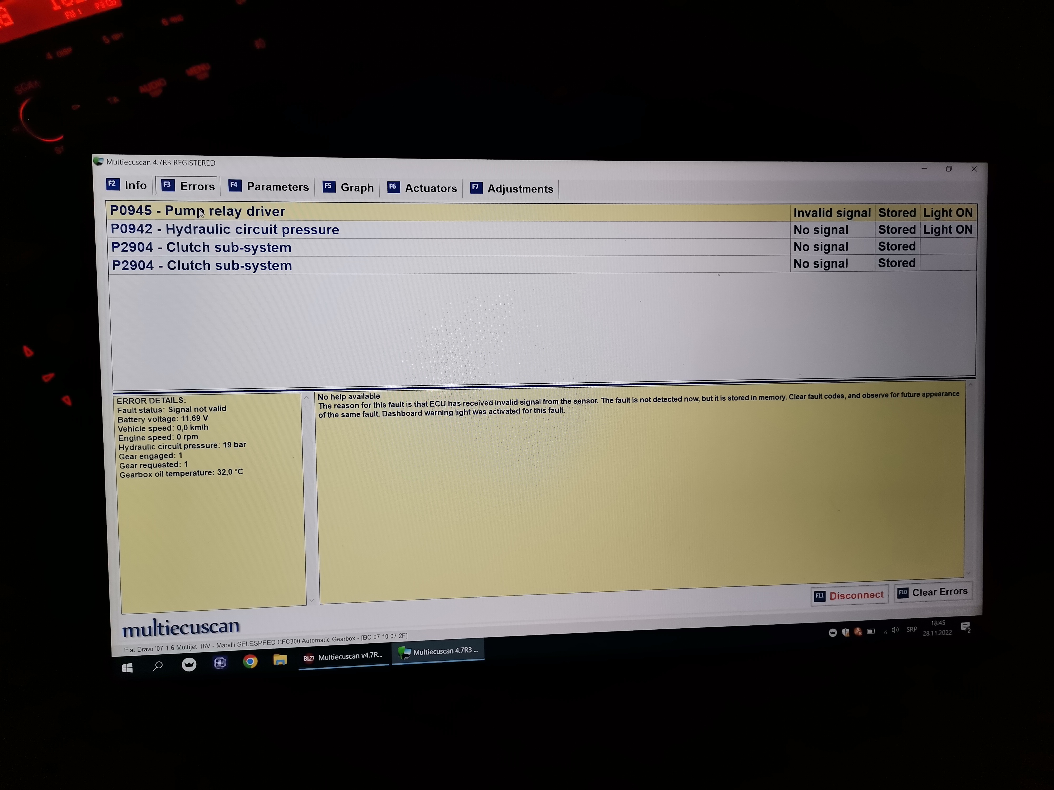

When I plugged in diagnostic I got errors
P0945 - pump relay driver
P0942 - hydrulic circuit preassure
P2904 - clutch sub-system

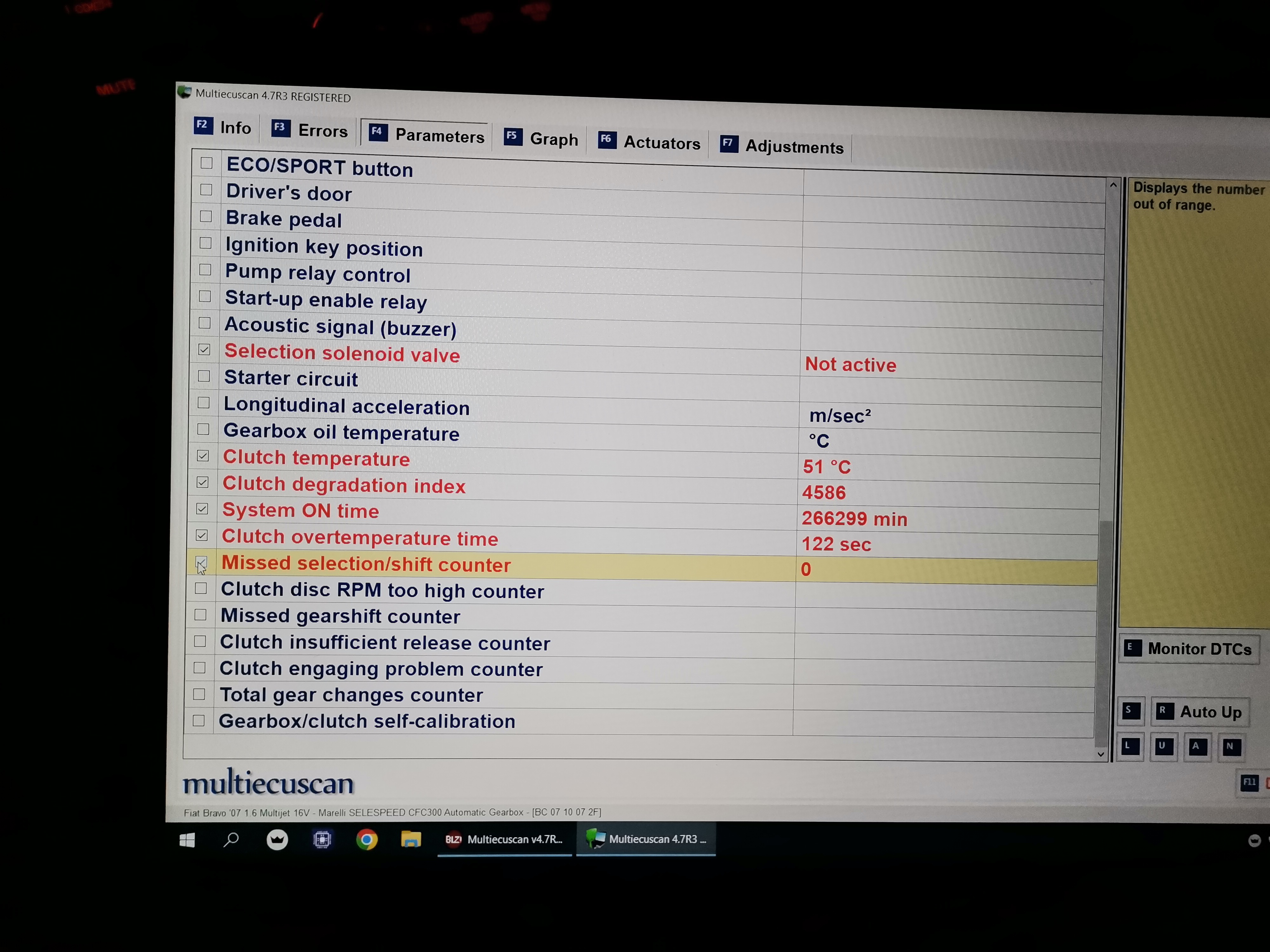

I think that problem is with the electromotor or some connections, because i checked on diagnostic some parameters, and I think that they were fine.

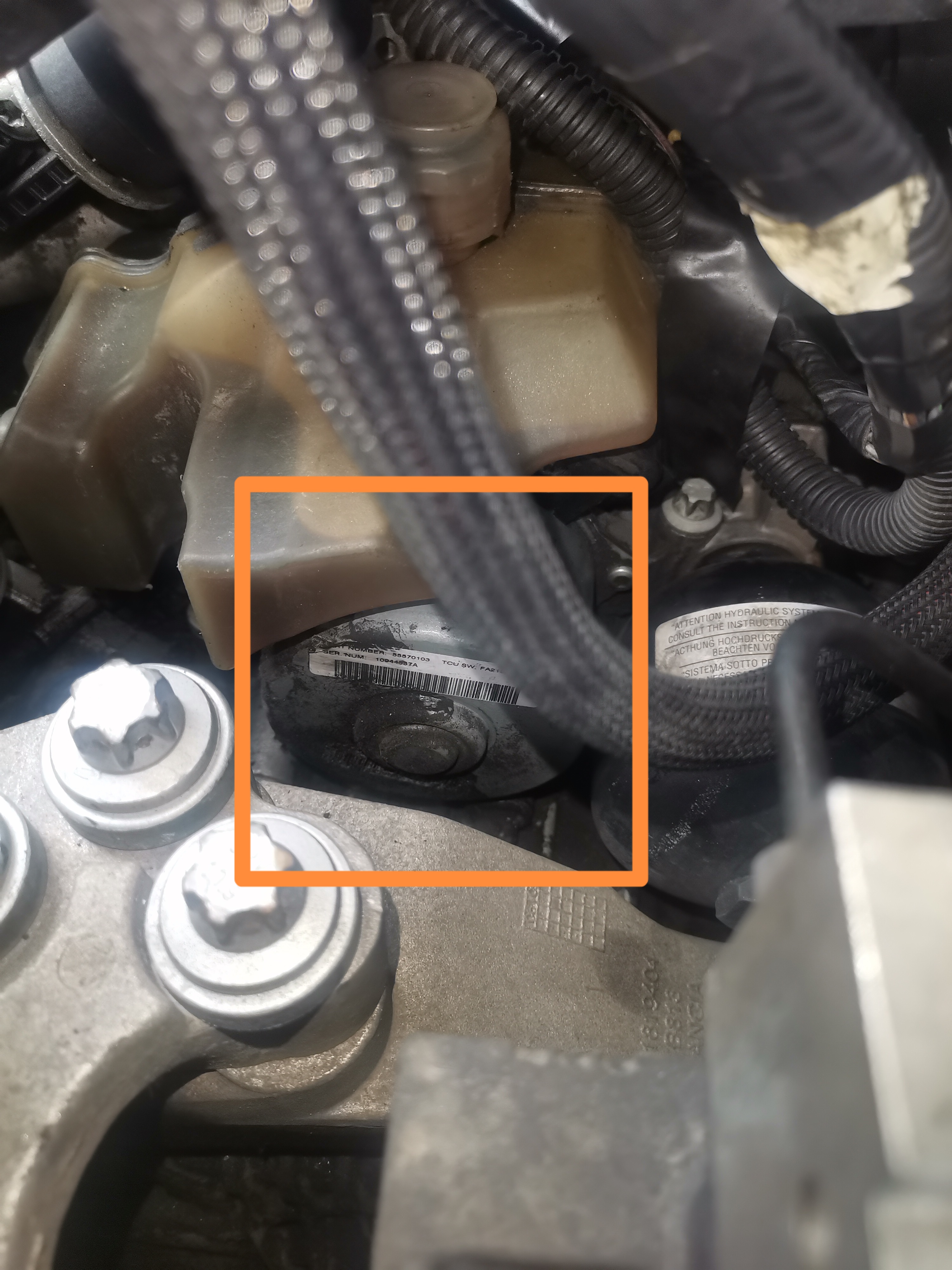

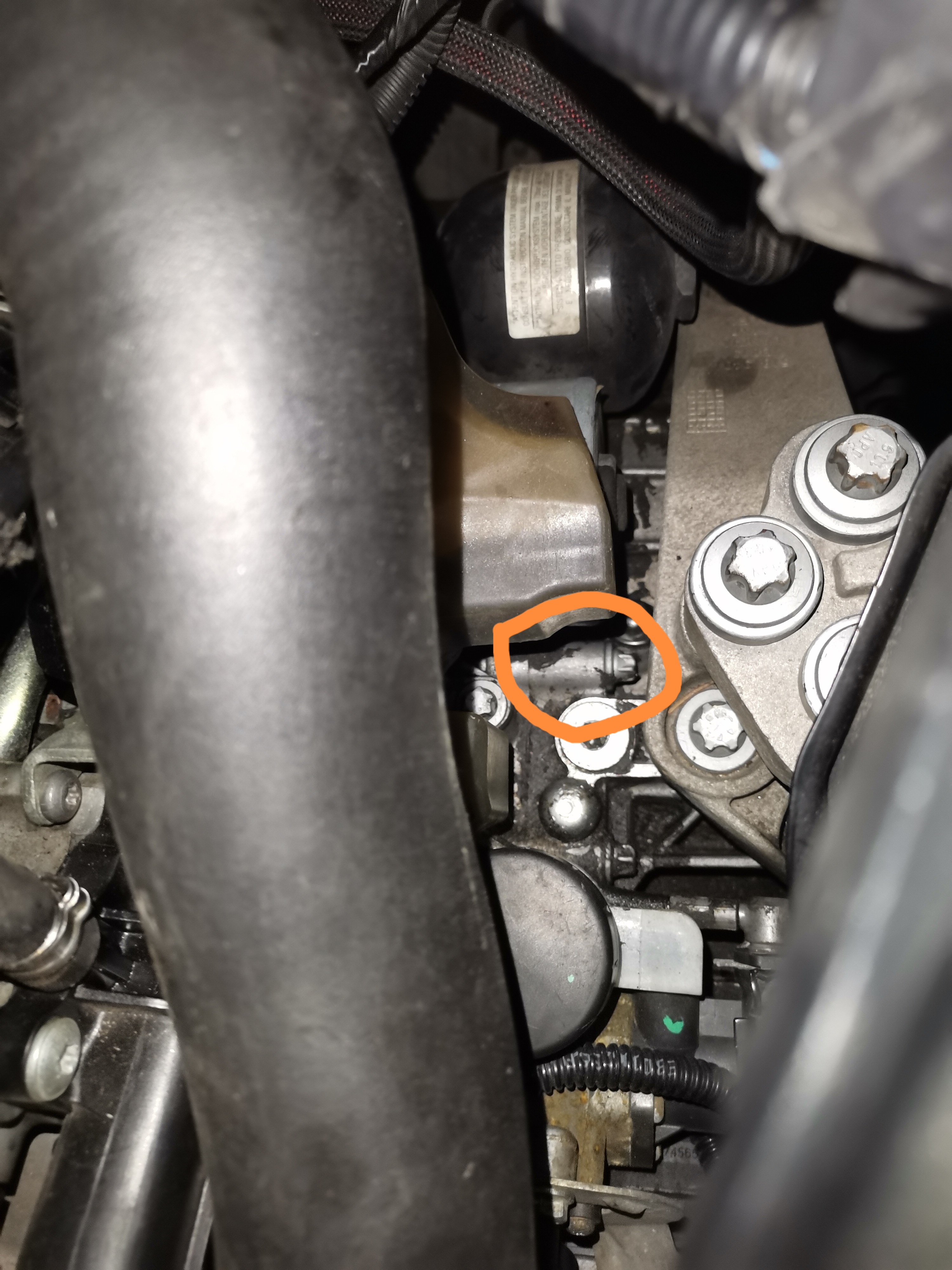

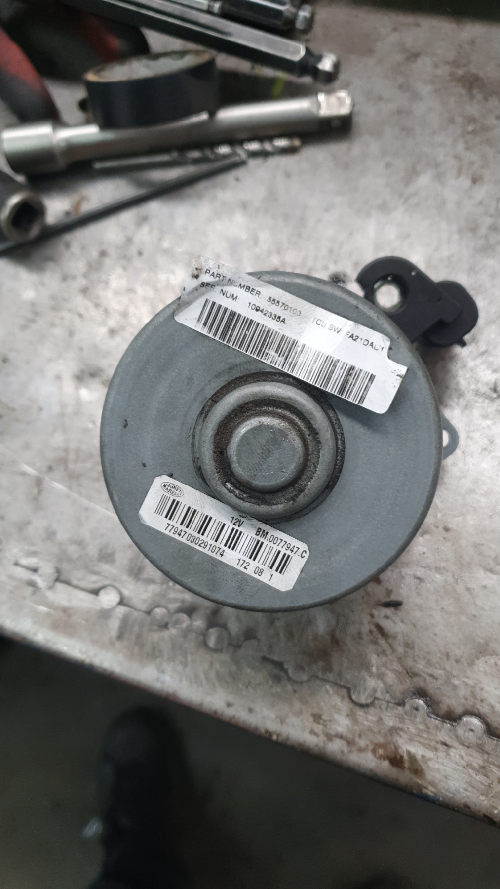

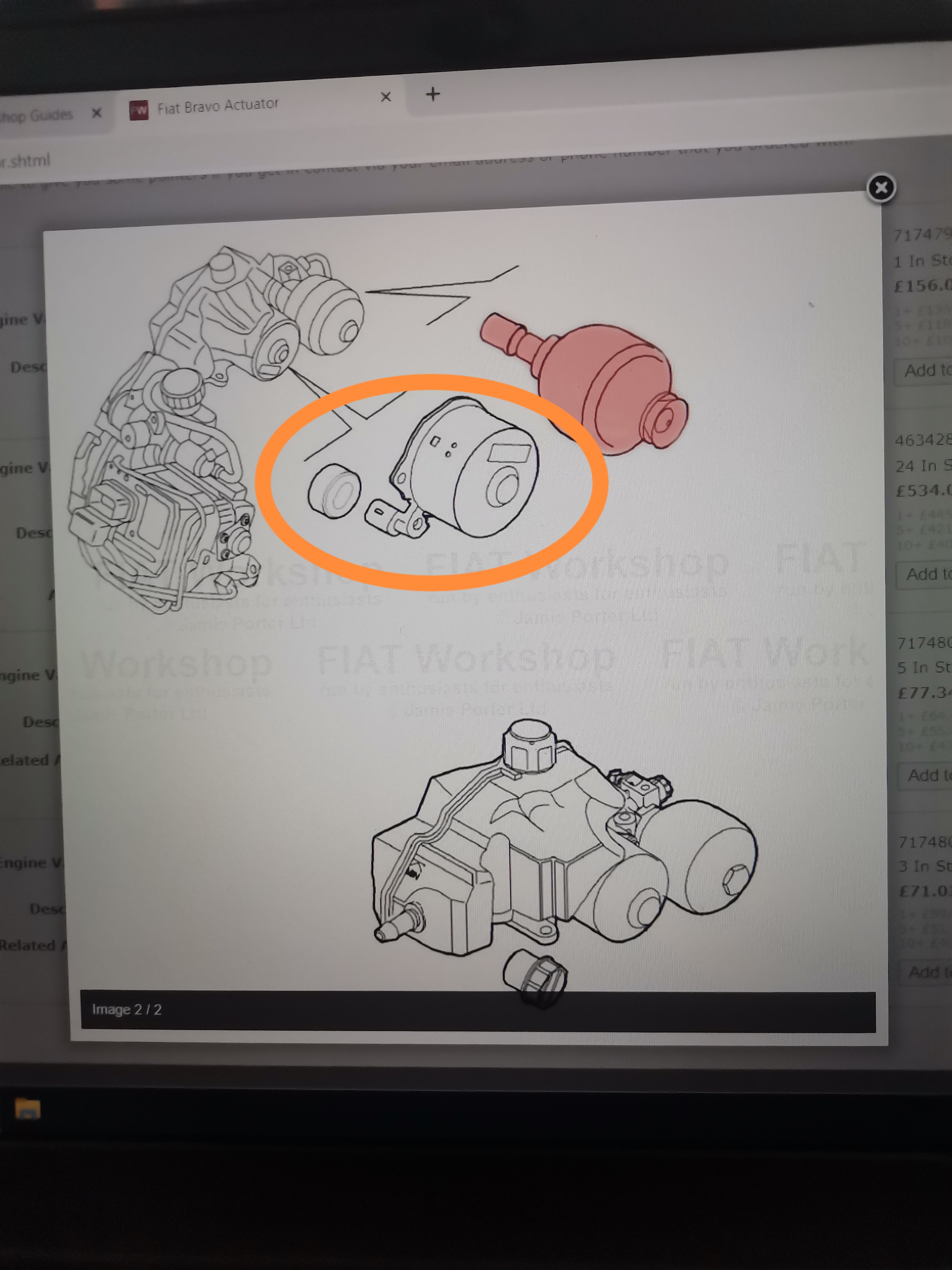

I have found that problem is in electric motor that powers the selespeed pump. I bought new motor, but i couldn't change it. Does anybody knows how can i replace the electric motor
