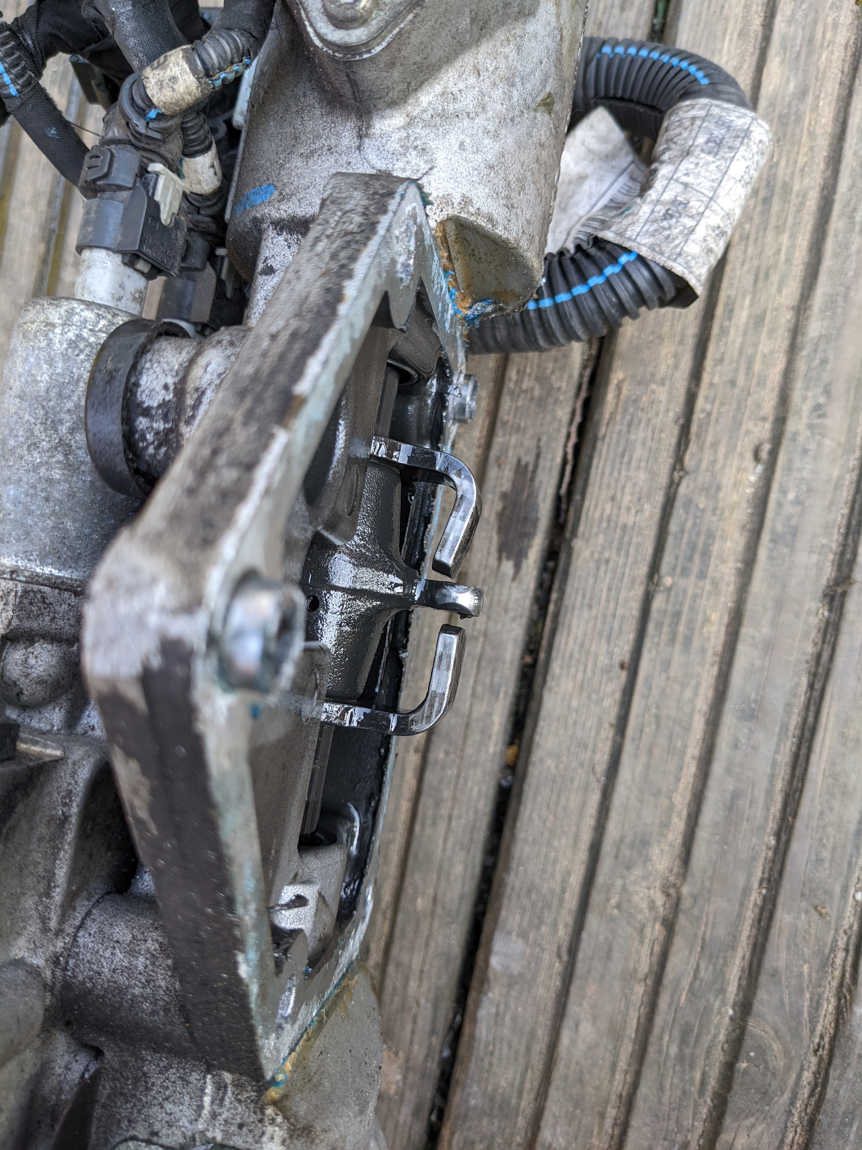

Today I took the dualogic robot off can found one of the two tabs bent inwards so this could of been causing the issue. Anyway I've now replaced the diff bearings on the old box, heated and bent back the tab and installed it all back into the car. It now changes gear beautifully after the carrying out all the software procedures.
Thanks for everyone's help

Still having problems anyone. Changed the sill kit on selespeed unit. Anyone one the clutch position sensor reading for in neutral and clutch position closed self tuning? And after driving for 2 miles clutch overheating over 290 degrees???? And where does it take reading for overheating see if I can change a sensor??? Any help Thanks
