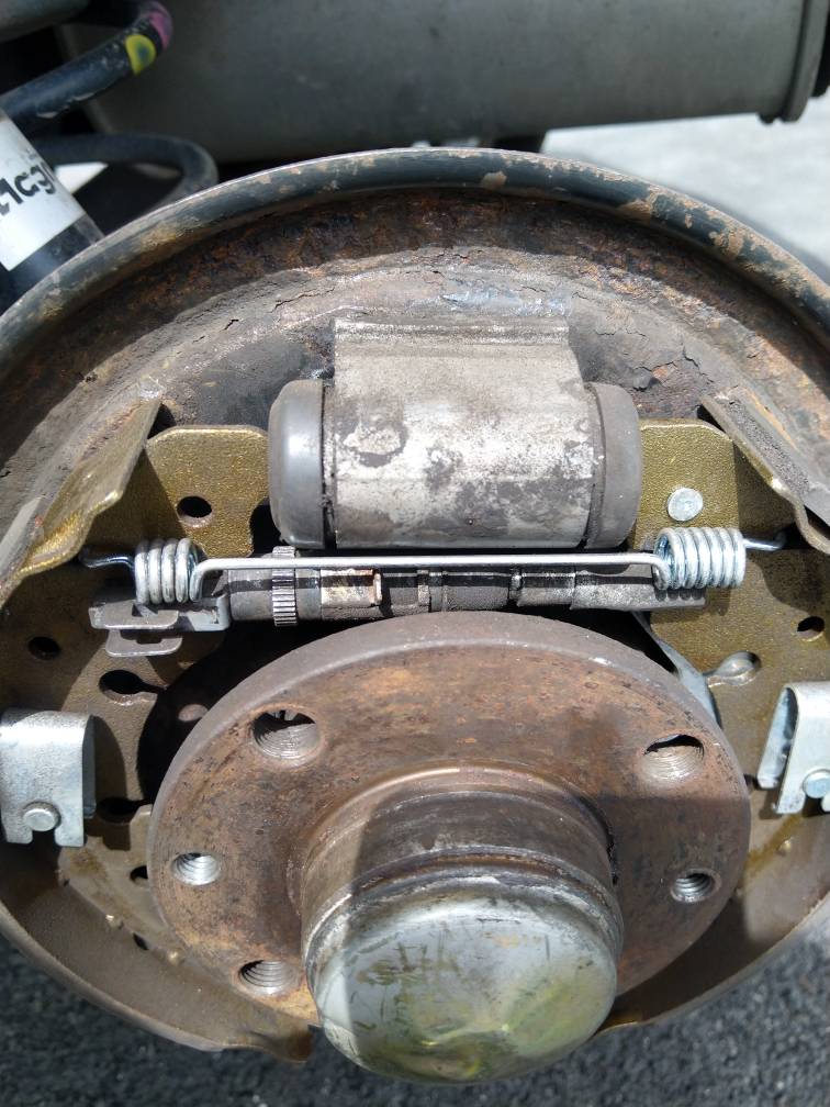

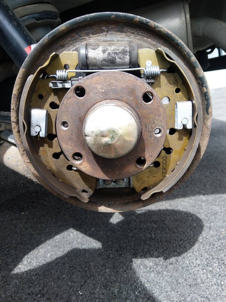

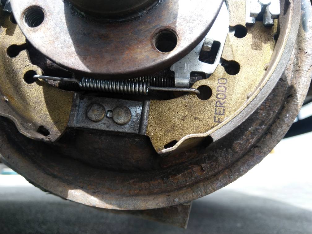

The reason why the handbrake lever (the one shown in the pictures) was off the place was because of some back spring behind the plate popped out of place and didn't hold like it supposed to.
Everything is in place now, tested it for a few kilometres, everything seems fine, pedal is still bit stiff but it's matter of habit now I think.
