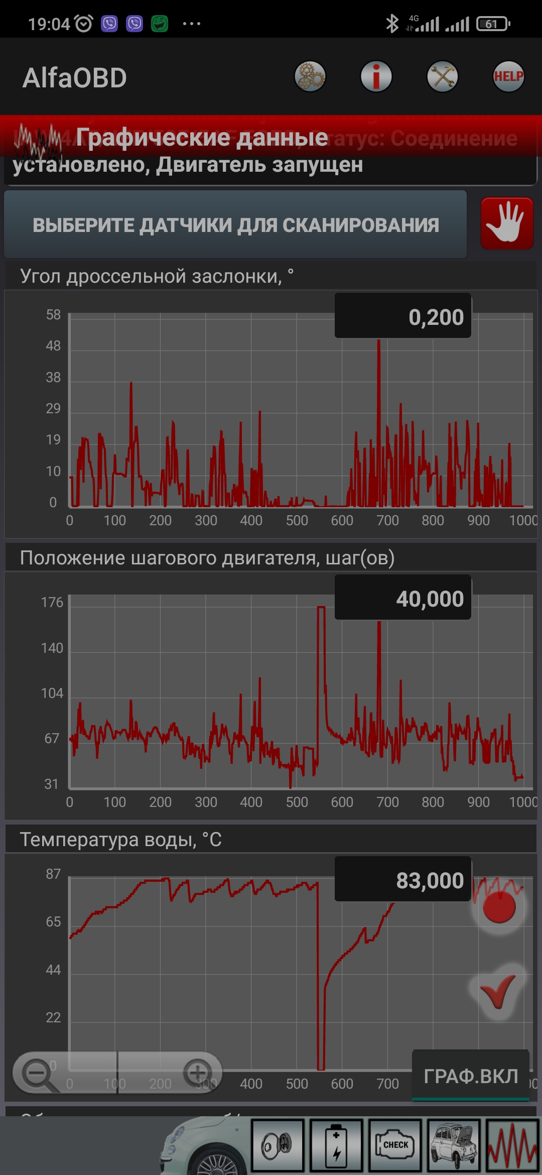

I have a Fiat Punto mk2b 1.2 8v with this problem.
It starts well when cold, after about 20 seconds there are gaps, the tachometer needle oscillates a little.
After warming up and switching to an idle speed of 750 rpm, the engine vibrates with a small amplitude, but a fairly high frequency, as if it does not pulsate.
If you start it hot, the revolutions rise to 2000-2200 rpm and immediately fall to 750 rpm.
Replaced spark plugs and spark plug wires.
The resistance of the primary winding of the ignition coils is 0.5 Ohm, and the secondary is 6.6 kOhm.
There is a difference in the time of energy accumulation in the coils, the first is 3250 ms, and the second is 2670 mm.
When driving, sometimes there is a misfire after 2500-3000 revolutions.
Changed coils, nothing changed.
There are no errors in the ECU.
Please tell me what could be the problem?
I suspect the coil driver.

Hi!
As long as you have obd2 scanner,check your long trims not only at idle,but also at high load e.g at 2200 rpm.
Have you ever cleaned the throttle body, particularly the idle control valve?
Does the engine coolant temperature sensor signal drop to Very cold suddenly for no reason part way through alpha obd scan?

I had very high revs when starting when I had not properly bleed the cooling system. So potentially your problem is caused by something to do with the temperature sensor. The car will start normally if you disconnect it, but the engine fan starts running.
The revolutions rise literally for a second and immediately fall to normal.
The temperature is read correctly.
Unless the sensor fails at the time of start-up, and then becomes functional)

>>Even at the moment of start-up, the temperature arrow goes to the very top and the overheating indicator lights up and immediately settles into place.
the sensor connector is a bit fiddly to unclip but why not do that to be sure it is not the sensor?
