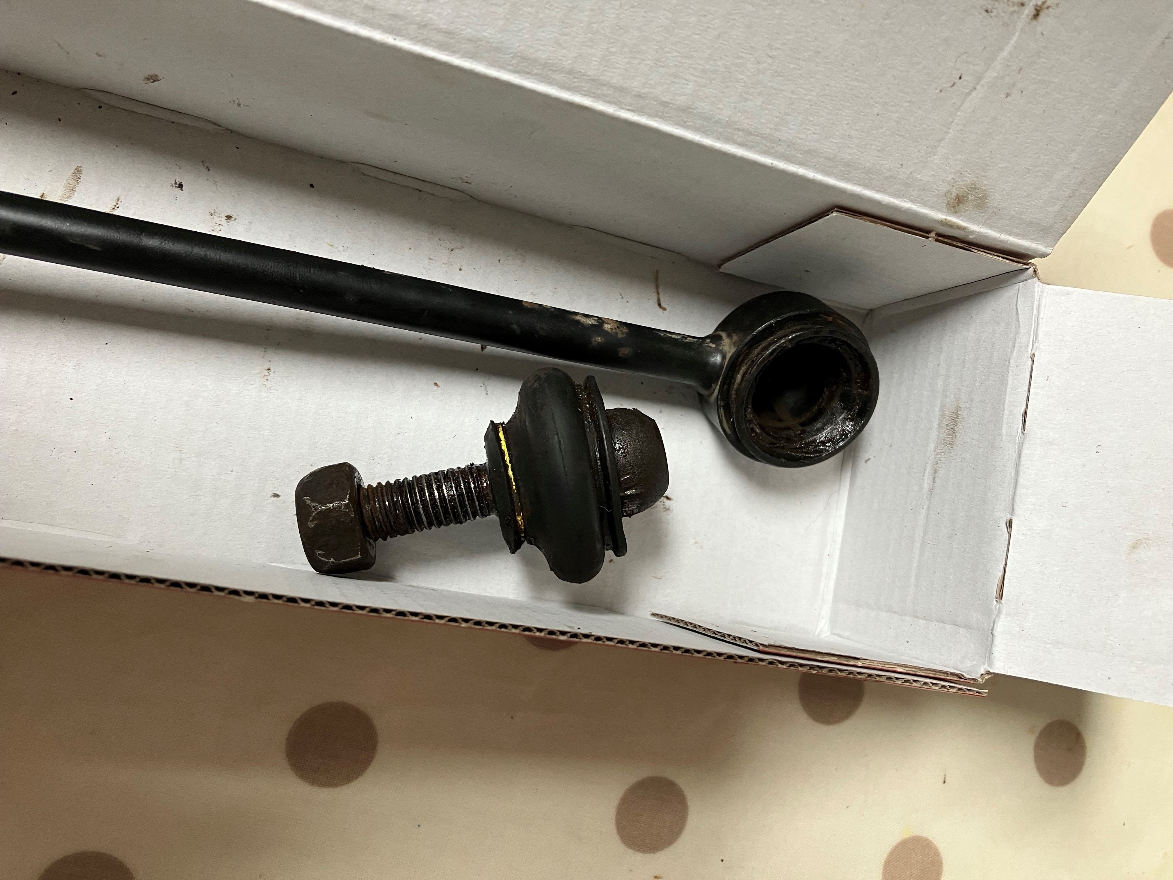

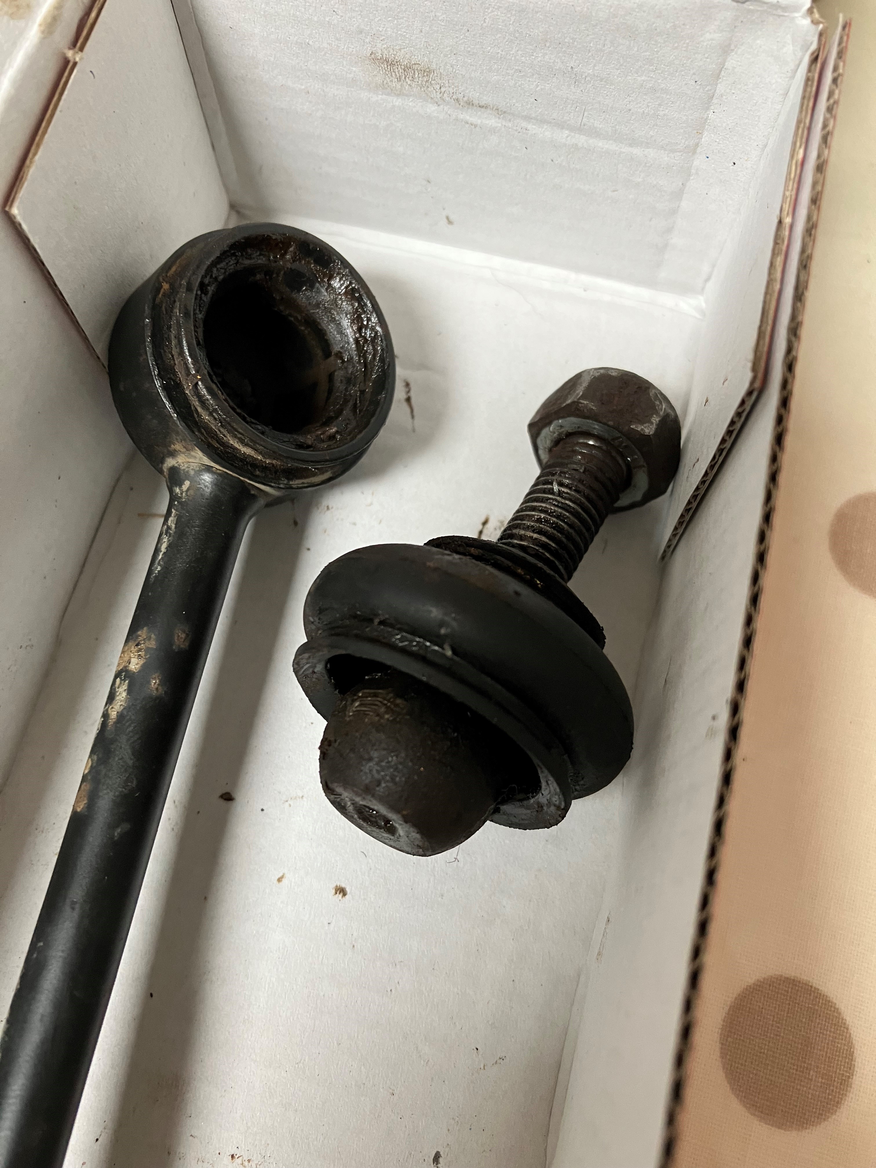

Changed both drop-links because it was clonking and banging like Steptoes cart (clonking banging more than normal i should add). 10 minute job? In theory but it took me 2 hours due to rust and the allen bolts rounding off. In the end i had to cut them off. One virtually fell to pieces.
