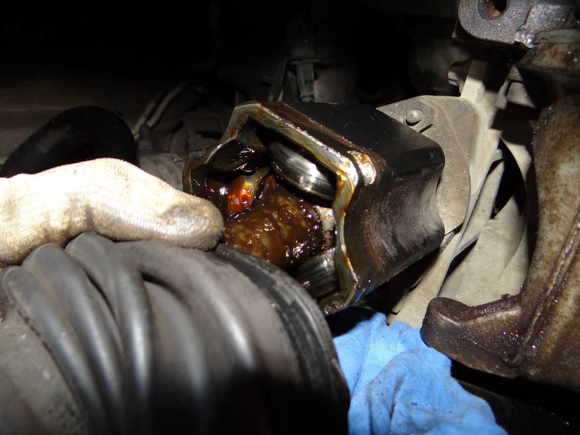

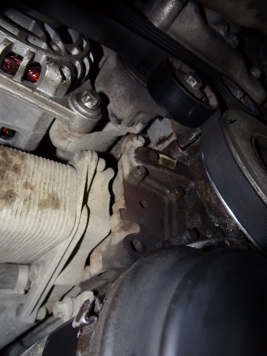

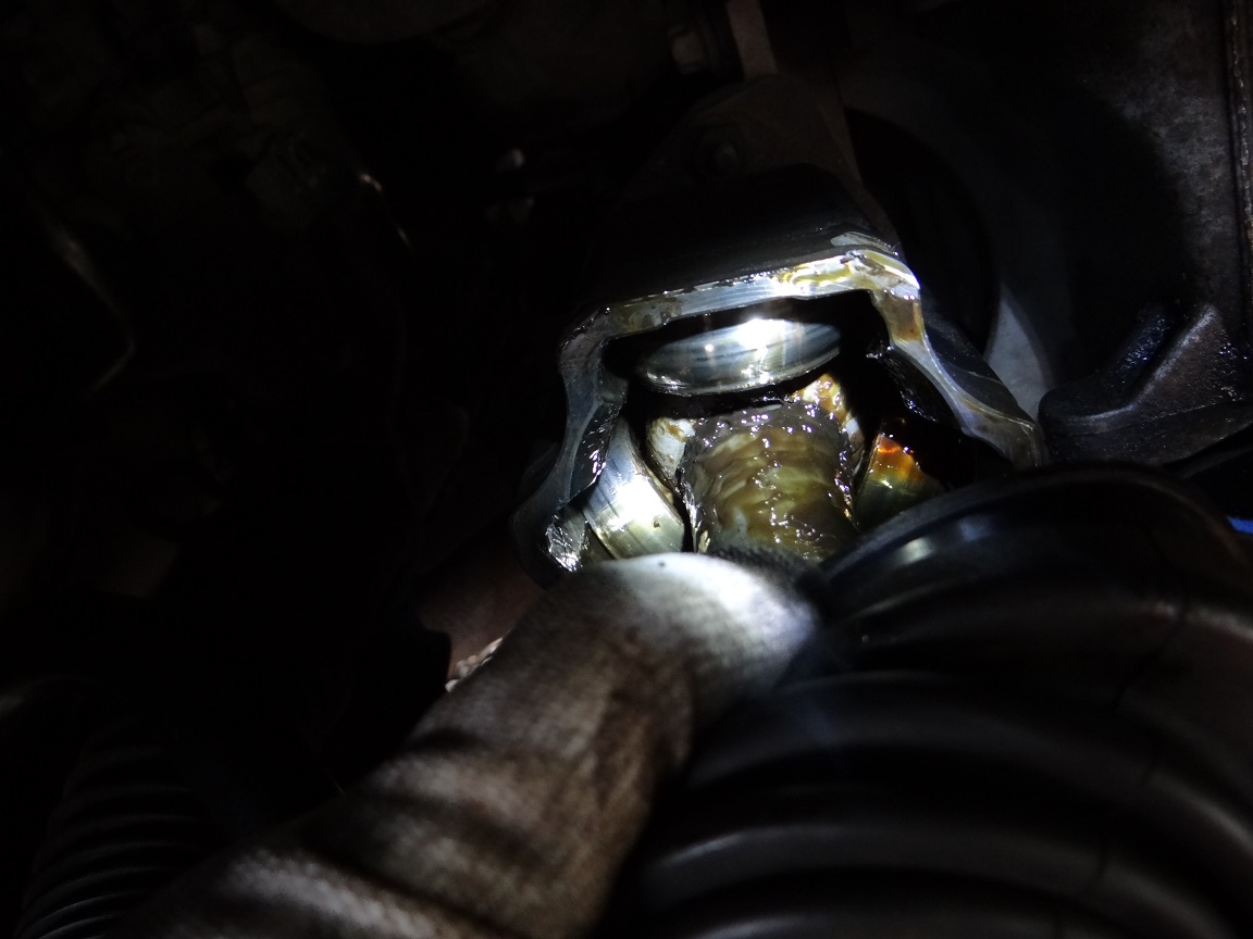

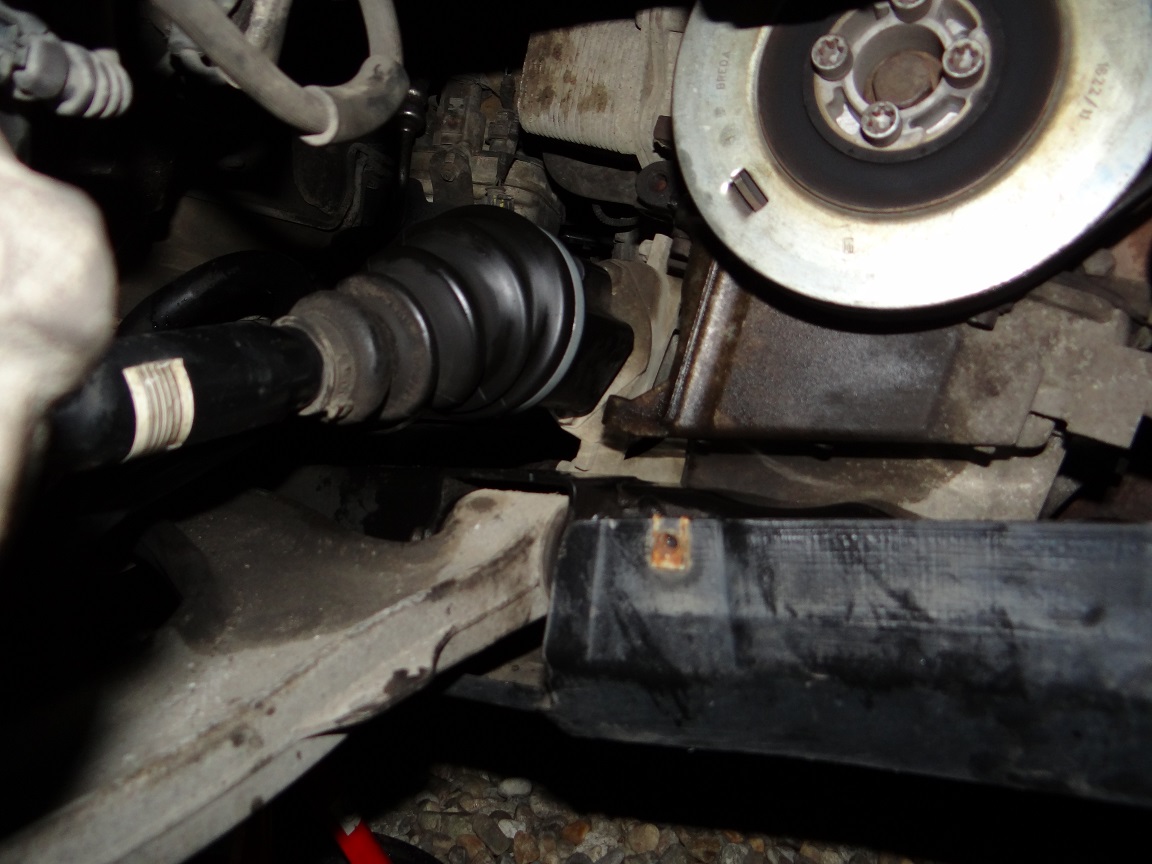

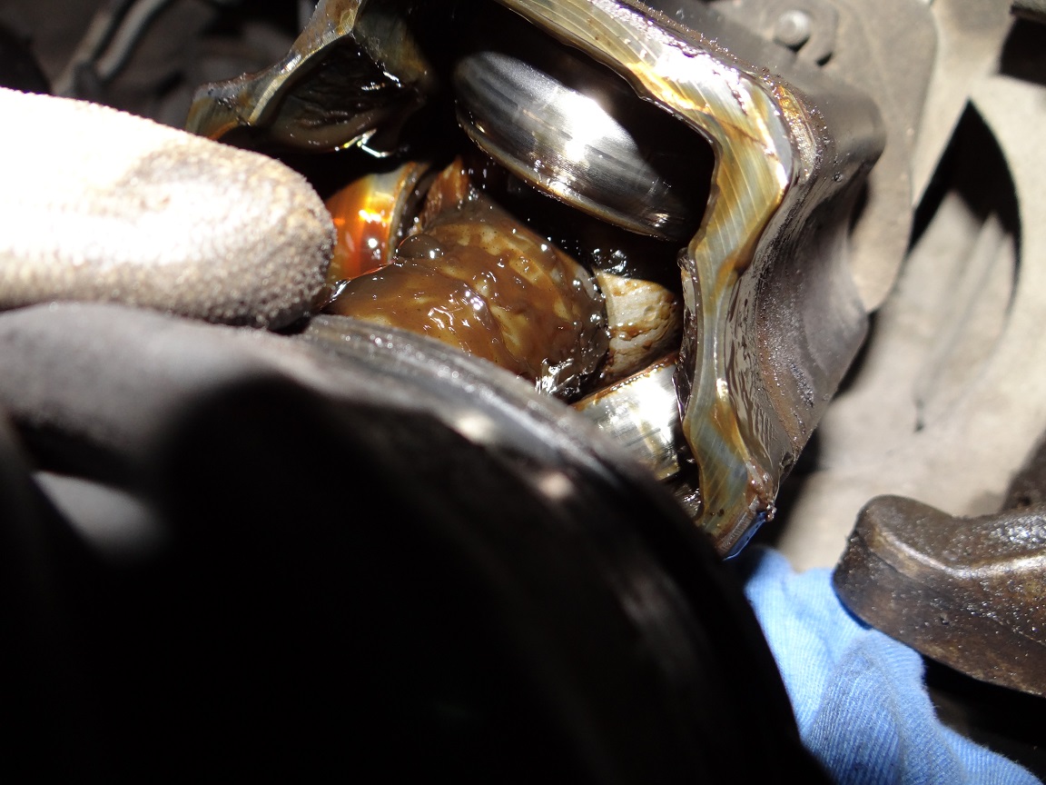

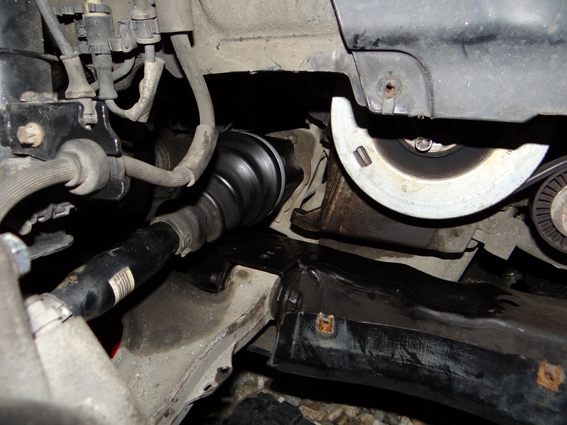

I have found the source of my "clonk" noise. The right driveshaft was almost dry out of grease. As I did't found any Tutela MRM Zero or something NLGI-0, I topped up in both tripods with 100gr of Lithium/Graphite grease. I will not stop searching the right grease, but until then it will stay like this. Now it is all smooth, no clonk or wobble, but the tripod may have suffered some damage during the time without grease. When I took off the collar, I could feel that it was more loose than the one from left side, probably the problem is from the material used to manufacture the collars ...OR it is an intended manufacture defect to sell some driveshafts after warranty, but I guess we will never find out. I have checked the plastic zip on the left side after a 500km trip and it was all dry and clean.

Here are some pics of the right driveshaft:

Well now that is 3 of us who can say that grease is the key to stopping the wobble!!
If you are not getting any wobbly or clonk with what you describe as more wear on the side which was dry?? then it shows a bit of wear is not a problem!
I can see by your photos that there is a location "nick" on the points of the tulip after all, did you notice any more signs of a location gulley around the rest of the outside of the tulip?
I would think that if the idea of the gaiter is to keep dirt out and grease in there should be one which will act to stop the gaiter sliding off the end of the tulip. My mechanic cannot remember if there was such a thing on mine( manufactured in 2005 Dec ) . Yours might have been a later manufacture and the design may have altered .
No, those are the only ones, six n total, but they are enough. The big problem is with the collars. The plastic zip works for now, I will check their condition from time to time and if it is necessary I will replace them with something else. But I used same type on my old Fiat Tempra 1.6 SX, 1995 manufacture year, which had the tripods in the gearbox, they kept the gearbox oil from leaking as that was also the lubrication for the tripods. If they kept that from leaking and lasted over time, I don't see why these wouldn't.
