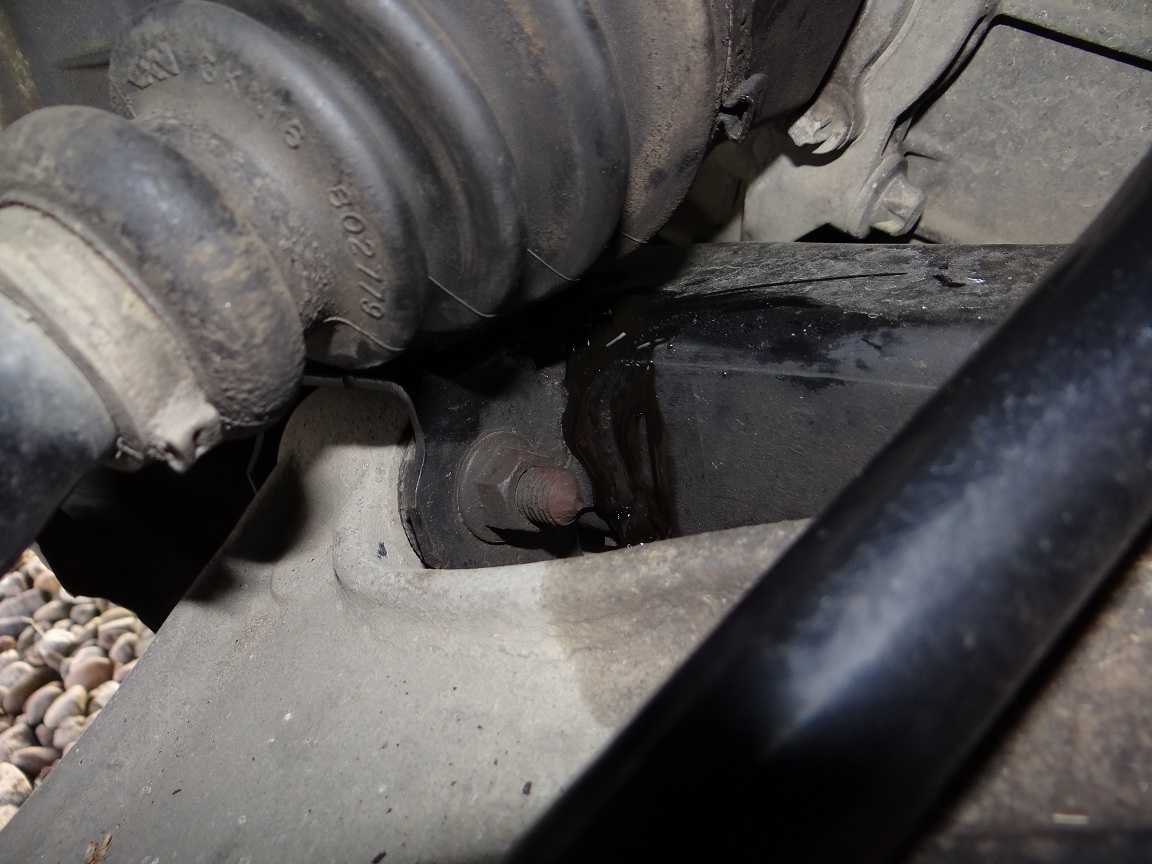

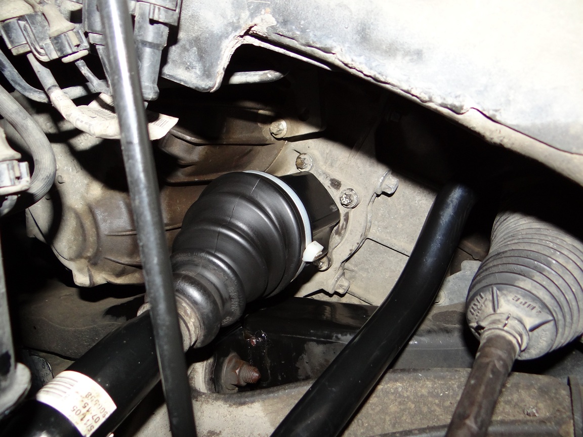

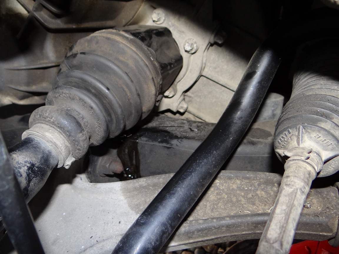

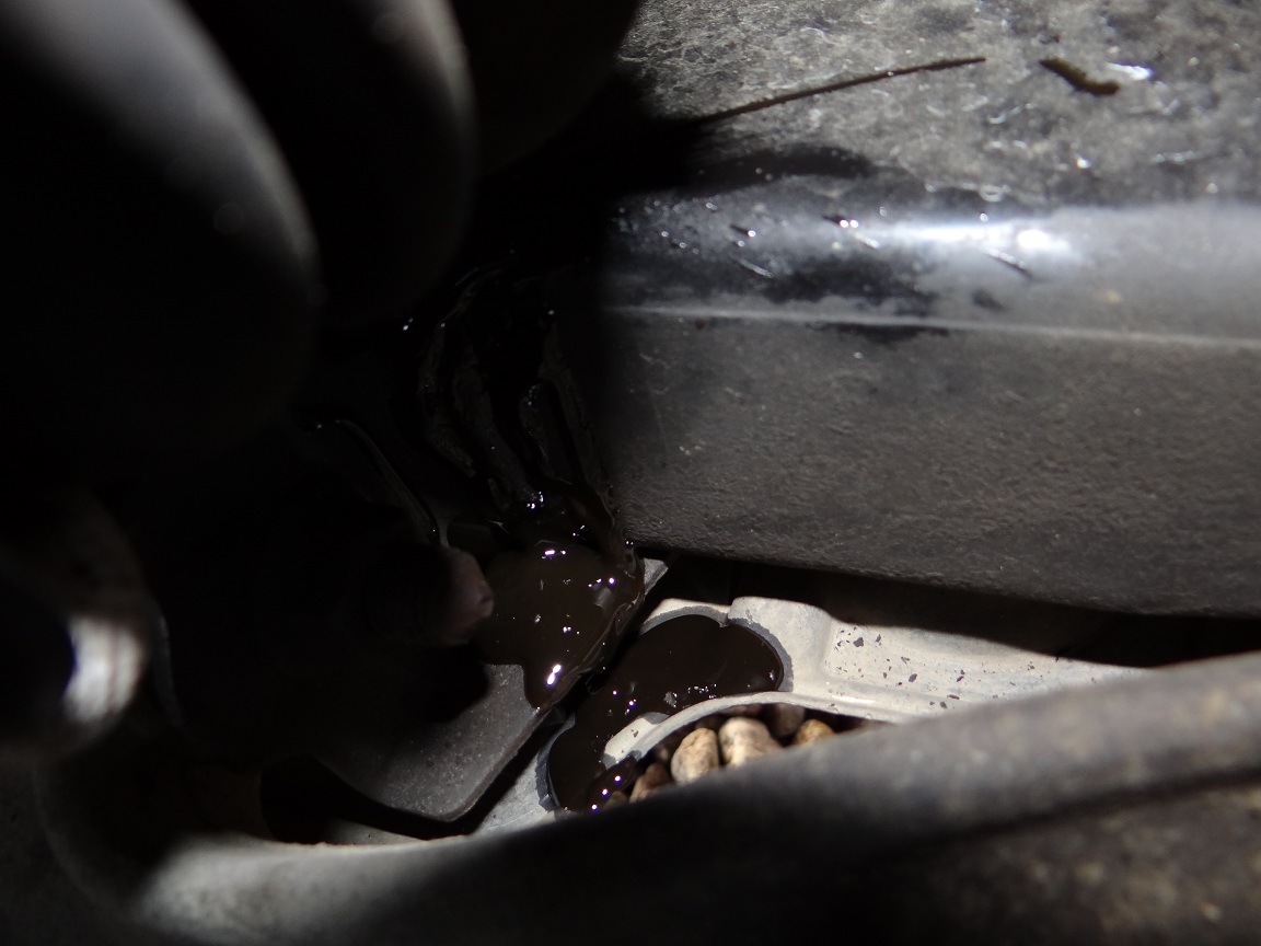

No problem, no confusion. I'm sorry, I said it wrong about grease under the car, the grease was all over the engine compartment on the line wherr the rubber seal of the shaft ends towards the gearbox and an impressuve amount of grease was sticking right under the rubber seals in the same line mentioned above. I'll post some pics later today after I finish mounting my bumper and headlight.

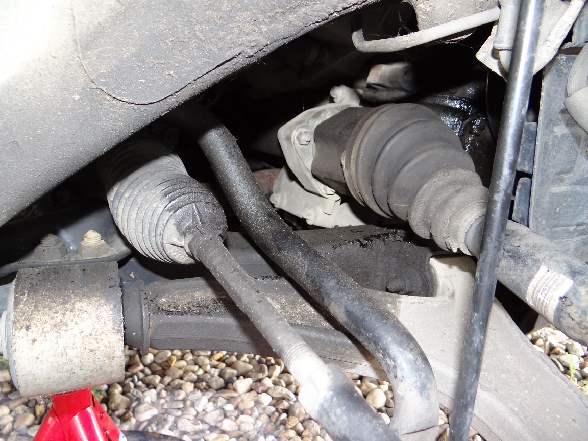

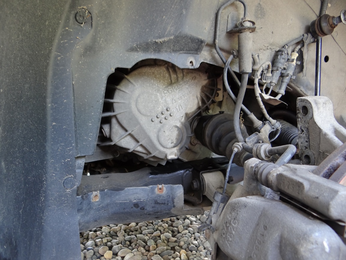

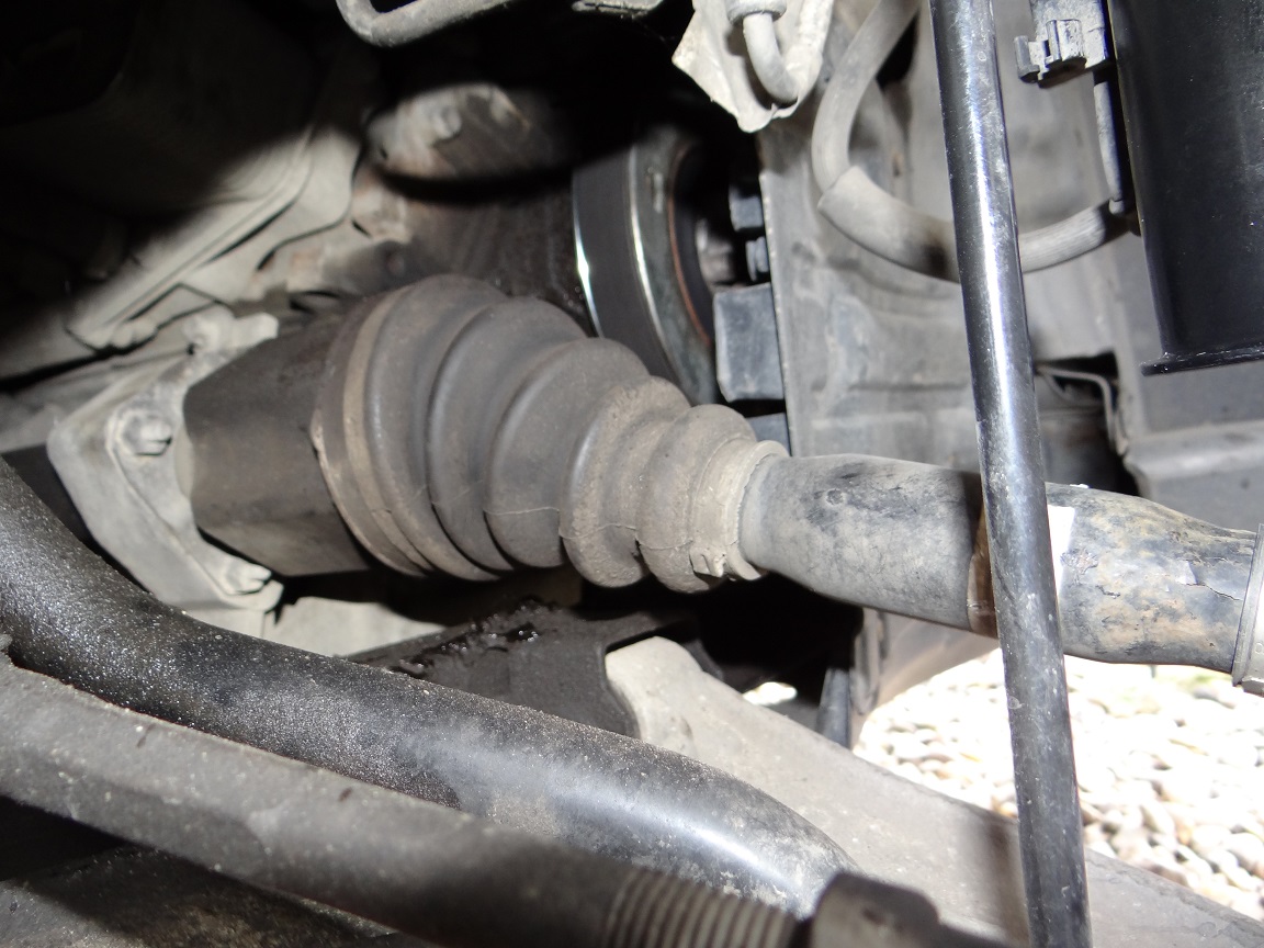

Here are the photos:

This is much clearer now, both sides have shot the grease out of the tulip joint and from your photos its a wonder that the attendant drive belt is not slipping on the pulley, its getting well lubricated!!!
I think one way to lessen the financial blow would be if you could source a couple of Tripod joints which fit in the tulip and are what is most likely to what is worn out. They are held onto the splines of the shaft by a circlip and would be a doddle to change if you could source them in your country ;) I have tried everywhere over hear but they only seem to be supplied to the firms who "refurbish" shafts as a business.
I am sure that they only change this end of the shaft on most them when they get them as over time they will have made a judgement call on the other end which is more of a normal CV joint which they have more experience of.
Having checked on the qualities of steel the various parts are made from it is certain that the Tulip will be harder than the tripod and as I have said before in a thread the normal way to engineer out difficult jobs is to design it so the easy to do job wears out first, but of course, we are talking about Fiat- or even worse- Vauxhall:yuck: Dont bother measuring again its obvious from what you say the Tripod is no good

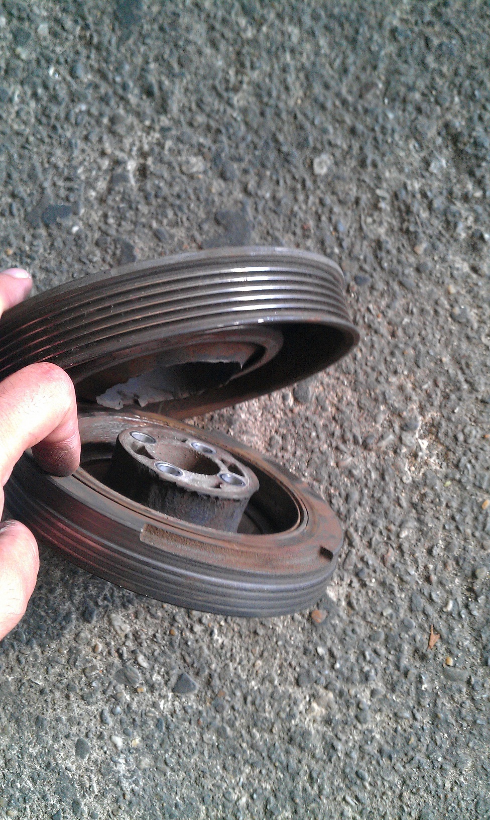

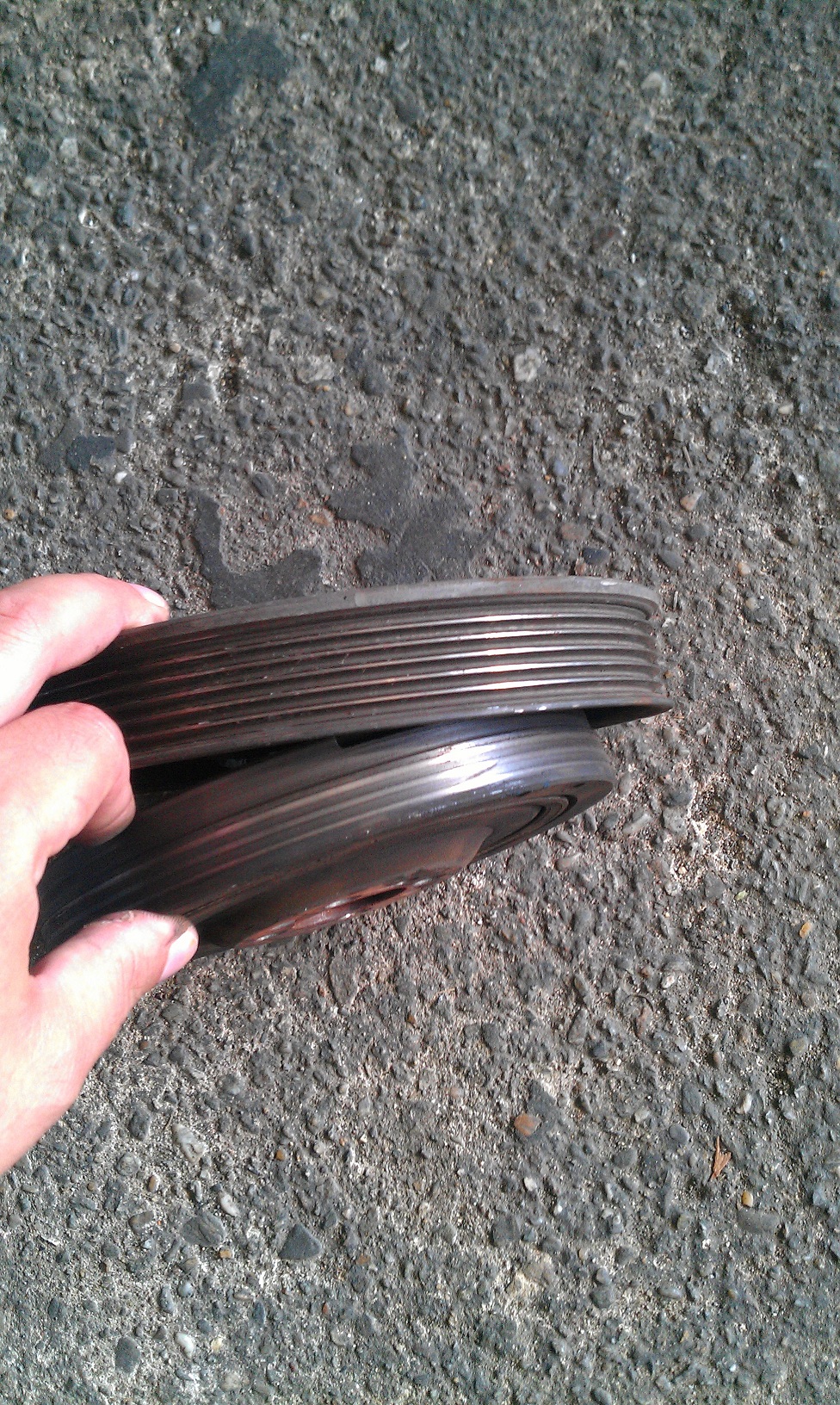

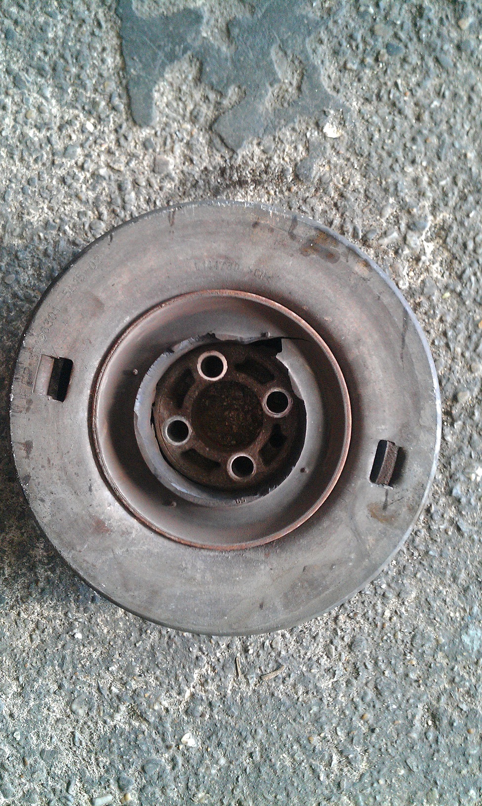

The grease is not reaching the belt, its going right at the back of the pulley, which BTW has broken after 150.000 km, so if anyone has the mileage and didn't changed it, you may reconsider. It broke when idling, I heard the noise, it sounded like I lost some heavy screw, I stopped, looked around, seen nothing and kept running for another 150 km, then I went to change the cam belt and seen this pulley broken. After it broke, the belt stayed on the inner part as you can see in the pictures bellow, that was strange, but it seemed that the tensioner pulley did the job and found the exterior part just laying around in the engine bay.

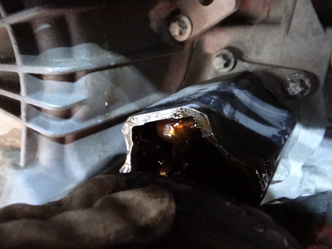

Well, today after work I gave it one more look to check the play and measure it correctly and I had o surprise. Seems that at the previous check I didn't do it properly, as now I found out that I have no play in the shafts, the play seems to be in the diff and when I turn the shaft back and forth I hear some noises like the diff is not lubricated, but there's no oil signs anywhere. I have looked in elearn to see if there is a way to check the oil level easy, but no luck.

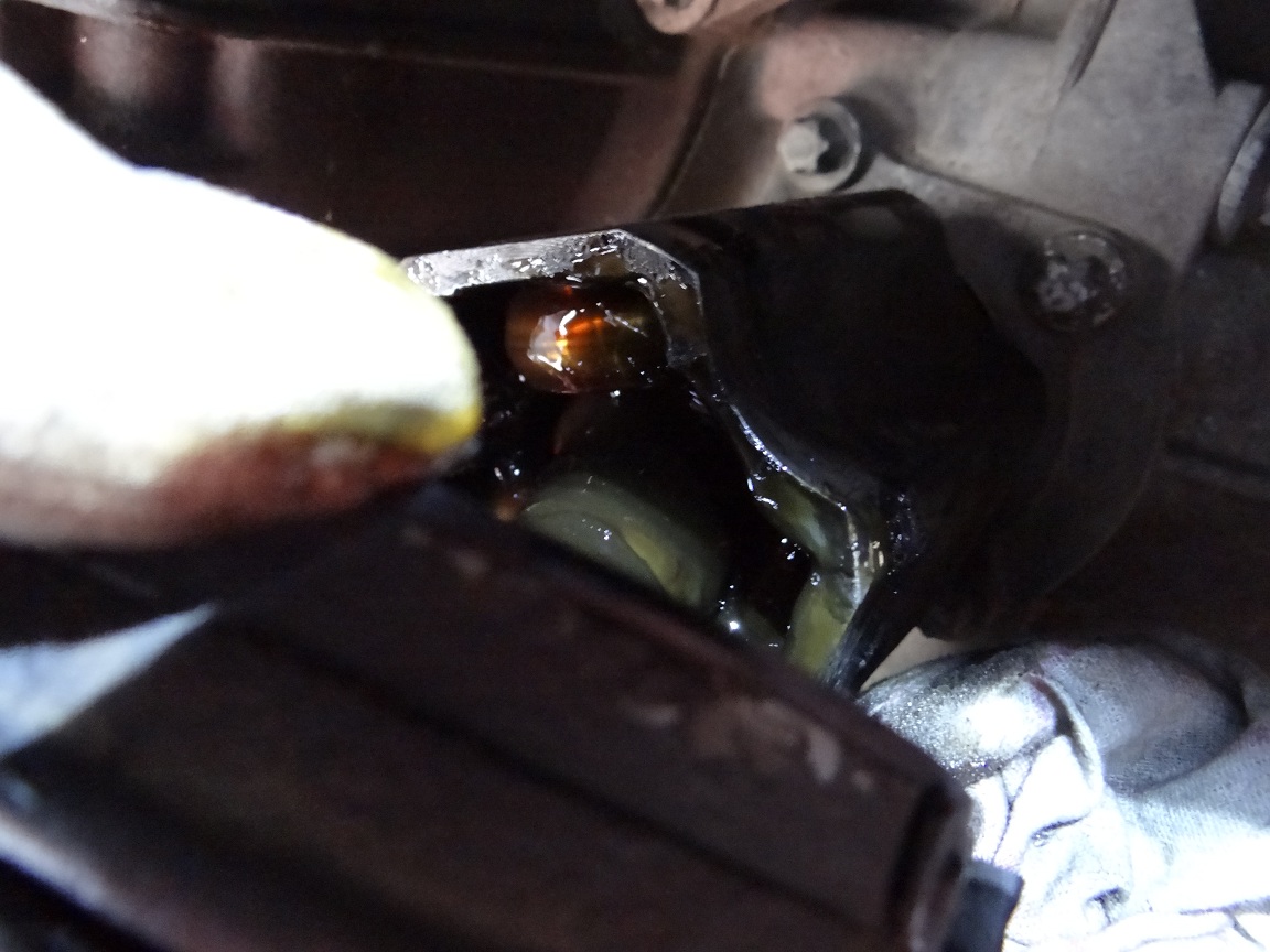

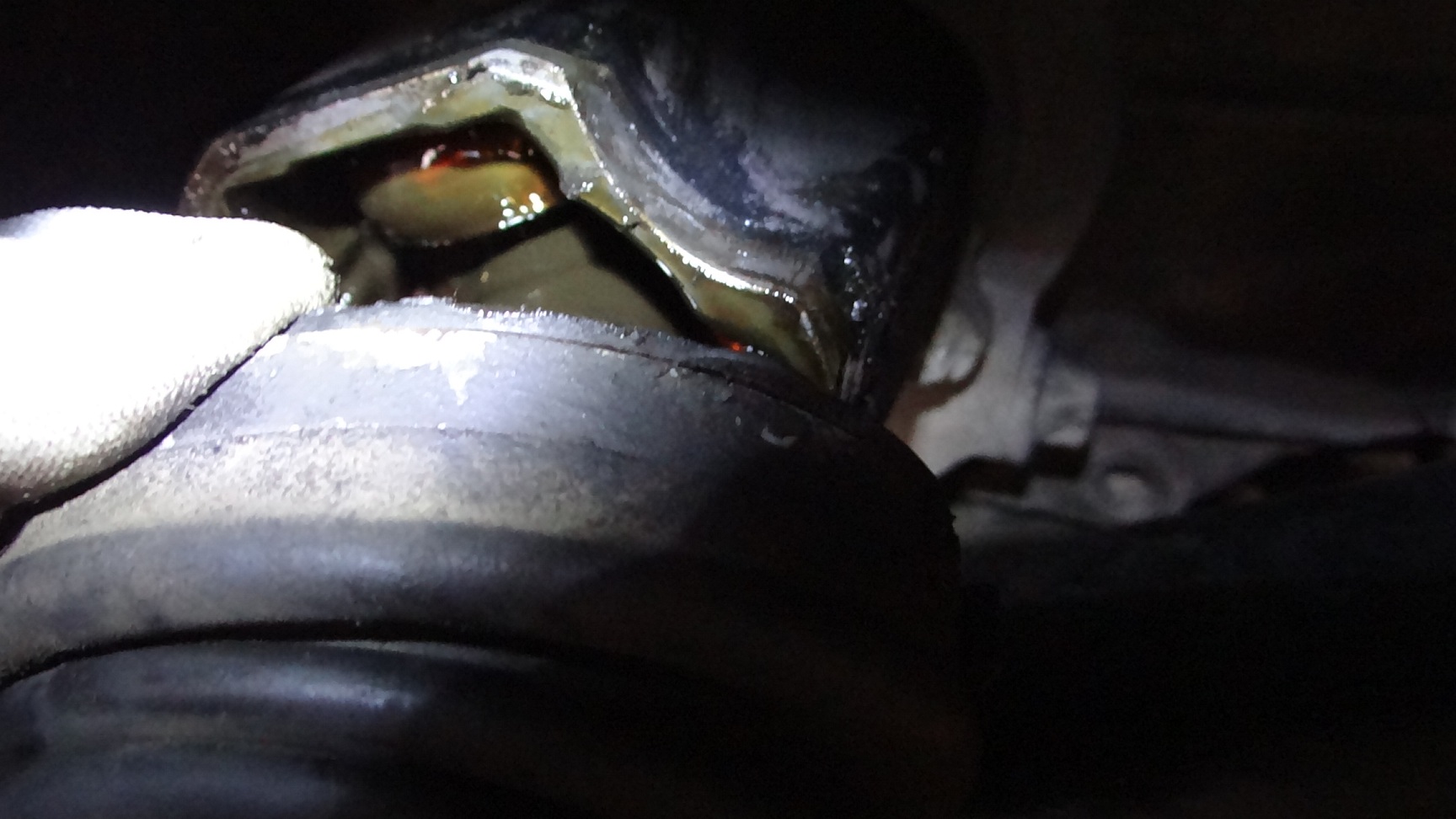

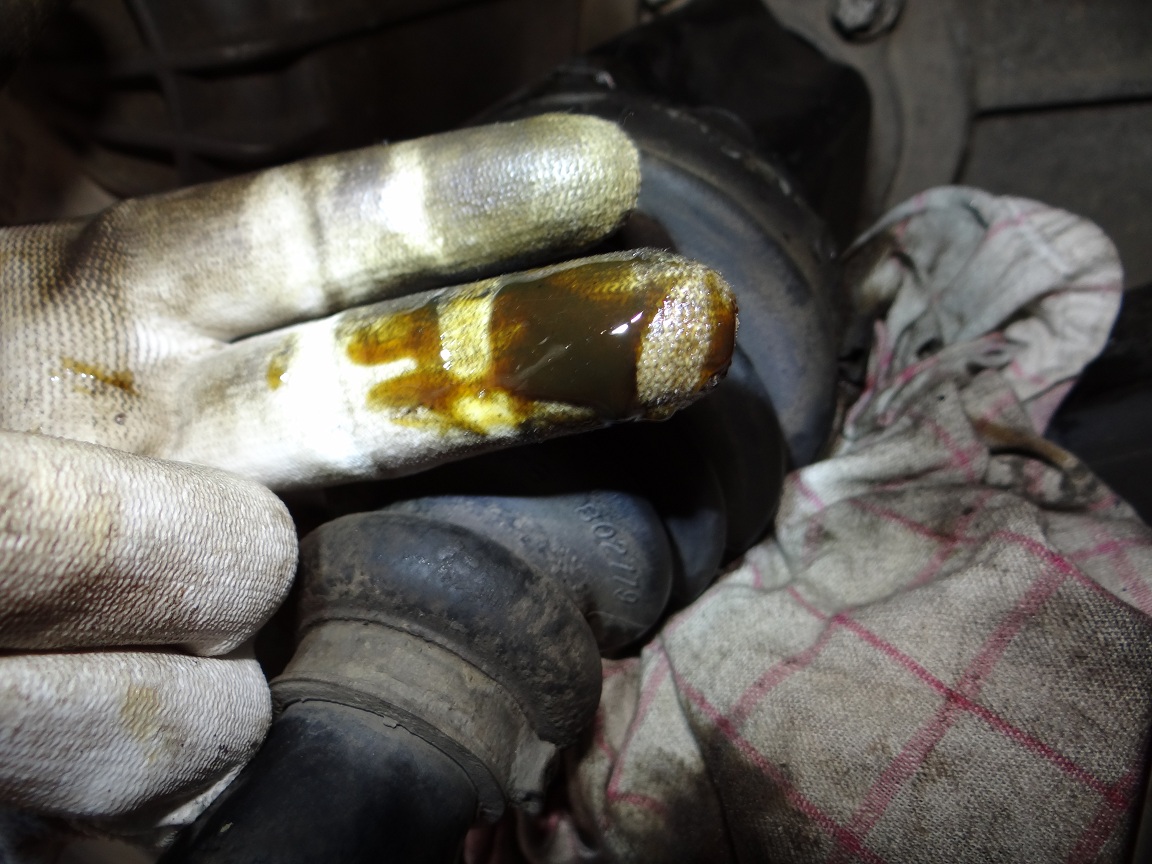

Now back to the grease leak, I forced a just a little bit the rubber and it went out of the tulip :eek: as you can see in the photos below. Then the grease started to drip :eek: like it was some thick oil. Well that was strange, I thought the grease its very thick and shouldn't drip, at least the lithium one that I bought is very thick and it doesn't drip at all. Doofer can tell us if the Tutela MRM Zero that he has is dripping or even make us a picture because I am very confused right now :confused:. Well after all of this I have put back the rubber and changed the collar with a zip tie just temporary until I figure out what grease I should put back in.

That does look very thin!!
However dont overlook the obvious, if you bought the car second hand somebody may have had a go at this before and didnt put the correct grease in.
If you now say that you have not much play in the CV joints then its a whole new ball game.

Also one of the photos shows a very clean /white label on one of the shafts and nice clean black paint on it If thats not a new shaft I`ll eat my underpants!!!(y)
Yes, it is thin, I found out why. The type of the grease used in inner tripod joints is semi-fluid, NLGI-0 classification. The one for the outer joint is NLGI-2, which is medium viscosity. So the grease it supposed to drip, but not like this one does, which makes me think that the OEM is not so great, that's why its dripping from many shafts. The shafts are old, I've cleaned this one and that's why it looks like new :). Now I have to find a good NLGI-0 grease with MoS2 and some good collars.
