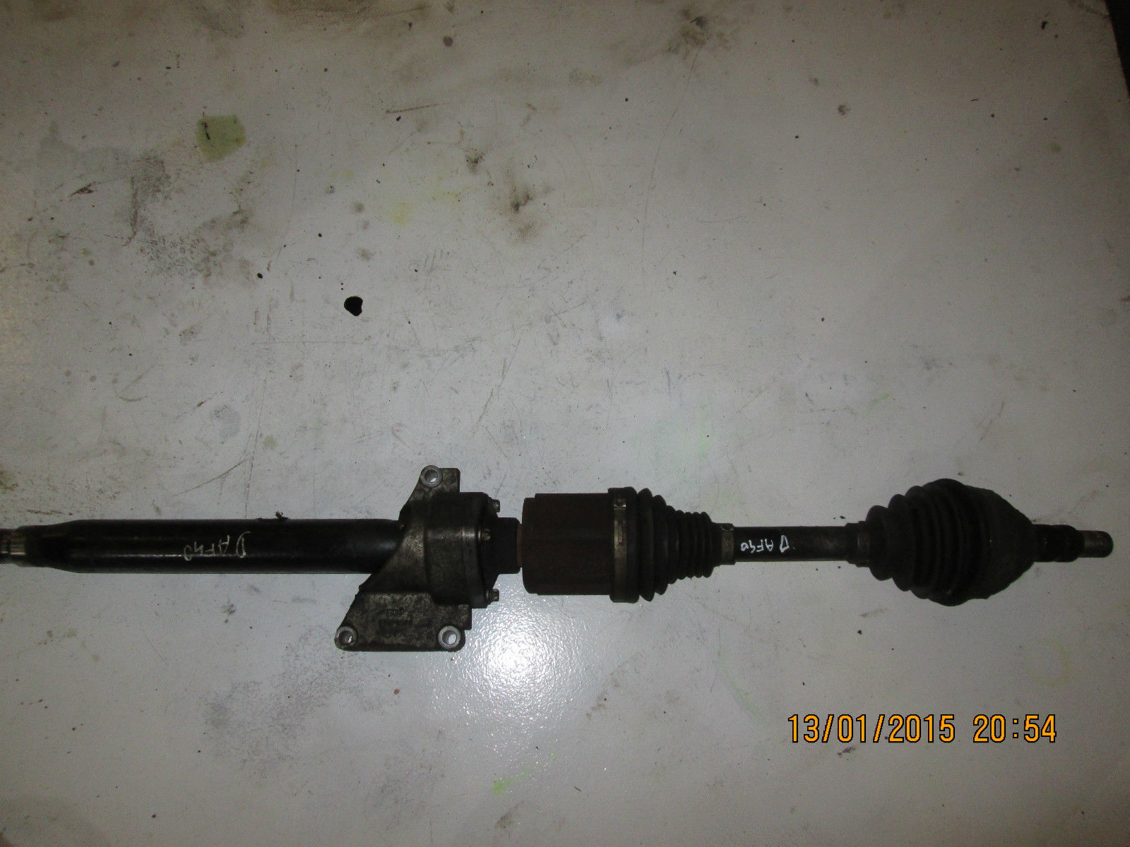

Just to say, i own a Croma 150bhp and have a wobble problem and its been a nightmare, had a refurbished driveshaft or part of done and it failed after 50 miles. The bearing fell apart, bought a Vectra C M32 driveshaft and it was completely different and couldn't be fitted.
Hi Jaffacake I have nursed our cromas drive shaft along for some time but this summer I hope to change it for a vectra one.I thought I had settled on the correct
one for our 150 there are some wrongly identified I think on ebay just to confuse things but am pretty shure the photos illustrate .
Did you look at it or did garage say it could not be fitted? Apart from a possible different bolt length on the center support, the Vauxhaul M32 shaft should fit. Some garages don't like fitting "different" parts.
Hi, i have had my Croma for two trouble free years but last November started to wobble upon acceleration. It went into the garage where a shock absorber and tie rod were changed which did need doing but the wobble persisted and was due to go in after Christmas. I decided to wait until March when the MOT was due as i thought more issues would crop up. It did fail the MOT on both inner gaiters and i asked the mechanic to check the driveshaft at the time ( different garage to the one previous ). The spider bearing had collapsed so was given a choice of a Fiat dealer part £355 or refurbed one at £243 fitted. I settled on the refurbed one but only found out today that only the spider bearing end was refurbed and not the hex/pod. It lasted 50 miles and then again the bearing had collapsed, it was even worse than the first time. I ordered a Vectra C M32 driveshaft off ebay as a back up just in case after reading various posts on here and it came the next day. I took it down and got a phone call saying it was different and went down and saw both of them side by side. The sump bracket was different, the overall length was different and the shaft length between the joints was longer on the Vectra. Anyway the garage loaded excuses at me, dont think they knew what to do next unless major money is spent. I dont think i will see any of the £243 already paid as they said the refurb company will say it failed becuase the hex/pod is worn. I didnt have much choice so i told them to refit driveshaft and drove it to a reputable garage who will be looking at it. I noticed the Vectra Auto has a similar hex pod to the Croma but who knows which one will fit my Croma. Anyhow it is out of my hands now, just looking forward to a massive bill
Hi, like you i checked various driveshafts and thought i had ordered the correct one but looking at the Croma one , it has a more stubby shaft between the joints. Obviously its not as easy as expected
