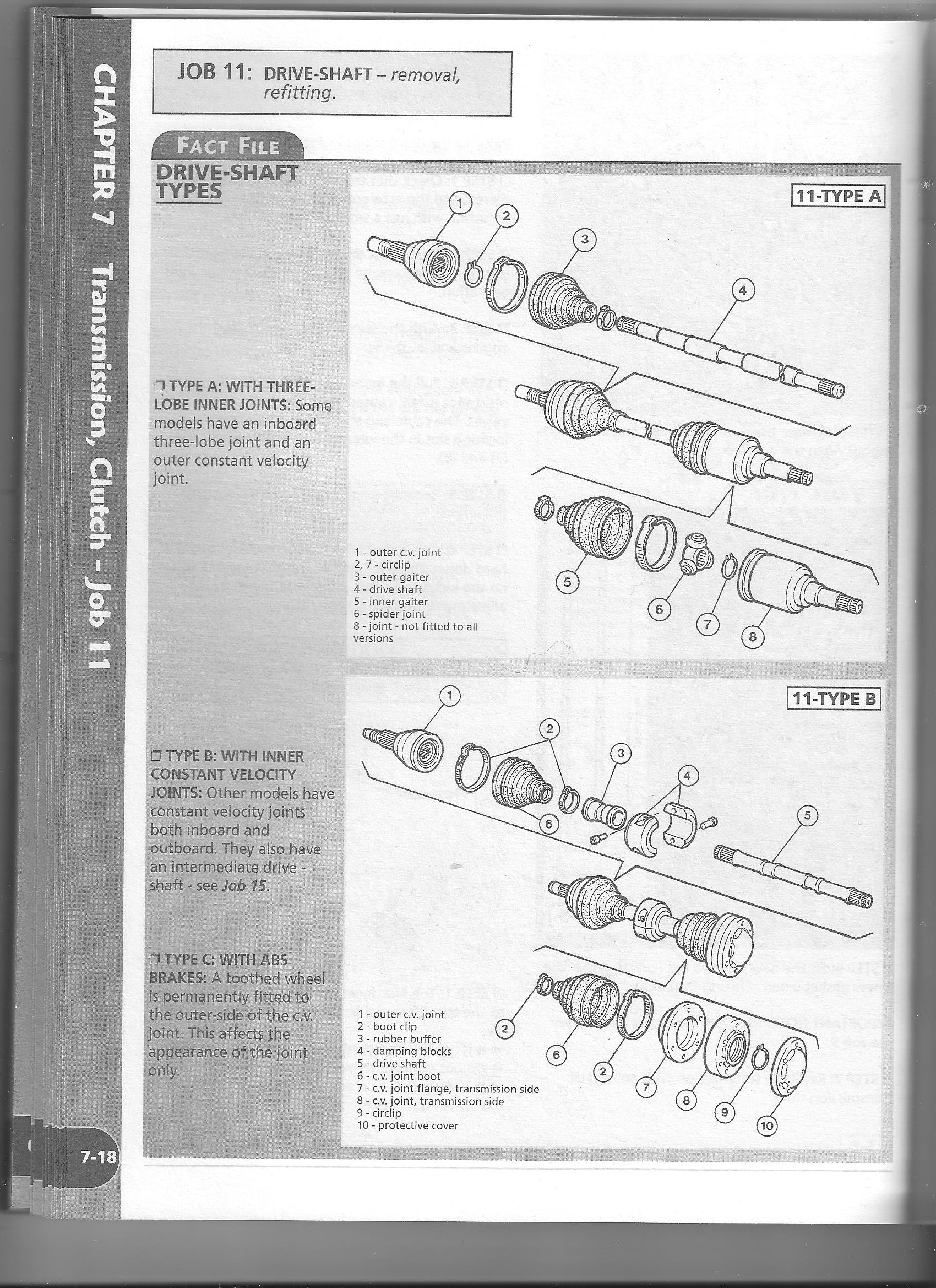

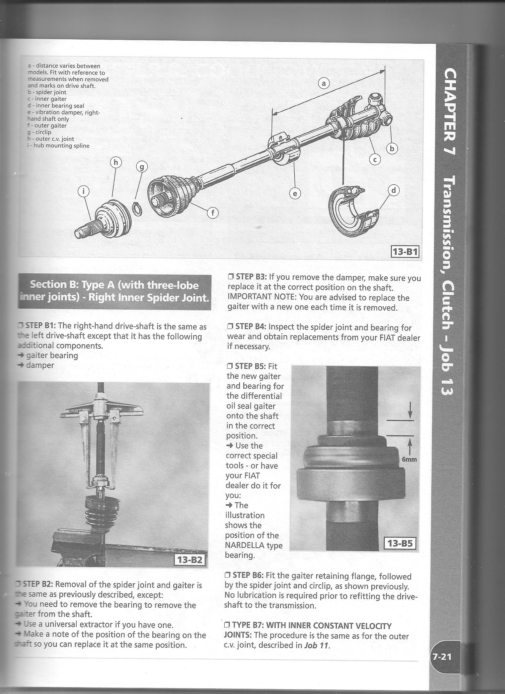

Hopefully these are the pages from my old Punto / Marea manual (Lindsay Porters) showing the arrangement of drive shafts for the various Fiat models ( Tipo, Tempra, Seicento, Cinquecento. Punto, Brava . Bravo, Marea& Marea Weekend.)
Food for thought?:confused:

Your garage should be able to check what is causing the vibration, the croma shaft is in two pieces it has a long shaft on the os with a tri pod joint this is the problem. I will get the part numbers for the vectra shafts tomorrow but I would go with a good second hand one, I can source the bits for you and confirm they are ok with no play and boots intact, if you like at cost, it's not a big job to swap, an hour at max. The beauty of the vectra shafts is that you can get the inner and outer cv joints easily in the aftermarket.
Thanks for the pictures the fault is with part 6 and 8 that is the tripod joint. This on a croma sits at the End of a long shaft on the osf, the NSF goes directly in to the diff on the osf it's a plain shaft about 1 foot long the then terminates after support bearing with the joint. I will get some pictures.
Cheers for your pic Chris - I have been doing a lot of head scratching about the problem with the design of the Croma tripod /tulip joint verses the one on a Vauxhall. All the while the ability of the Croma ones to lose grease has caused me most navel gazing moments.
However as I have now found my old manual it is now obvious why we have trouble and why the earlier models are relatively "bomb proof" when it comes to grease loss.
The earlier ones which are shown in my earlier pics the tulip is round on the outside profile with a lip and a location grove for the gaiter. The Croma ones are hexagonal on the outside and have the three tracks for the tripod bearings machined into the internals. No lip is present and very little location is provided for seating the gaiter . This allows for movement of the gaiter and loss of grease , its easy to see how the wear will take place (without grease) on the inside "track"within the tulip as the bearings on the tripod will be hardened to a much greater hardness than the steel used for the tulip .
The material the tulip is made from (according to my training manual) is XC45, which is pressed into shape either cold or hot . It is a similar process as making a box spanner.
I am beginning to think that we are changing the wrong part when we change the outer shaft to cure the wobble! We should change the inner one first. Guess what--- Fiat only quote for the outer !! or the pair they dont want to sell you the inner only and wont sell you a tripod either.
The "refurbishers " ----hmmm--- how can they do it by return in 24hrs??. They have access to the outer CV joints and the tripods . If the outer CV is ok they only need a pair of circlip pliers and 5mins to change that and its back in the box /van and away.:(

I agree with your view the one I took apart had water in it, the tripod joint was rusty, the boot was intact but as you can see on the picture the grease had been flung out due to centrifugal pressure. The reason I don't like the design is as you say the tripod receiver Is pressed like a box spanner. Not machined out of a solid piece. This is why it's so important to get te correct thick grease in the joint to take up the slack! It could even flex and expand under severe acceleration as it is only a a thin wall. Overall a rubbish design. The vectra inner joint is solid cv joint with a good cv boot design. The only answer is Change to vectra shafts. Not sure how they can recon the inner pot joint. Yes you can get the tripod separately but the pressed shaft is not really repaireble apart from welding and re machining which I doubt they will do, they will put new tripod on in an old joint with the obvious wear pattern still evident.

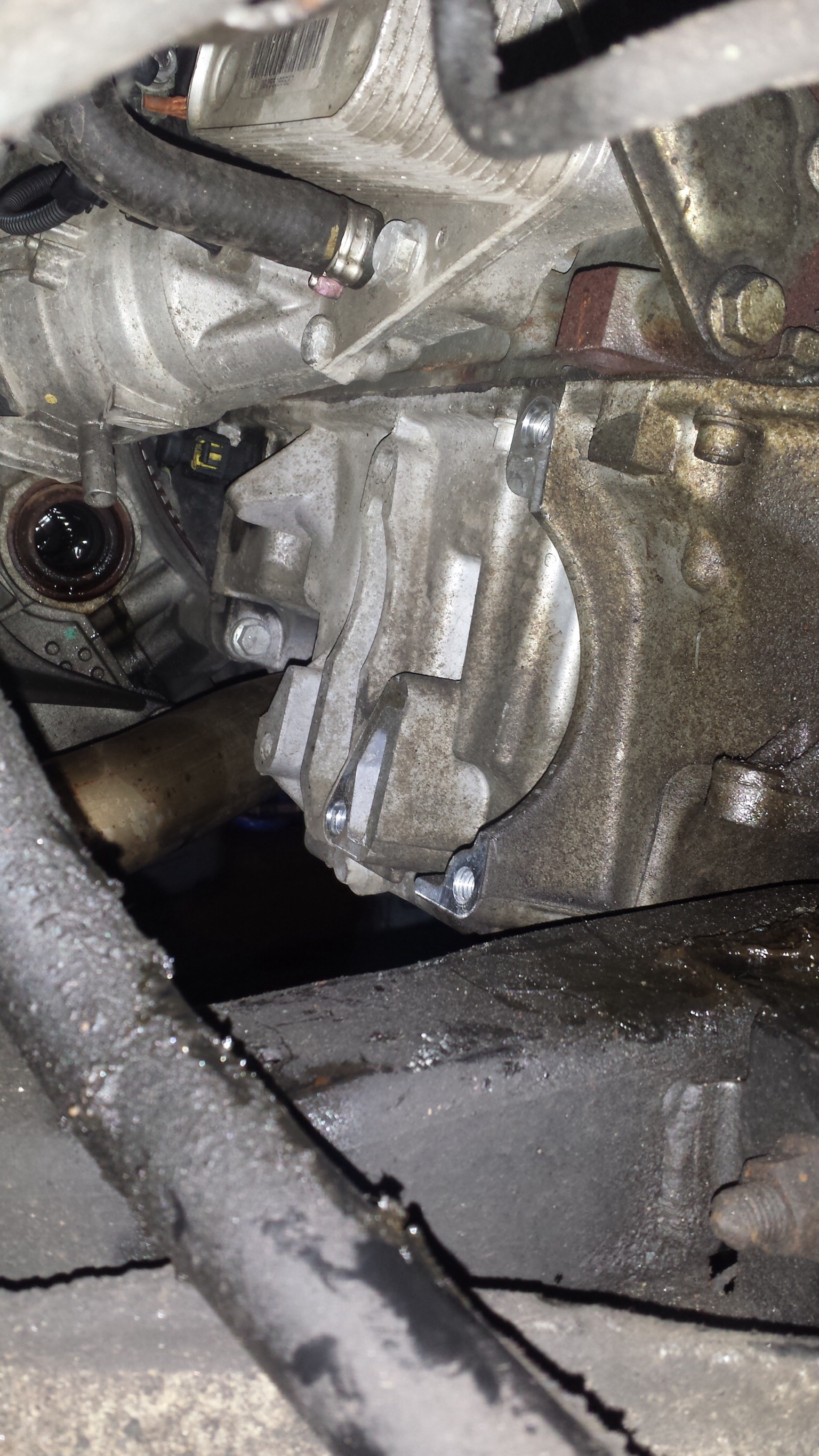

Ordered the GM driveshaft in the link above, (Thanks Chris) today. So, whilst doing a general service on the car today, I took the under-tray off the car for a looksee and found that there is a little oil weeping from where the OS inner shaft enters the gearbox... Is this normal if the shafts have failed?
