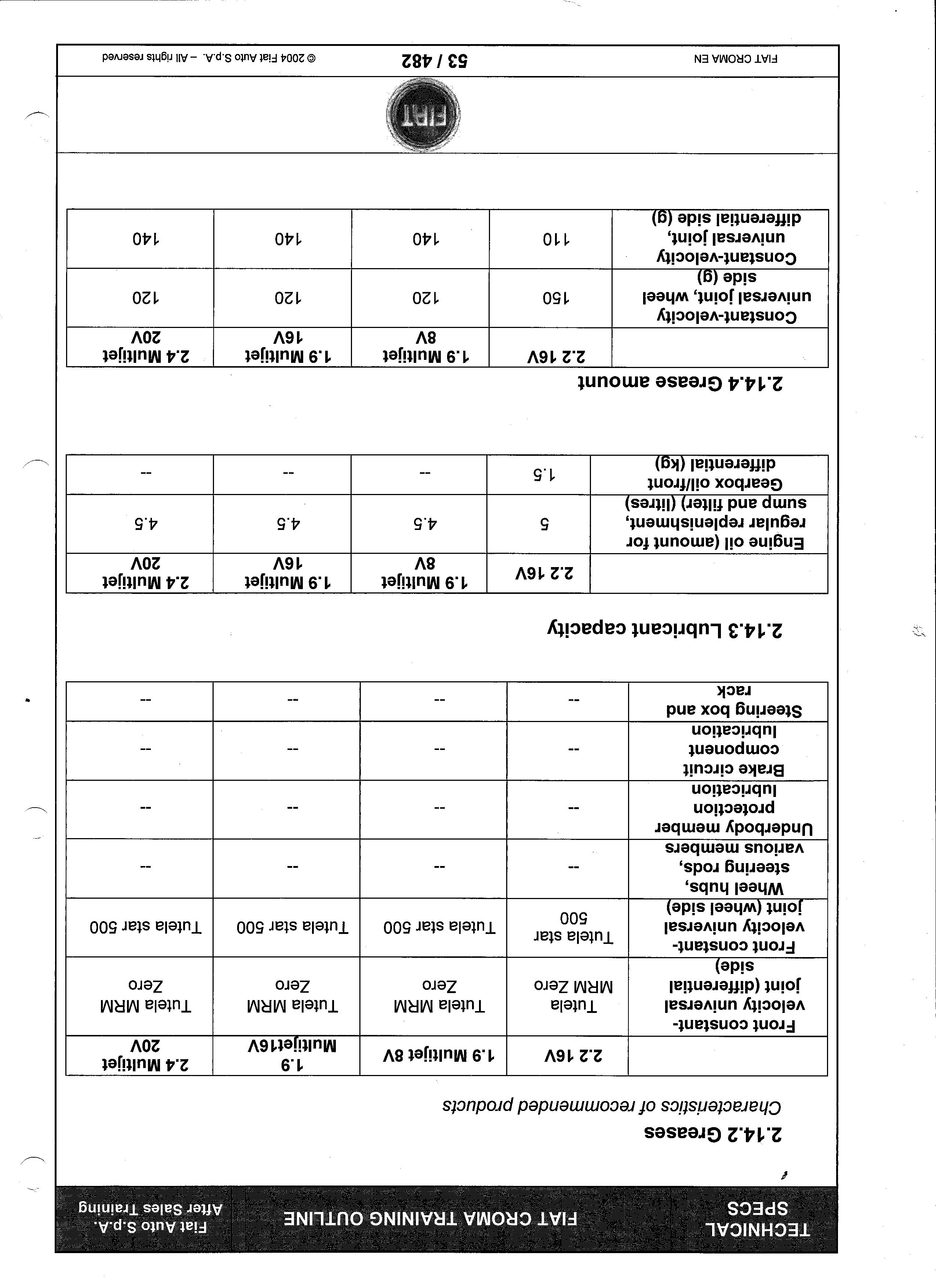

Doofer-- I have the training manual that was issued to Fiat mechanics who were sent to Italy to be trained in 2004 (pre launch) so they could pre delivery check the cars. I got it from E Bay for a song. It shows that the the grease spec is Tutela MRM Zero for the "Tulip" CV- amount 140grms and Tutela star 500 for the wheel end CV- amount120gms.
To have such tight amounts specified for each CV shows to me that they must have been thought about during design& testing for torque steer elimination. It is quite understandable that the grade of grease would differ when you think about the heat generated by the brake disc and the resistance to it required by the CV grease at that end. Incidentally the spec amounts for the 2.2 16v petrol are 150gms for the wheel side but 110gms for the Tulip CV, the types of grease are the same however.

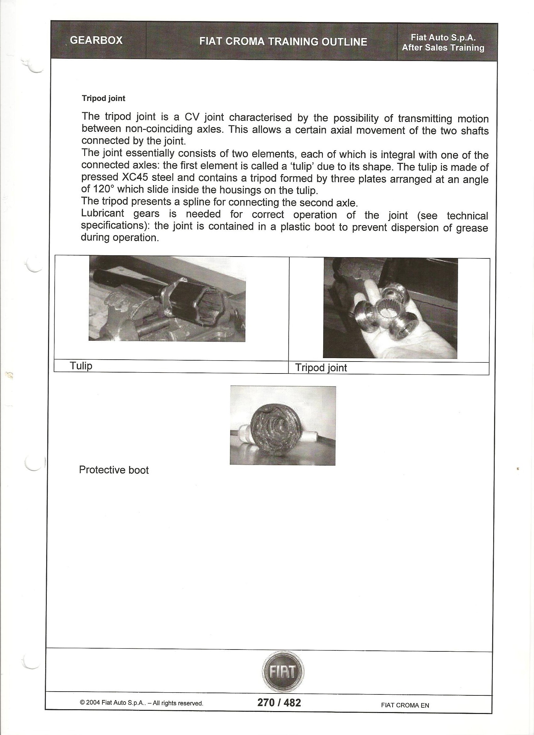

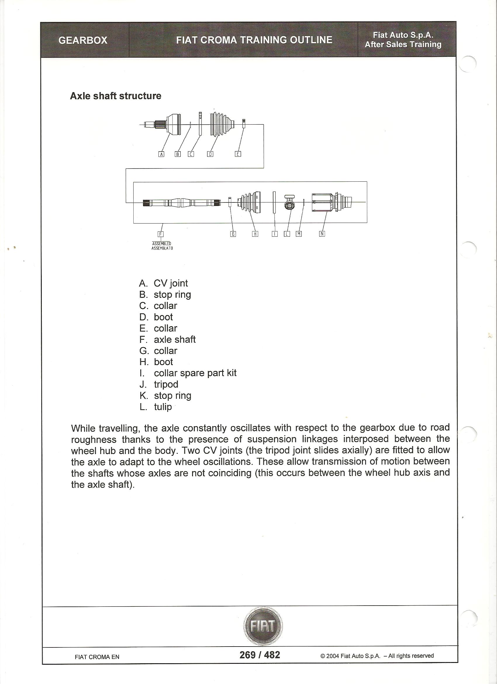

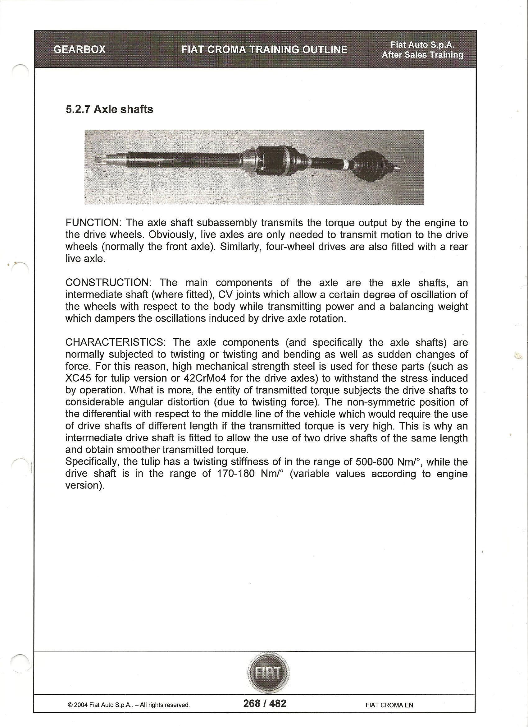

First go chaps hope they are ok for you, I will do the other one you wanted Doofer if these are ok. As you can see the letters on the schematic sketch do not match the Key below it but its self explanatory anyway

Bloody amazingly brilliant, thanks. That gives us a few bullets to fire at the recon company - I have in mind that we should ask them how many ml of what grease they used - I'd bet it was a finger-ful of "the usual stuff".
It may be that the (very helpful) mechanic at the garage can empty/clean it and refill with the correct amount of the right stuff. I don't know how practical this would be though.
