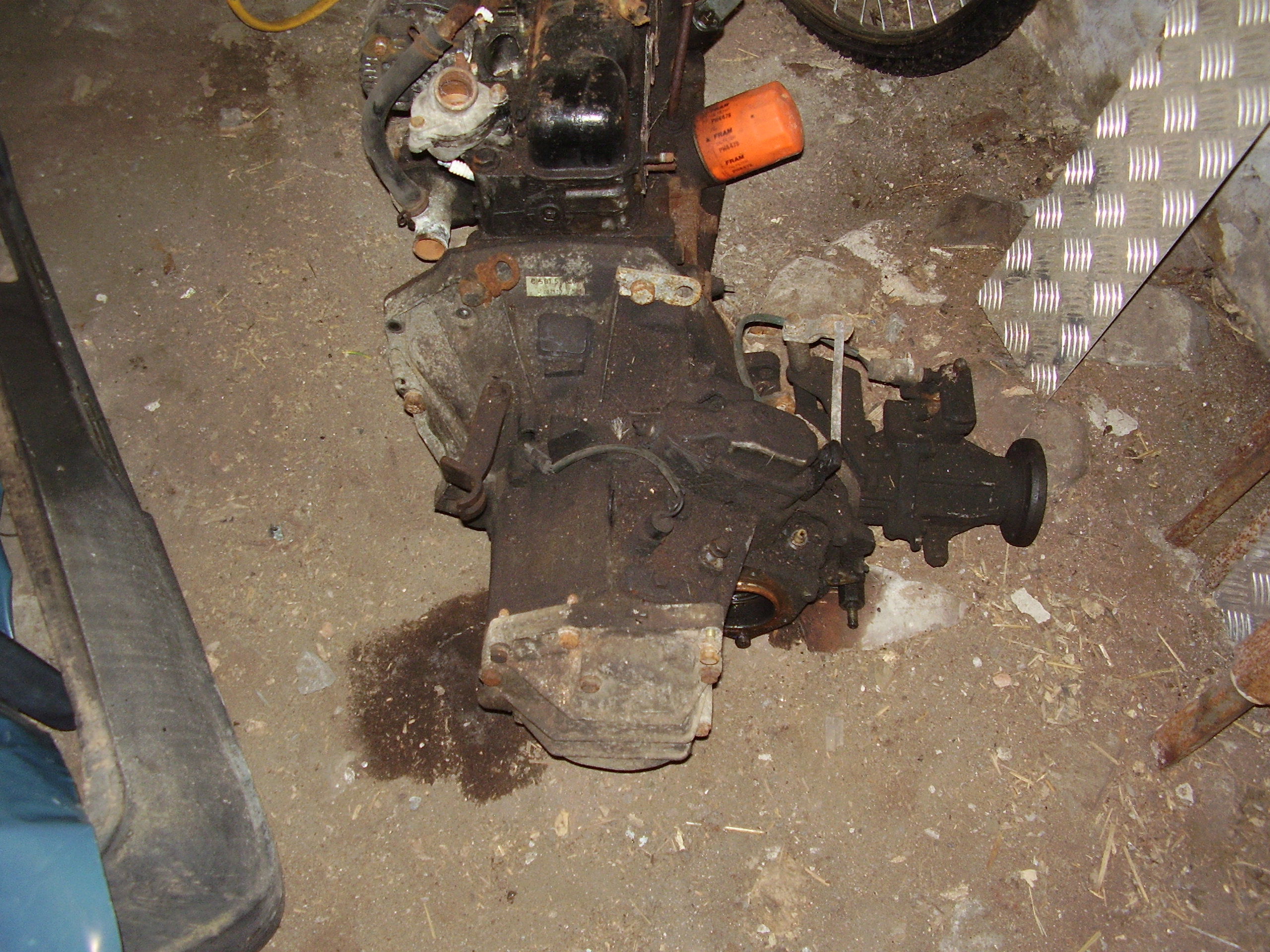

Does anyone know if the front passenger side driveshaft on the Panda came in different lengths? Looking in the Porter manual there seems to be variations in the track on various models and I'm wondering if there were different lengths of driveshaft?
The reason I'm asking is because now that I've driven the 'Rat a rather serious problem has showed up: the passenger side drive shaft keeps popping out at the diff. Draining out all the brand new oil I just put in it yesterday (ouch
) and removing the gaiter I can see that it doesn't go into the diff far enough. Or could the suspension geometry of the MK1 and MK2 Pandas be subtly different?
I'm really hoping all I need to do is get a drive shaft from an earlier Panda (as this kit was based on MK1 Panda parts). Failing that, any idea how much it would cost to get mine modified to make it longer?
EDIT: Just went back out to the garage and undid the driveshaft at the hub so I could slide it into the diff. Made some rough measurements and I reckon it needs to be at least 15mm longer to be 'in safety', but 20mm would be better.
