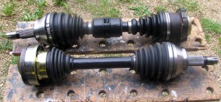

Then it was on to the halfshafts. Offside one first. Part assembled, to give an idea of what goes in to one:
Slide the gaiters well on to the shaft to get them out of the way while you get the CV's in place. I took a bit more time to lay out all of the bits for the nearside shaft,
to give a better idea of order of assembly. Purdy. Shame it's out of focus:

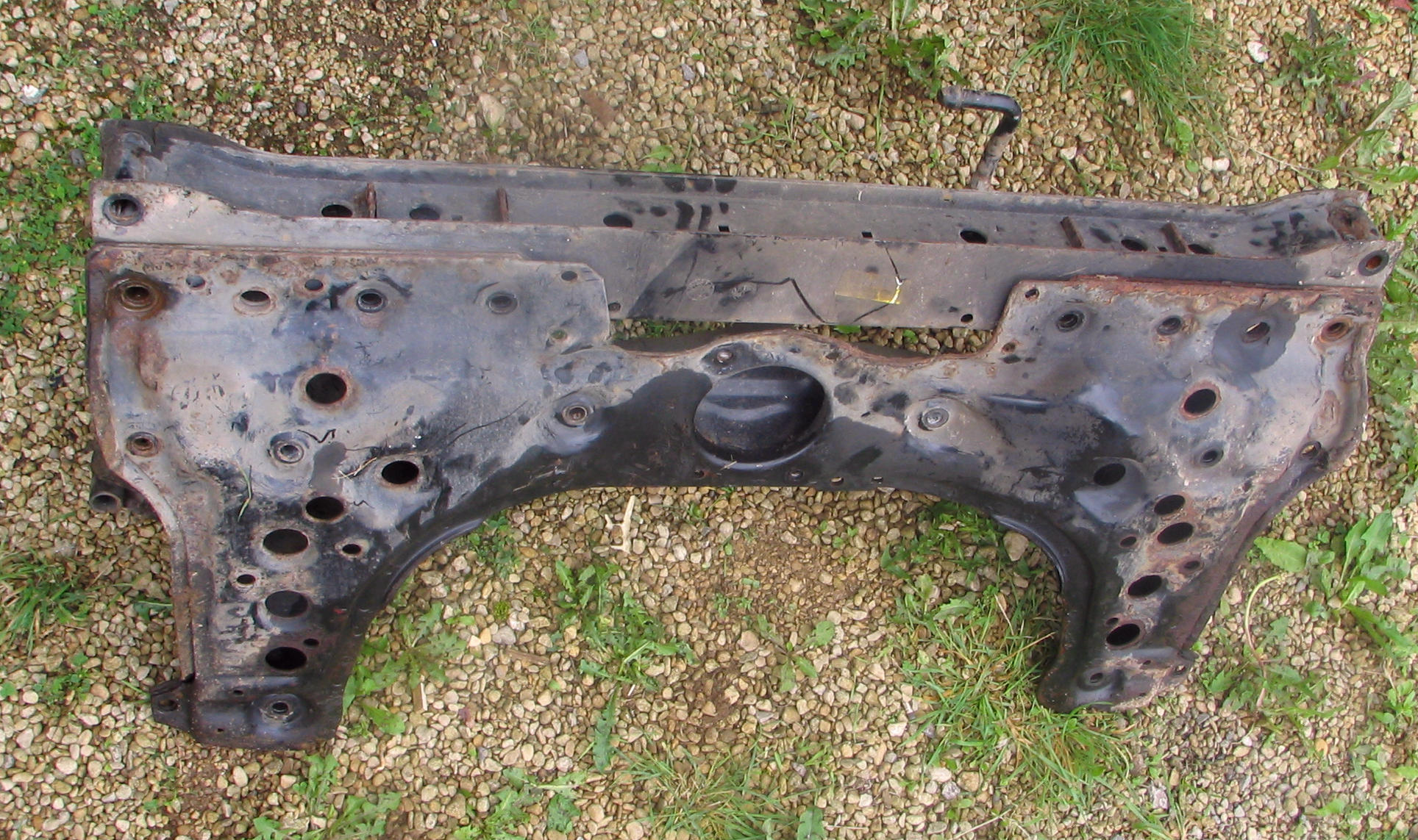

Took it down the road to have it shotblasted this morning :D. Looks to be in very good nick actually - just some surface rust on the underside where the
main pressings meet the box section that runs across the back.
Looking forward to getting this back all cleaned up and ready for some more Rustbuster lovin'. Will need to spray the internals with a can of Dinitrol and a wand
I think.

He's done a nice job. I'm impressed by how little corrosion there is (now was). The steel is generally in almost perfect condition with only some minor pitting on the underside/leading edges of the outriggers. I spent a while with a powerfile zipping off some pretty sharp flashing around spot welds and a smattering of weld spatter, then rounded off as many edges on the pressings as I could get at, so that the paint wouldn't go thin on them. No pictures of the painted subframe yet, but the Rustbuster covered well. It was cooler today and it didn't flow quite as well as last time I used it - when it was hotter - even though I added some thinners. My best tips for getting a smooth finish are: apply it on a warm/hot day, use a long (longer the better) bristle synthetic brush, lay it on quite thick and don't brush it out much. It finds its own level quite effectively if you don't mess with it. Other news:

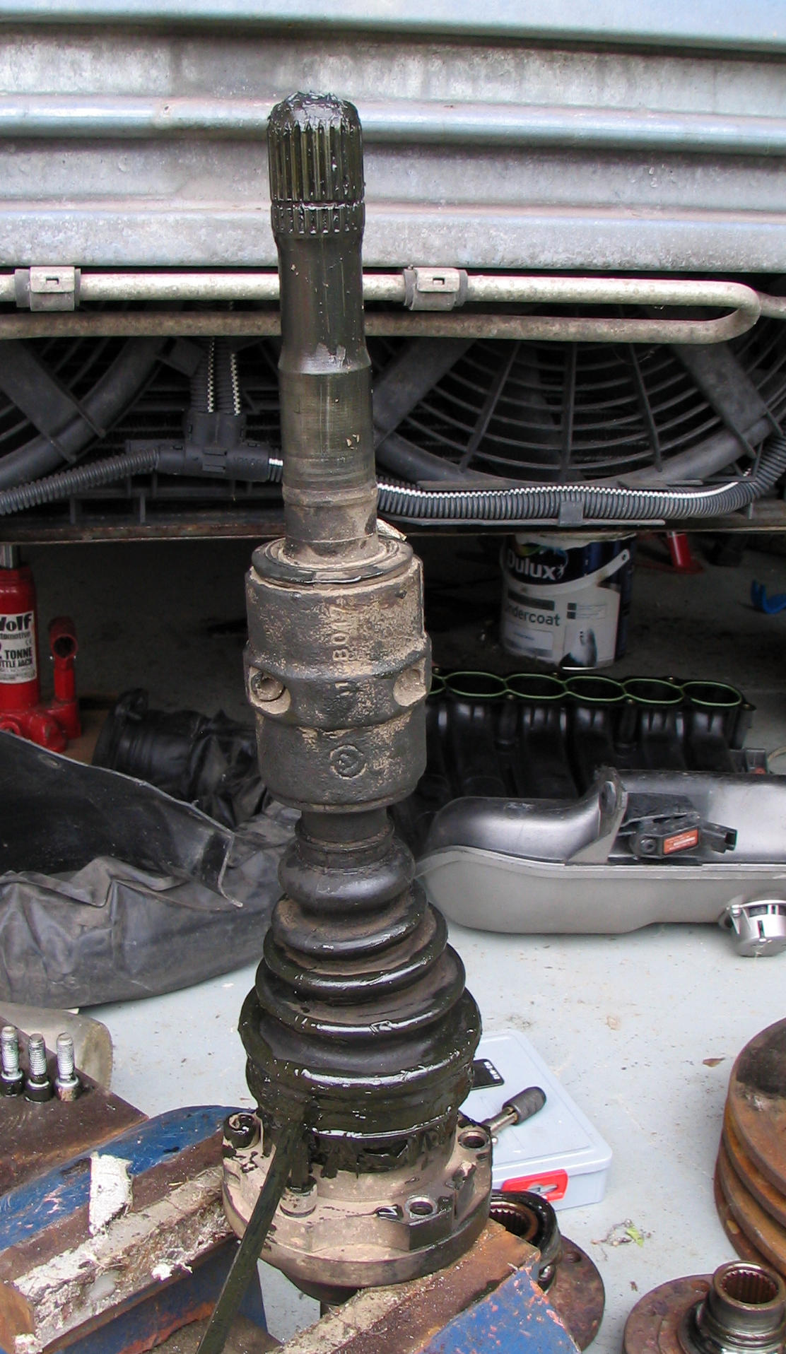

As forestryman pointed out, there's a round wire clip in a groove in the splined shaft that goes into the nearside of the diff. The clip had distorted so that it couldn't seat properly in the groove so I couldn't push the shaft back into place. So I stripped the nearside halfshaft down:
(IMG_7680)
That's the outboard end of the halfshaft at the top. I' had already removed the outer CV joint by the time I took this picture. The groove in the splines take a square wire clip that holds the CV joint to the shaft. The lump in the middle is a ballast weight (probably there to dampen harmonic vibration); below that is the boot for the inner tripod joint. I had already rolled the boot back to have a look at the condition of the tripod - so there's a fair bit of joint grease floating around. I was expecting to just be able to pull the tripod out of its housing, but it's not possible because there's a very small lip at the outer end of the housing that stops it. At bottom of shot is the flange joint between the half shaft and the inner stub that goes into the differential. I'm in the process of removing the 6 screws in this shot. Note the thin metal tab you can see between the two holes on the RHS that have already had the screws removed. Once all 6 screws are removed:
(IMG_7681)

The halfshaft just lifts away. Not much to see; however I could now take the stub shaft (the bit still in the vice), refit the round wire clip to the splined section (obscured by the vice in this shot) and shove it back into the diff. It went back into place nice and easily (unlike last weeks effort).

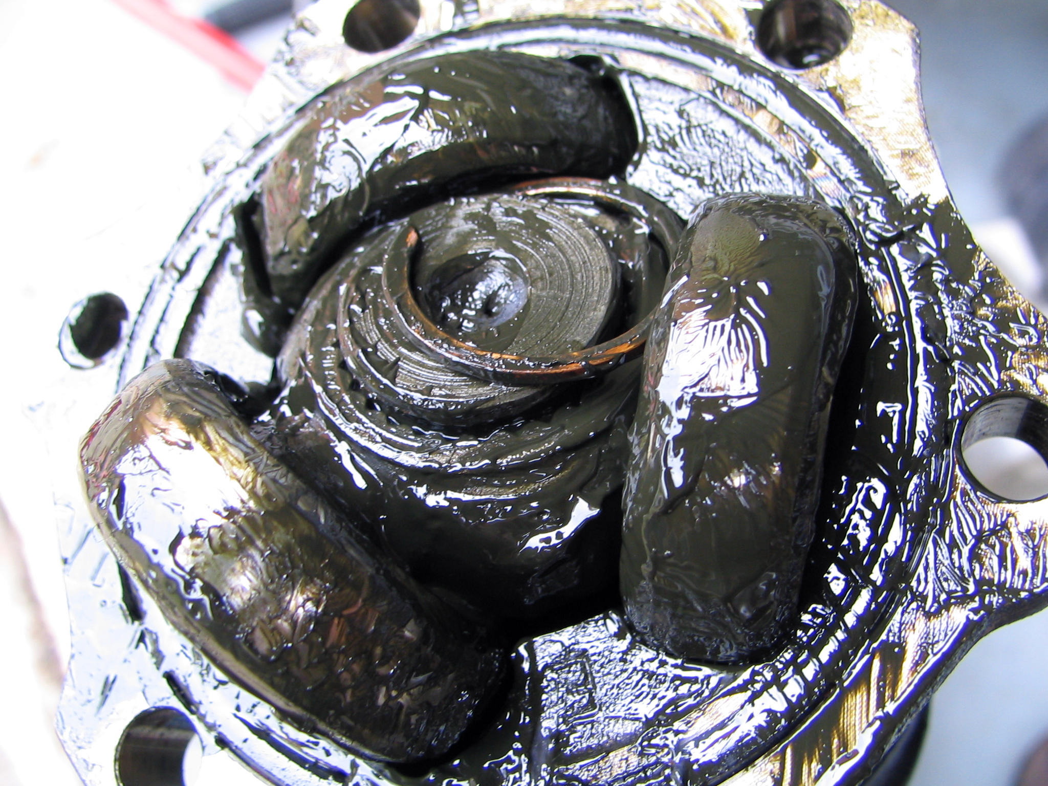

On the halfshaft you can now see the plated sheet metal pressing that closes off the inner end of the tripod housing (sometimes called a tulip). There are three tabs on the edge of the pressing that are folded around the housing. Gently bending these away from it allows you to pull the pressing off, to reveal:
(IMG_7682)
a nice gooey mess. Stripping these joints is a filthy job. Have lots of rags to hand, a dustbin liner to drop the used rags into and wear some tough rubber gloves. Wiping some of the grease away and pushing the tulip down the shaft reveals a clip seated in a groove in the halfshaft:
(IMG_7683)
Ping this off (make sure you catch it as you'll need it later) and then pull the tulip sharply up a few times to tap the tripod off the shaft. Everything can then be cleaned off and inspected. That's about it for the nearside shaft. Hopefully I'll be fitting the new outer CV joint and tripod tomorrow.

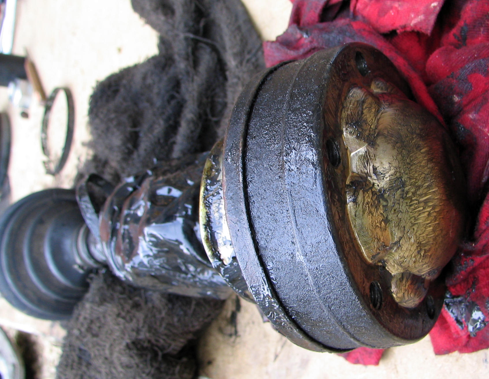

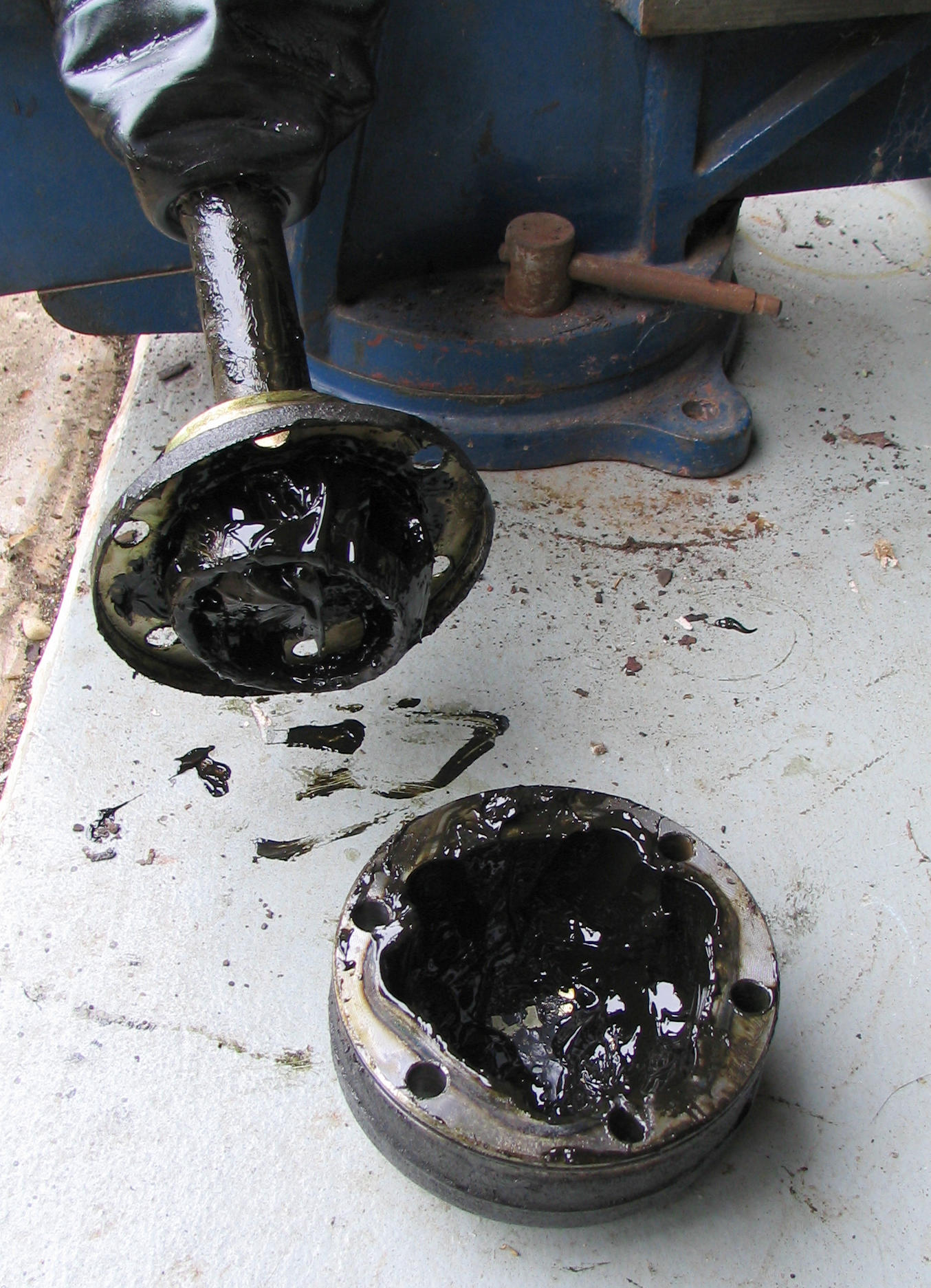

Things are a bit different on the offside. Because there's a fixed jackshaft running from the differential, across the back of the engine to a fixed bearing below the alternator, Fiat didn't fit a tripod/tulip joint like the one on the NS. Instead, there's a very clever (well, clever to my eyes anyway :) ) variation on the Rzeppa CV joint that not only allows the shafts either side of the joint to articulate, but also to plunge, whilst at the same time retaining the ability to transmit power through the joint without variation in angular velocity (in other words, the shafts turn at the same speed no matter what the angle between them). Its build up is a bit weird though and it's covered in just as much gunk as everything else joint-related:
(IMG_7685)
Looking at the state of the grease in this one, I think it could be where my clicking noises were coming from. The pressed metal cover is also mishapen. Not my doing (honest :) ) - it looks as though someone has been in here before me. To give you your bearings, if you can excuse the pun, the shaft going out of bottom left of shot would go to the OS wheel; the thing on the red rag is next to the jackshaft bearing when it's all fitted to the car. The odd looking thing towards bottom left is the rubber boot peeled back on itself to give better access. Again, the joint doesn't just pull out of the housing. It's not particularly obvious how to get this one apart.
(IMG_7686) & (IMG_7687)

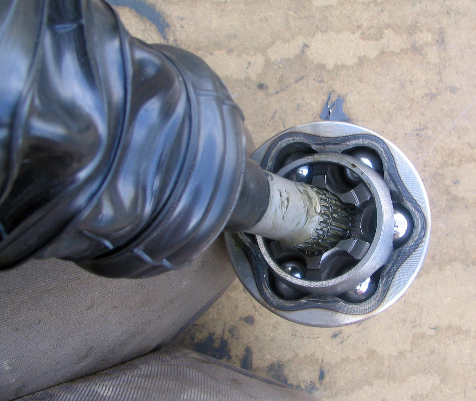

I guessed and started tapping at edges of cover pressings to see if anything would budge. Which led to this:
(IMG_7689)
In the course of pulling it apart my balls fell out. In the interest of public decency I'll not post a picture :yuck:, but once I'd picked them up and cleaned them off, I was left with this:
(IMG_7690)
Remove the circlip and the CV joint assembly just slides off the shaft. In striping this joint, it all looked vaguely familiar. Sure enough, when I went rummaging through my boxes of parts hoarded for the Multi, I found a new CV joint that I must have bought some time ago on a vague promise that it would fit. I think I bought it from ebay, but I can't remember which seller. It's not a J&R one as they don't sell the inner ones.

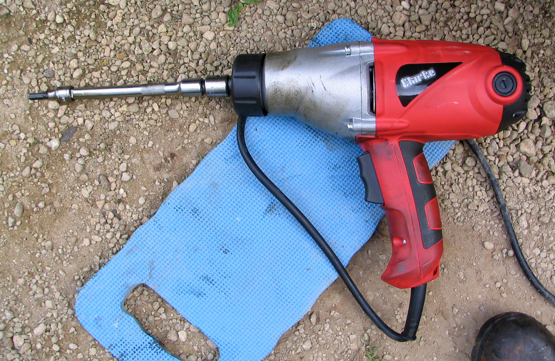

An honourable mention should go to this thing:
(IMG_7688)
For not much money (about £60, plus another £40 for a good selection of impact driver sockets, up to 36-38mm AF) it gives you an impact driver to rival the power of a professional air impact driver, but without the need for a compressor. It undoes staked wheel hub nuts in seconds (it's best to tap the staking out a bit first, if you can, just to avoid any chance of damaging the shaft). It is way more powerful than the cordless ones I've tried. Just bear in mind it's quite heavy, a bit bulky and of typical chinese build quality - robust enough, but not the last word in finish or refinement. That said, it's very controllable and it won't try to rip itself out of your hands when you press the trigger. It wouldn't stand up to the rigours of full time use in a garage, but for the few minutes of use it'll get from the average DIY'er it's great and I've yet to find a stubborn nut it can't undo. Joins the ranks of the Meek Shall Inherit the Earth tools for weeds like me, along with my 750mm breaker bar :D

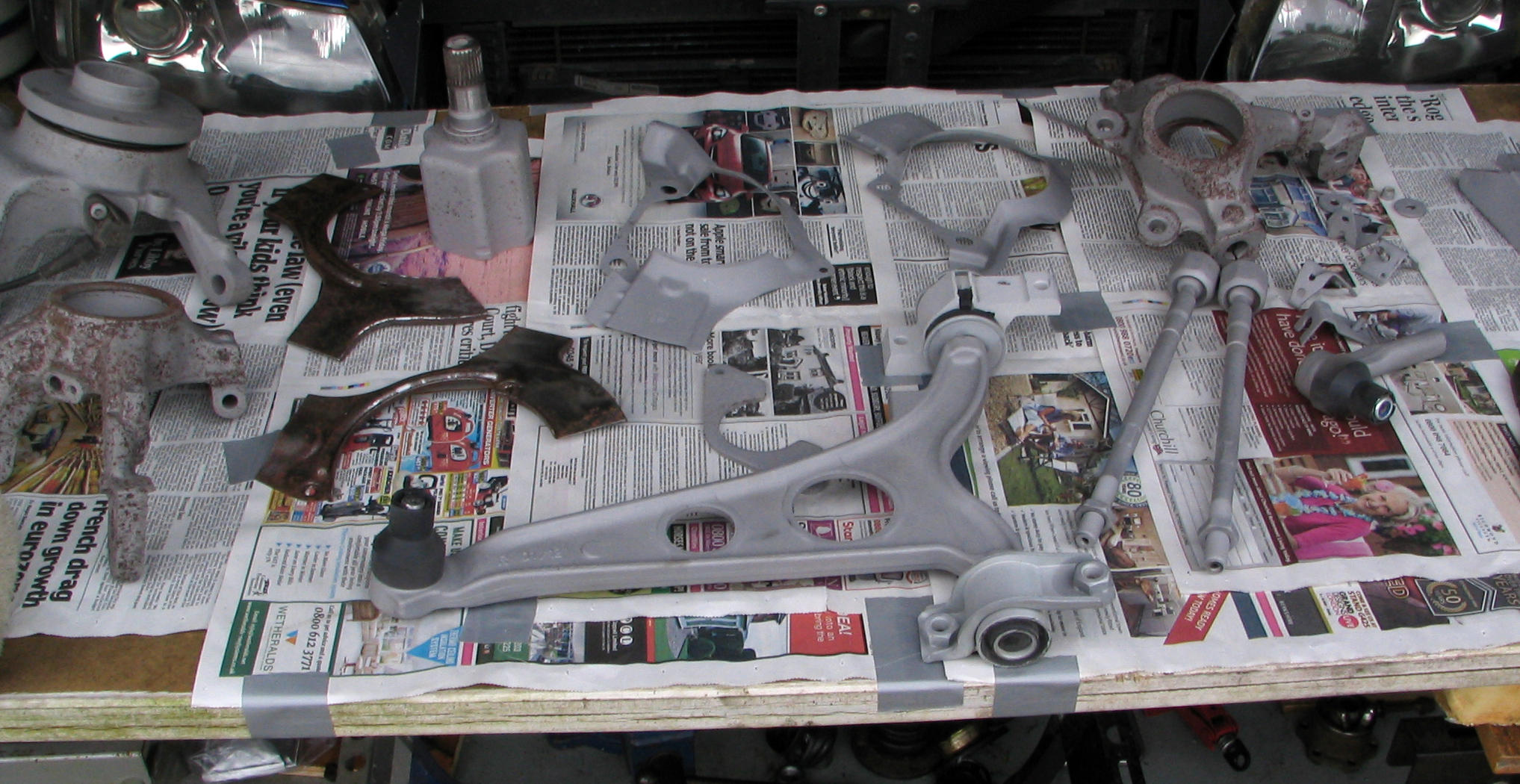

OK. My war against shoddy, crap parts for the Multipla continues. You'll recall I've bought some new front wishbones and I've dusted off a few of the other bits I've gathered over the past months that were being amassed for a major rebuild, but time (or the lack of it) means I've only been able to do the urgent jobs needed to get the Multi back on the road. I've also noticed that almost everything that I've replaced with new parts over the years now has a generous covering of rust and crud and is generally unpleasant to work on. Sooooo.......
I started cleaning up/stripping all the bits I've been working on (even the new stuff like the wishbones) to get them ready for painting with something that will hopefully Laugh In The Face Of Road Salt and Rust in equal measure. I started off with a selection of wire brushes and cleaning discs but wasn't happy with the results on most of the parts. I gave up with that, gathered together all I could find and headed to a shot blaster a few miles from me. He's got a decent reputation and does lots of stripping of classic and vintage car body shells (including aluminium ones) so the selection of bits I put in front of him gave him no headaches. Three days later, my boxes of manky, greasy old car parts were transformed into sound, monotone, clean pieces of loveliness.
(IMG_7732) & (IMG_7733)
It is so much nicer building stuff up when it's in this state. He used soda to clean it all up and I was impressed by the results. For £70, he cleaned 4 brake discs (2 of them for the Multi), the two new Lemforder wishbones, the Bilstein struts, 4 front hubs (again, 2 of them for the Multi), a new radiator support bracket, 4 drive shafts, 2 caliper carriers, a pair of new Lemforder tie rods and track rod ends, 4 brake disc guards and sundry other small brackets. It would have taken me a lot of time (and wire brushes) to get anything close to the results he produced. Bargain. Then it comes to the paint:
(IMG_7731)
I bought a the POR 15 trial kit, but then started hearing mixed views about it, so got a Rustbuster kit which has very good reviews. It's an epoxy two-pack paint that is purpose made for chassis and suspension parts. Mix adhesive (black) and hardener (typical epoxy greeny-grey colour and smell) in equal measure, add a little thinners to make it flow more easily, leave to stand for 10 minutes and then you're good to go.
This stuff is more sticky than Mr Sticky the stick insect hiding in a pile of sticks. Wear rubber gloves! The soda-blasted surfaces are just about perfect for applying it to. I used a cheap disposable bristle brush so I knew I shouldn't expect a perfect finish, but I'm pleased with the results. It has a reasonable pot life (I was applying it for the best part of two hours before I could feel it starting to cure) and the build is excellent - it has a very high solids content. It feels stiff in the pot, but once you start to brush it out, it flows into every little seam and pore. Perfect for something like struts, where there are gaps dips where sheet metal meets sheet metal.
(IMG_7737)
I've left it to cure overnight. Hopefully it won't have done anything nasty like producing a bloom by then. I could handle it (carefully) by the time I packed in this evening. It has an appearance and feel very similar to a thin(ish) plastic dip coating. Looks promising. Practical Classics had this stuff on test outside for three years and it finished with top marks.

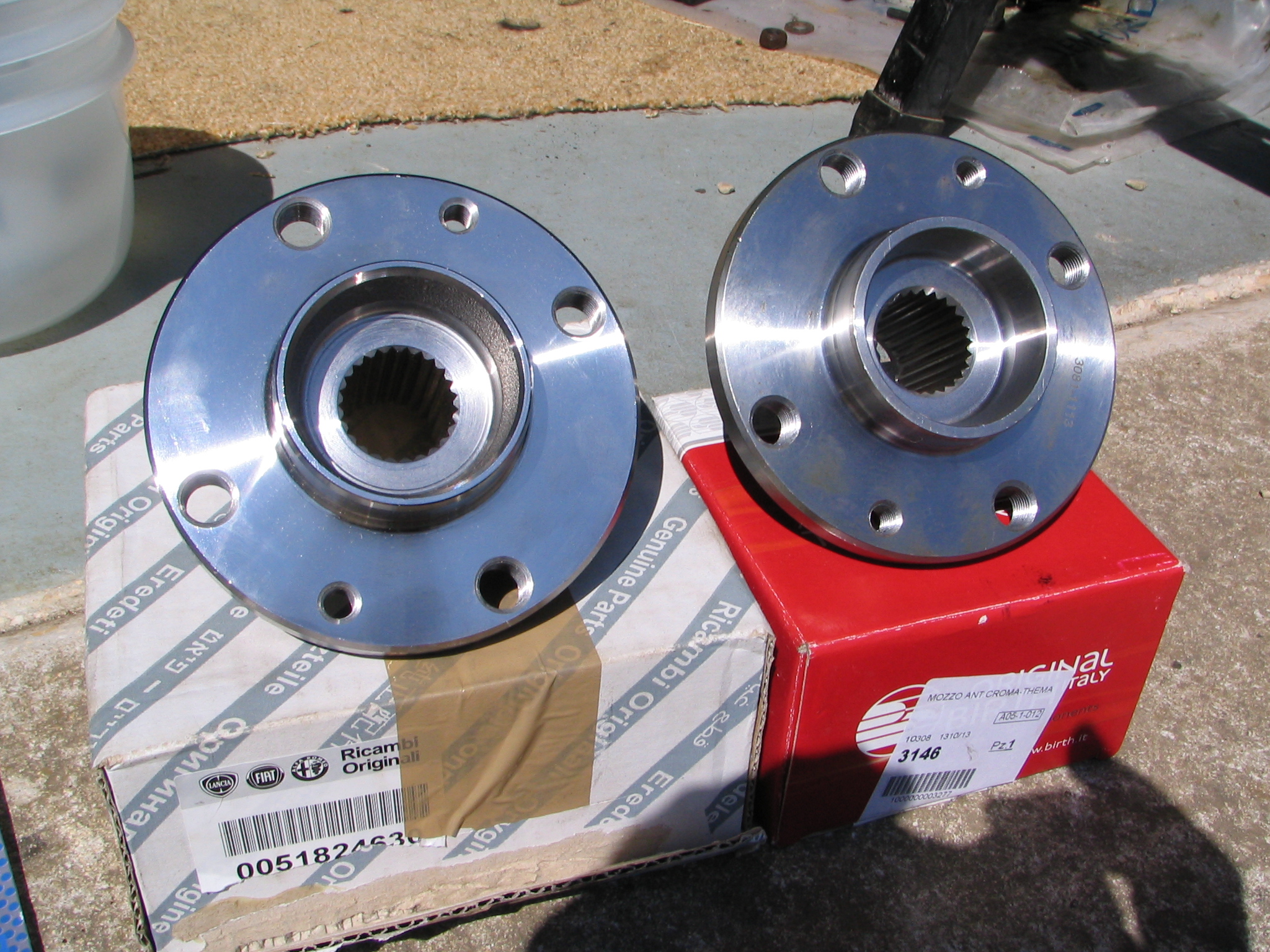

Not had much time to work on the Multi recently, but did a bit more last Saturday.
Hubs: Not at all happy with the quality of the Birth ones, so set about sniffing out proper Fiat ones on the cheap. Gratuitous piccy:
(IMG_7741)
I think the part numbers are just about readable for both. The OEM ones are spot on and a very nice fit for the J&R CV's.

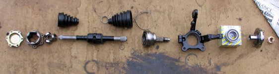

(IMG_7753)
(IMG_7754)
