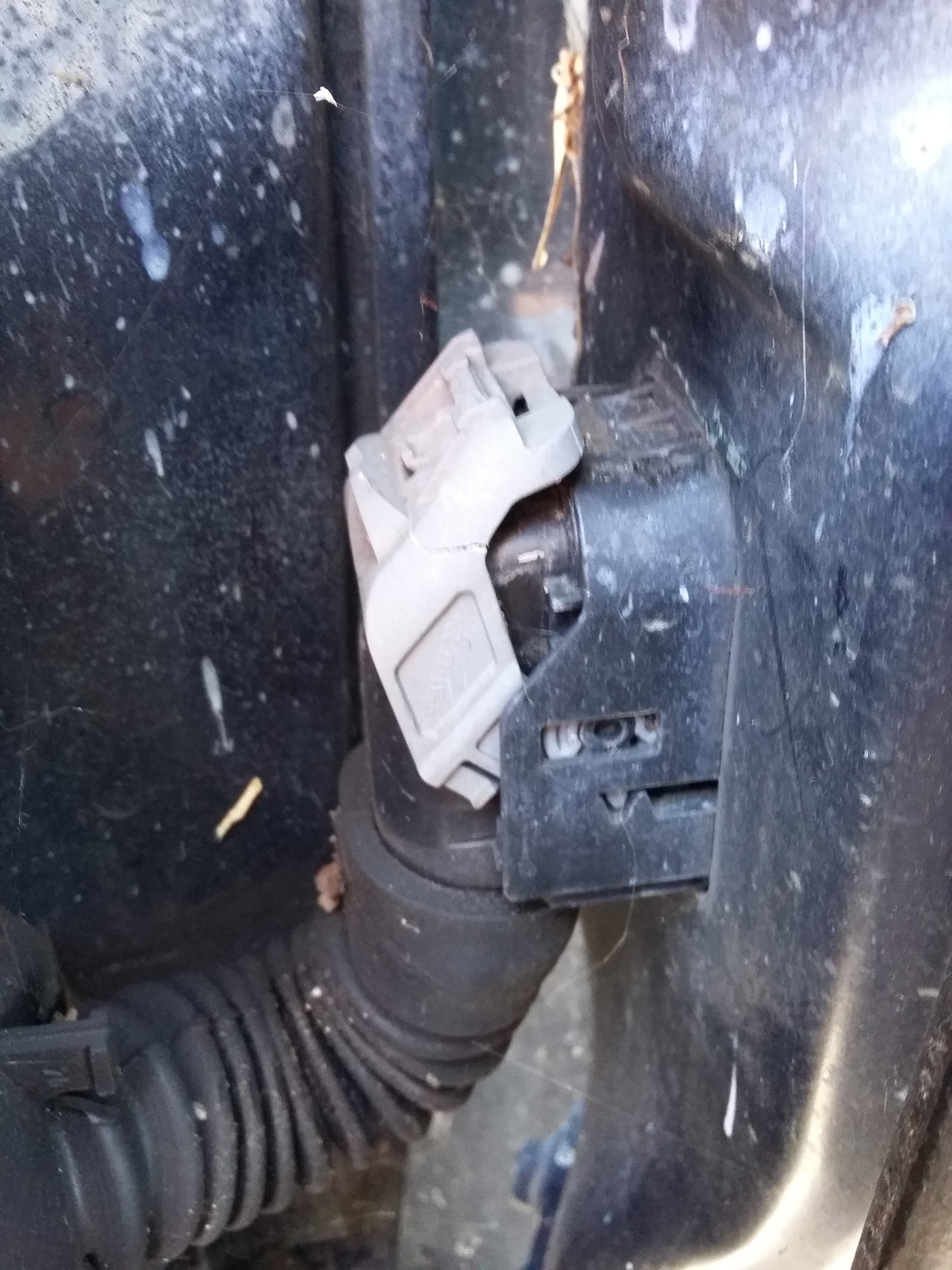

Hi Tim,
More likely to be a fractured wire at the hinge joint
Thanks for that thought. It sounds like a bit more of a hassle to fix than a fuse. 😢
Fuse would most likely stop all windows.. 🤔
It's quite easy to peel back the rubber Gaiter looking for broken wires.. 🙂
Mine was a mess, 2 broken and 3 chafed 😔
Ok. I'll take a look next time I see her. For now she will just have to open the passenger window if the sun comes out again. 😁
