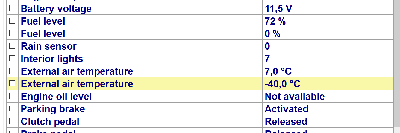

Just made a regen when driving, temp at apx. 630 degrees. shows 25% clucked. DPF. No error codes.
But i have two temp sensors and one shows -40 degrees. Is there not only one extirior sensor ?
I know that the extirior sensor can make som trubble with the DPF.

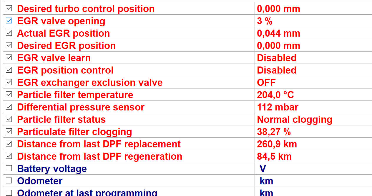

Next, in line. The EGR is not closing when engine is idle, And a bit off from desired poaition.
Se photo.

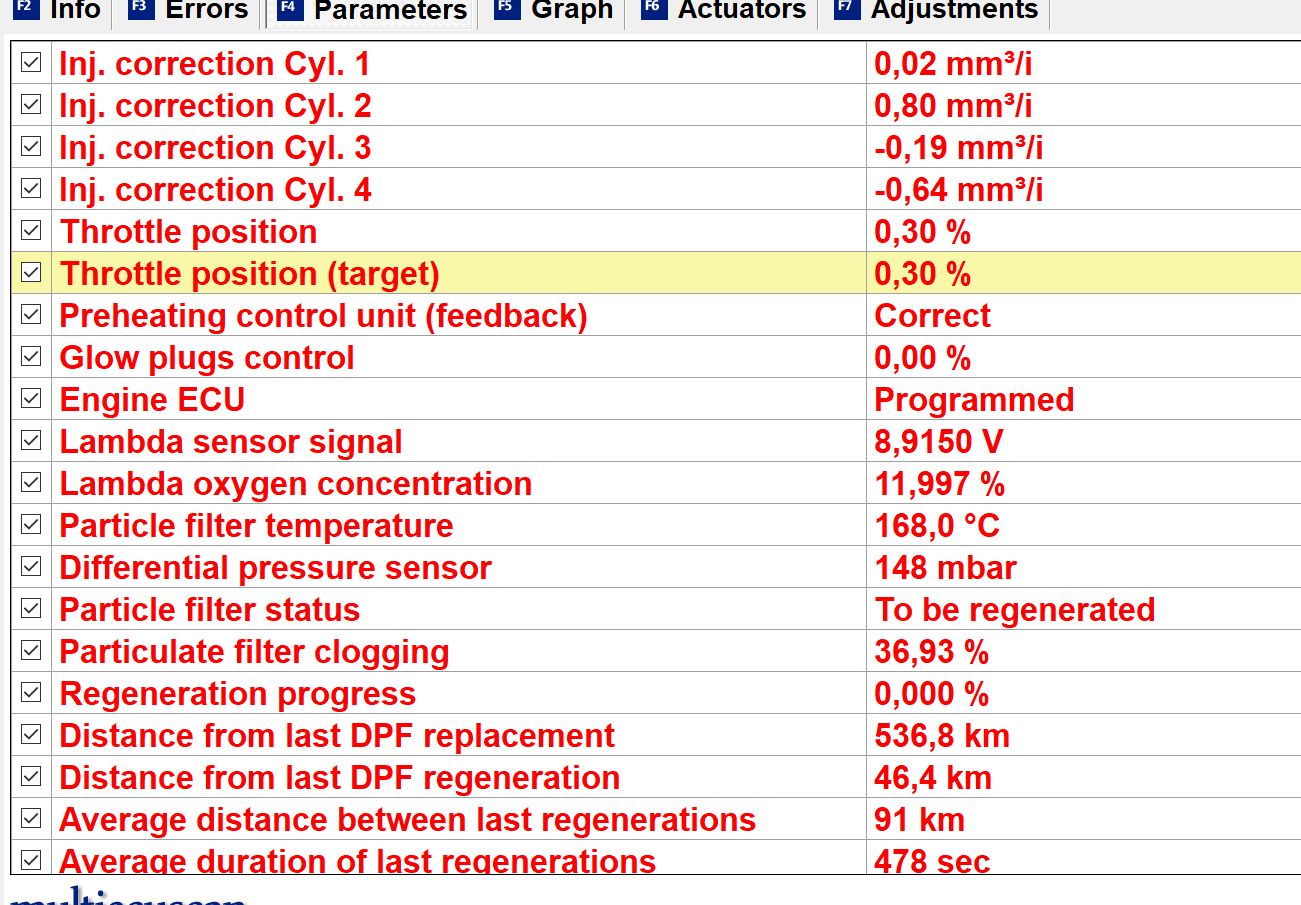

What sould the injectors correctors values be?

I only see that the EGR not closing 100% when idle and the DPF is cluging up fast.

Are checking if the injectors are programmed correctly.
After a regen it says that DPF is about 25% clogged, 20-30 mbar, is DPF done?
EGR, is slitley open at idle, when coold or hot, when making test, says OK, can i test it with a multimeter?
Speeder pedal prosition says 0.9-1.2%, should it be understood that there is something wrong with the sensor?
What parameter do i have to look at to finde the reasons ?
