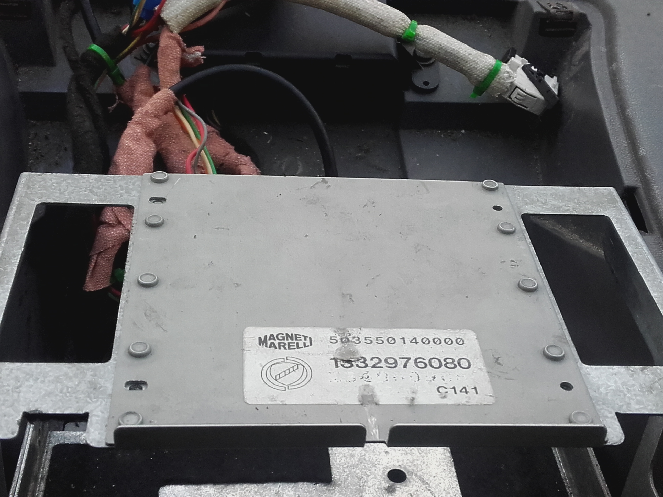

Yeah mate,theres a metal cage that the headunit slides into,'im about to whip mine out so ill send you a picture.....I'm trying to fit a connect nav+ with reversing cam from an 03 ducato to my 03 relay its doing my head in.i saw a ducato in the scrappie with the whole system in In my haste I took the headunit and camera thinking it would just connect upbut I'm having real difficulty suessing it. Ive since been back to scrappie got mic's aeriels wires etc but i think im missing a few bits

Check this out

Hi, thanks for the pics.
