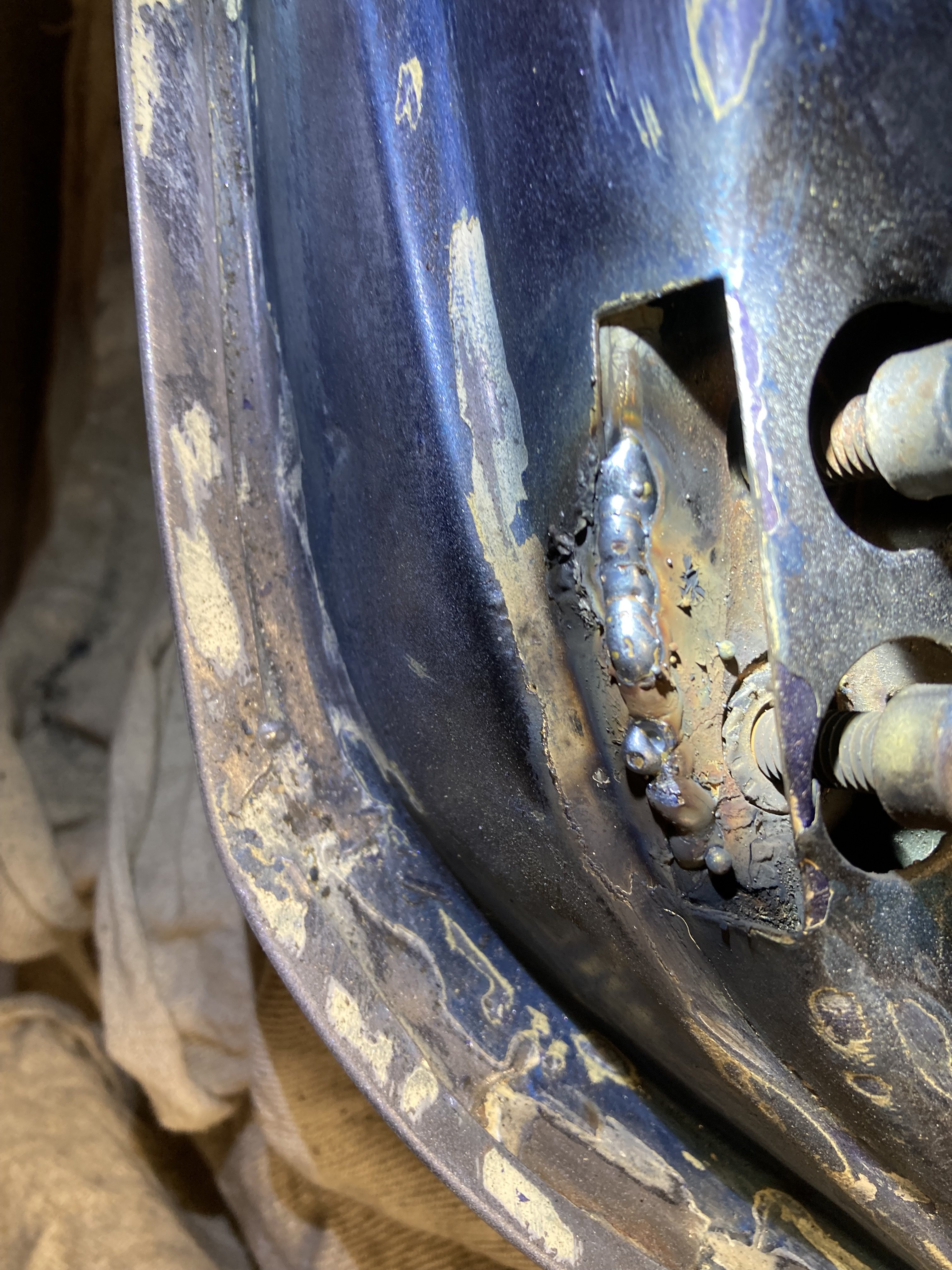

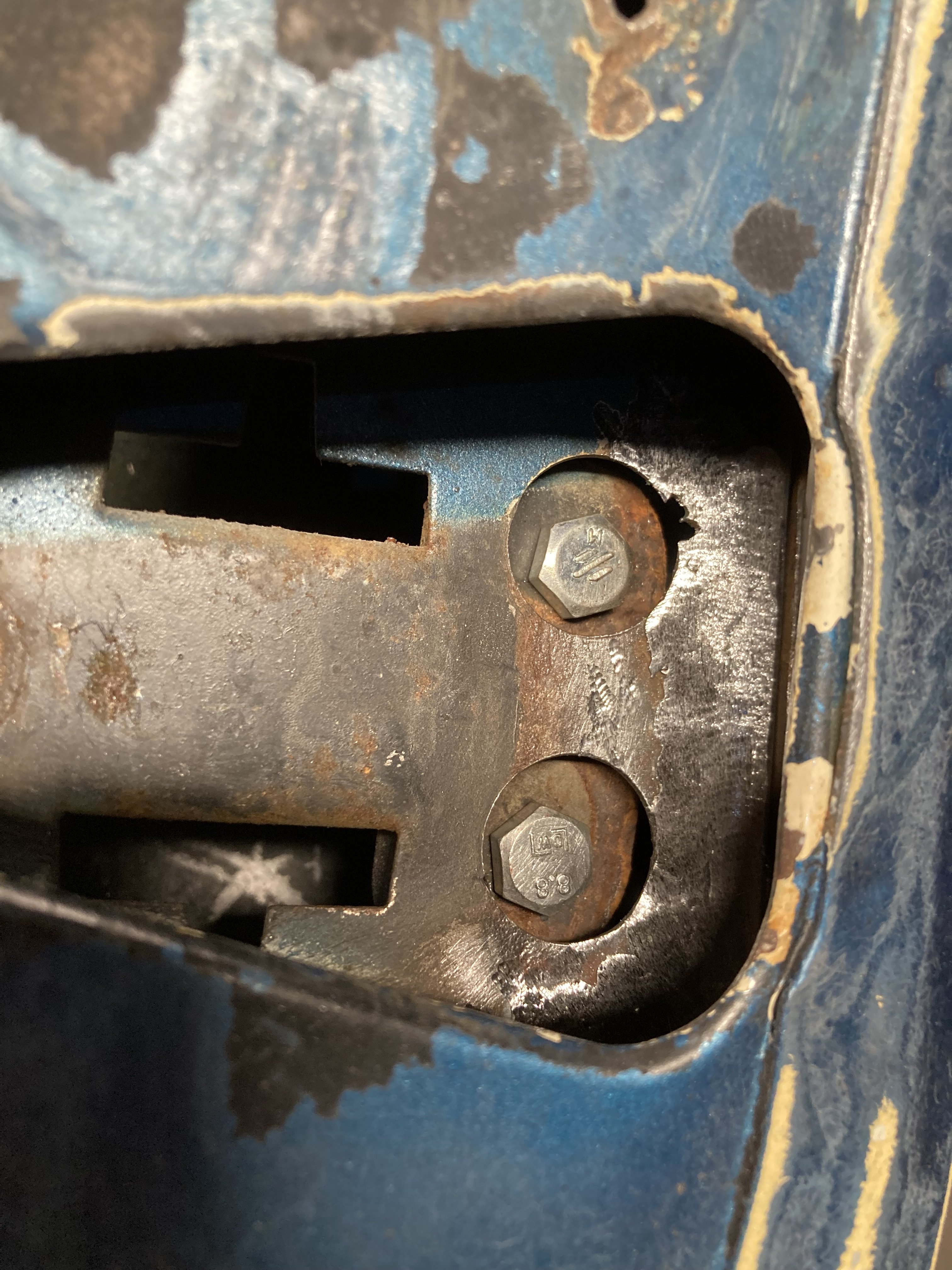

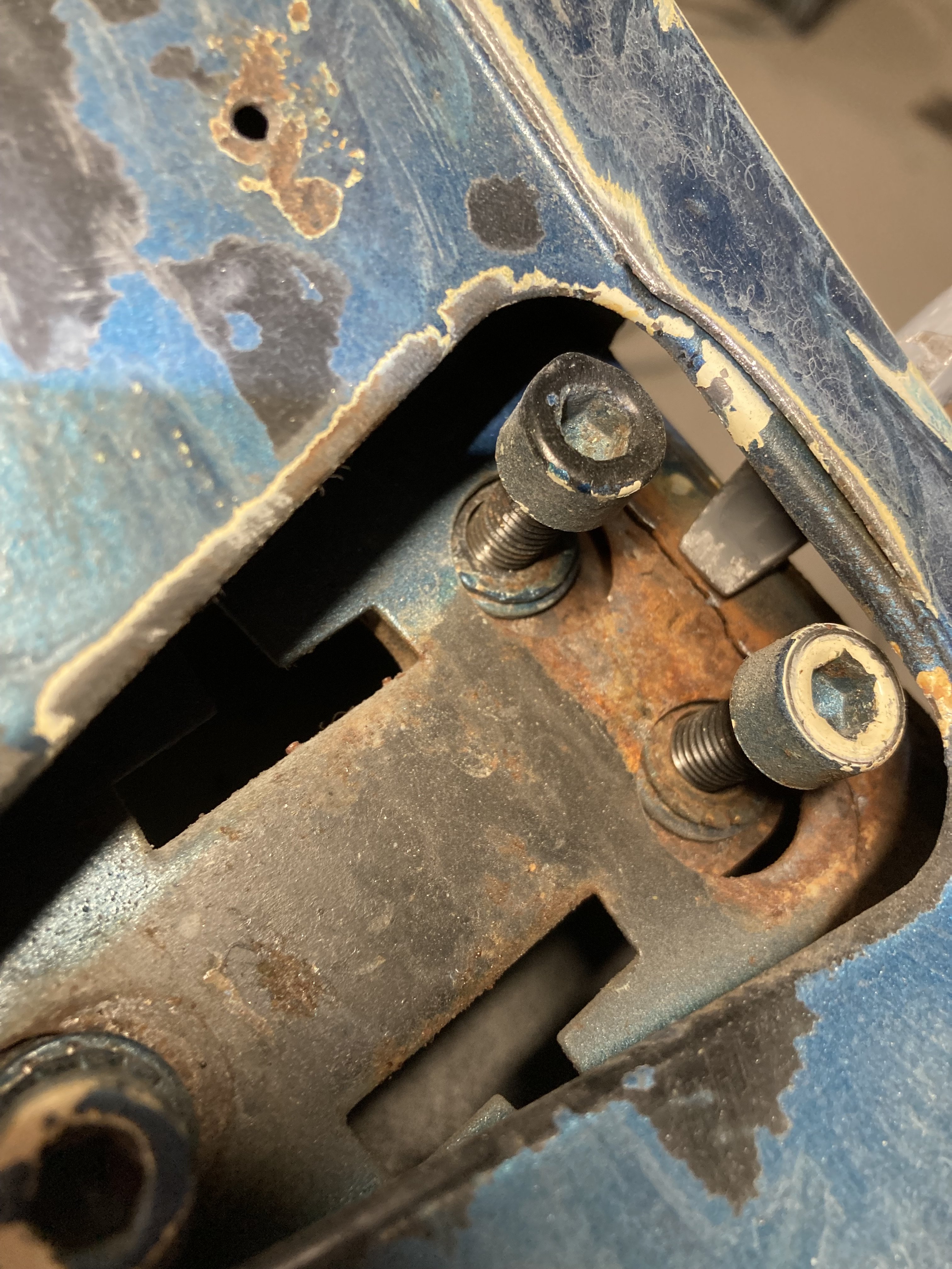

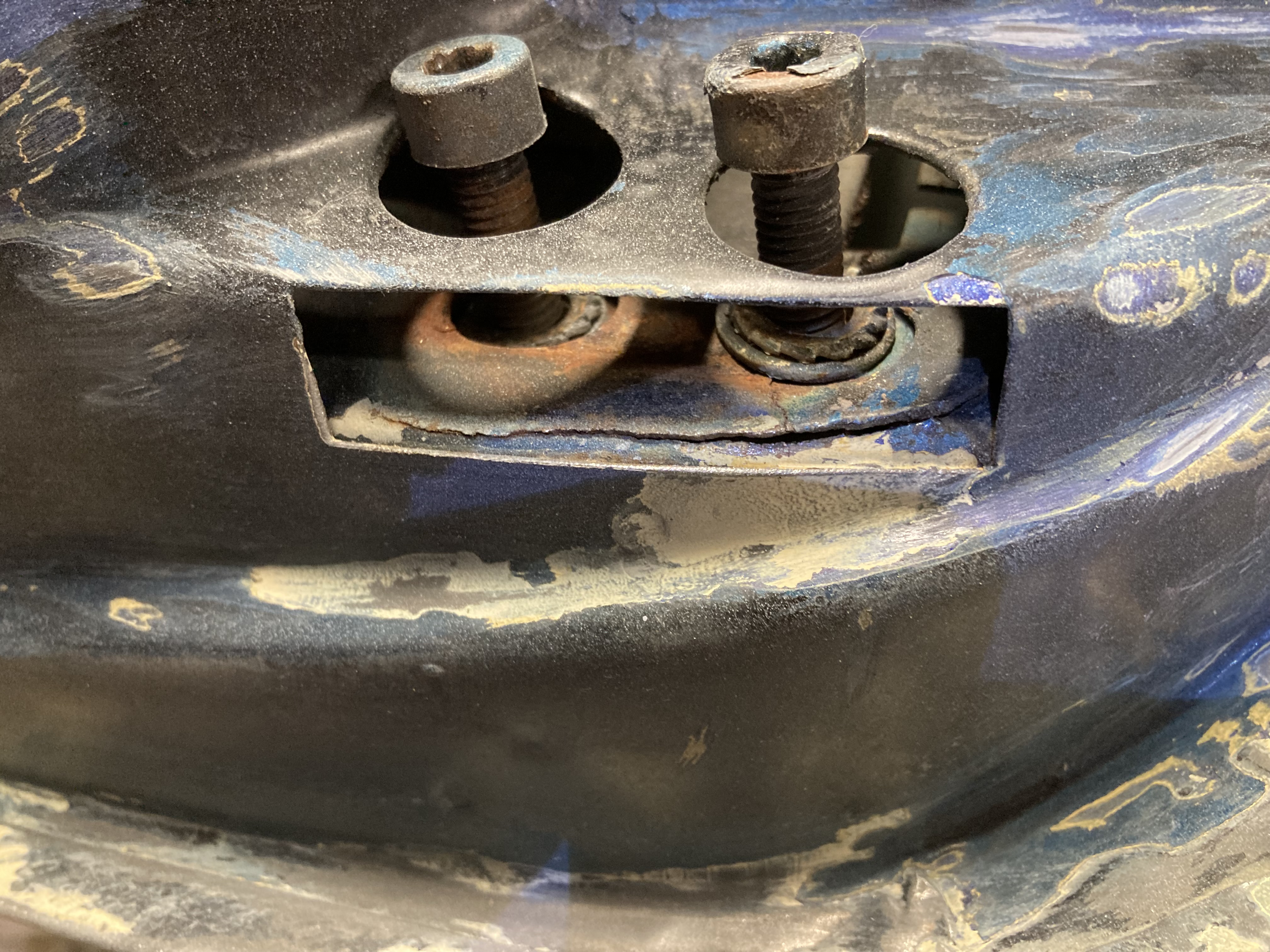

This is a bit of a follow on to the thread on doors dropping
That assumed mostly good Integrity of the hinges and mounts
Having been reluctant to take the doors off my car I am now glad I did. 3 out of 4 hinge mounting pads in the doors had fatigue cracks, not suprising as the doors are really heavy!
Top and bottom hinge pads were cracked, the hinge pins were ok but the forged hinge plates were worn from lack of lubrication.
Both are tricky repairs as the steel isnt very thick and you dont want the weld to blow through to the reverse side as this will interfere with the captive sliding mount plate
Here are some photos before and after.
The lower plate repair needed a die grinder to flush back the weld as access is tricky!
