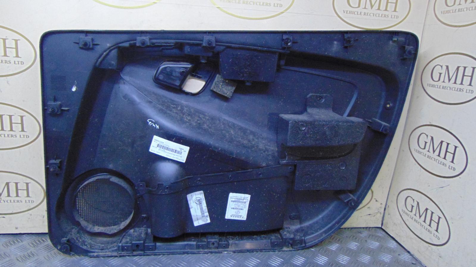

Here is a picture of the inside of the panel
Looks like the standard clip on job. but these are on legs
See the close up of one

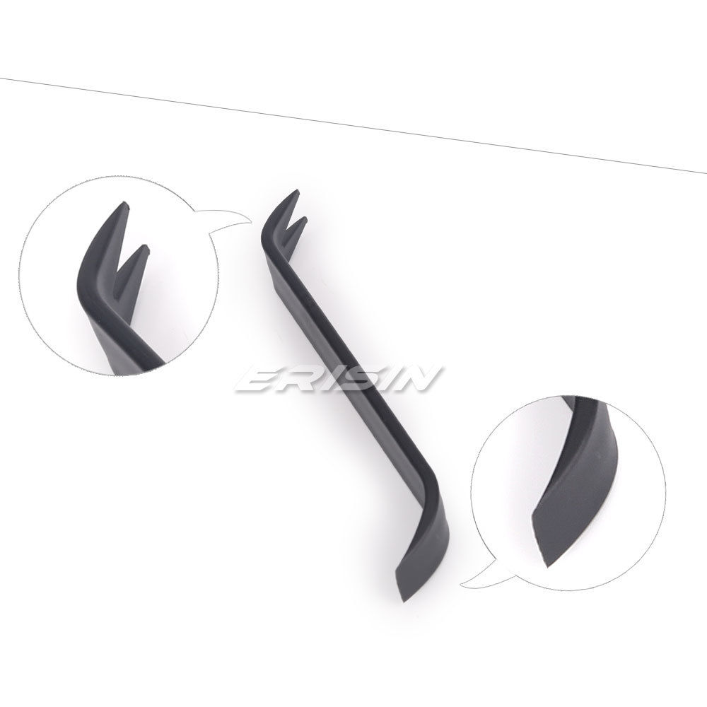

Thanks muchly. hmm so maybe i just need more force with a bigger leaver? i have been trying to use my nice but small plastic bicycle tire levers... but it looks like i should be pushing up to un-slot the clips? hmm
yea i should get some of those. I’ll search aliexpress in a bit.
Well i used more force on the bottom edge of door trim and it popped off. then lifted it off the 3 top hooks. Did half break one of the top circular hooks.
