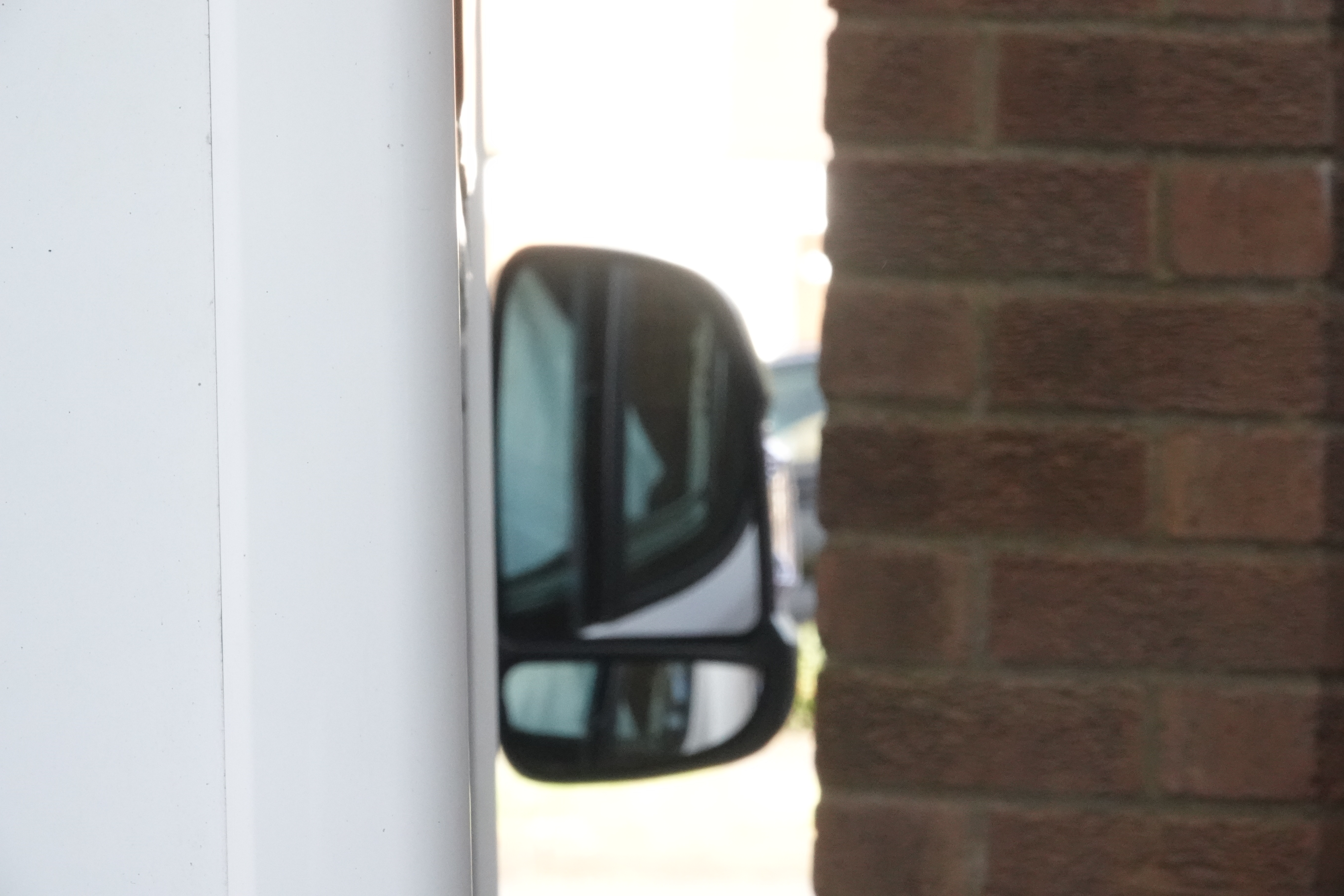

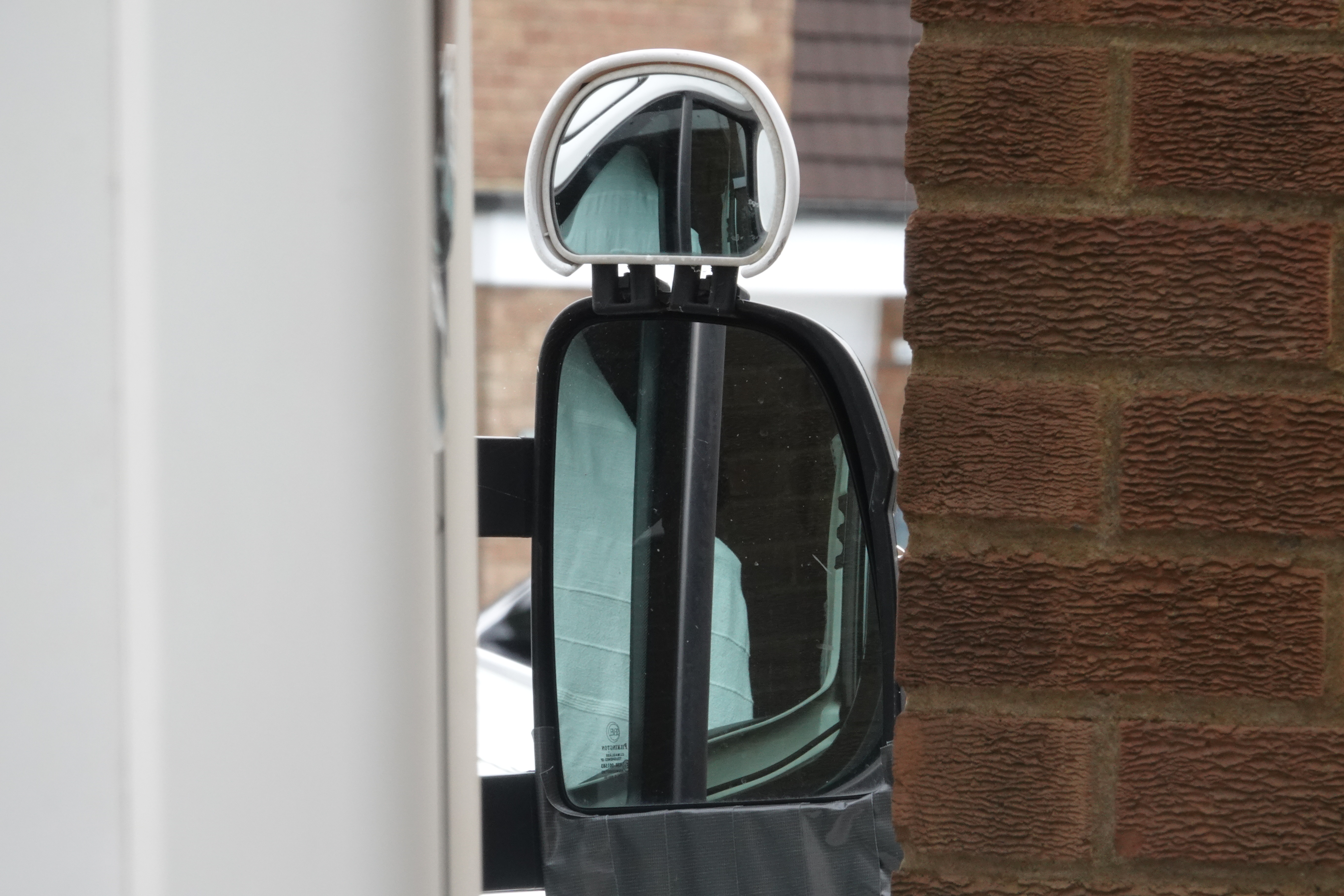

Long arm or medium arm. The 2 photos position is taken using no paralax, the habitation door is open to make sure im not cheating (with door closed there would be a small amout of arm showing.
