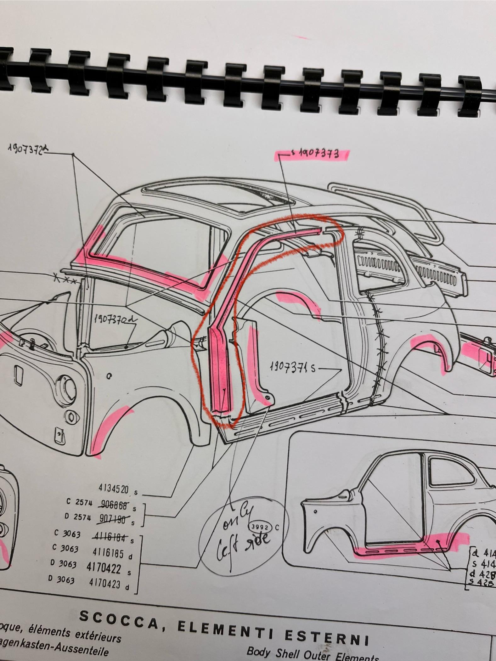

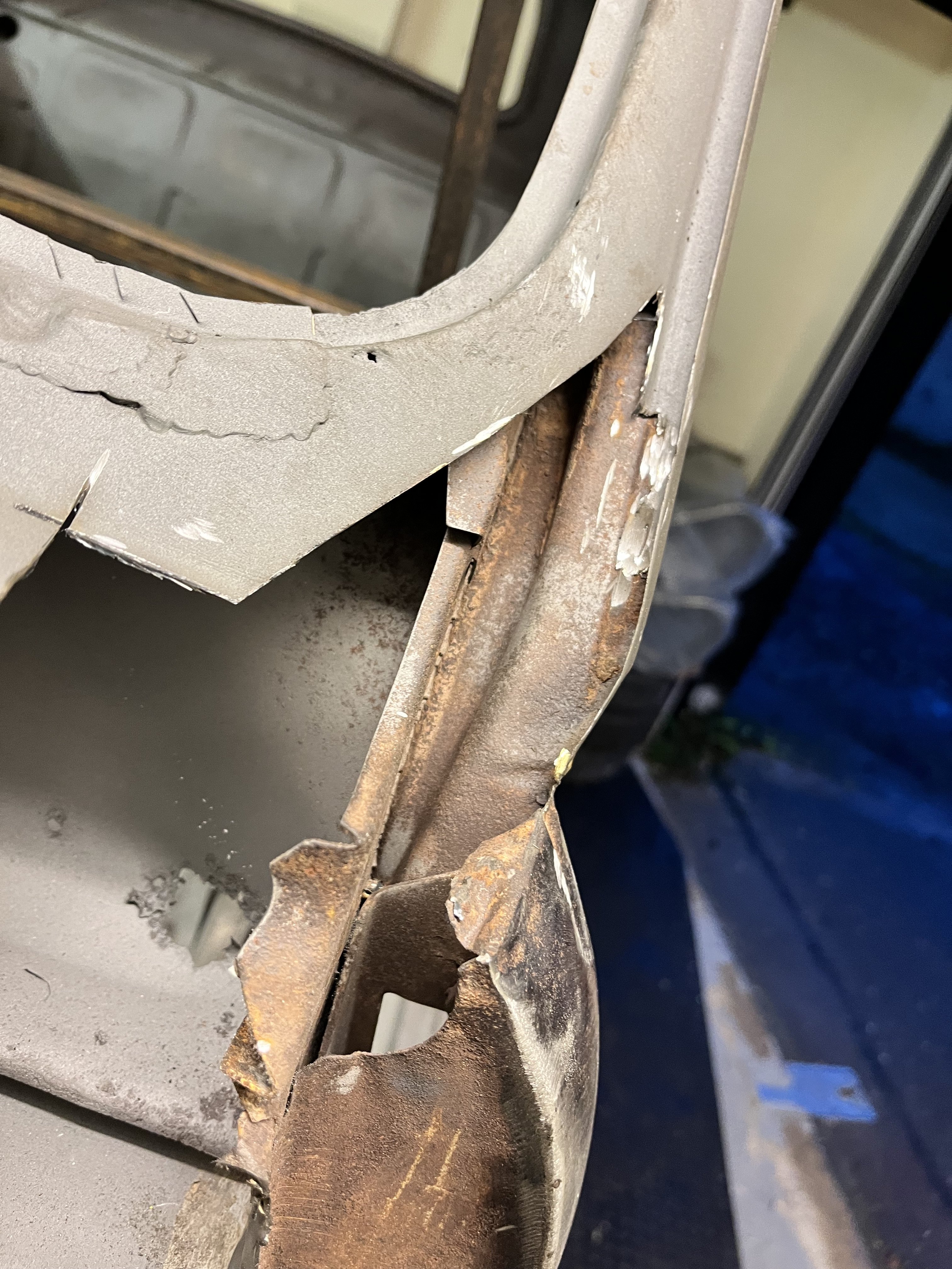

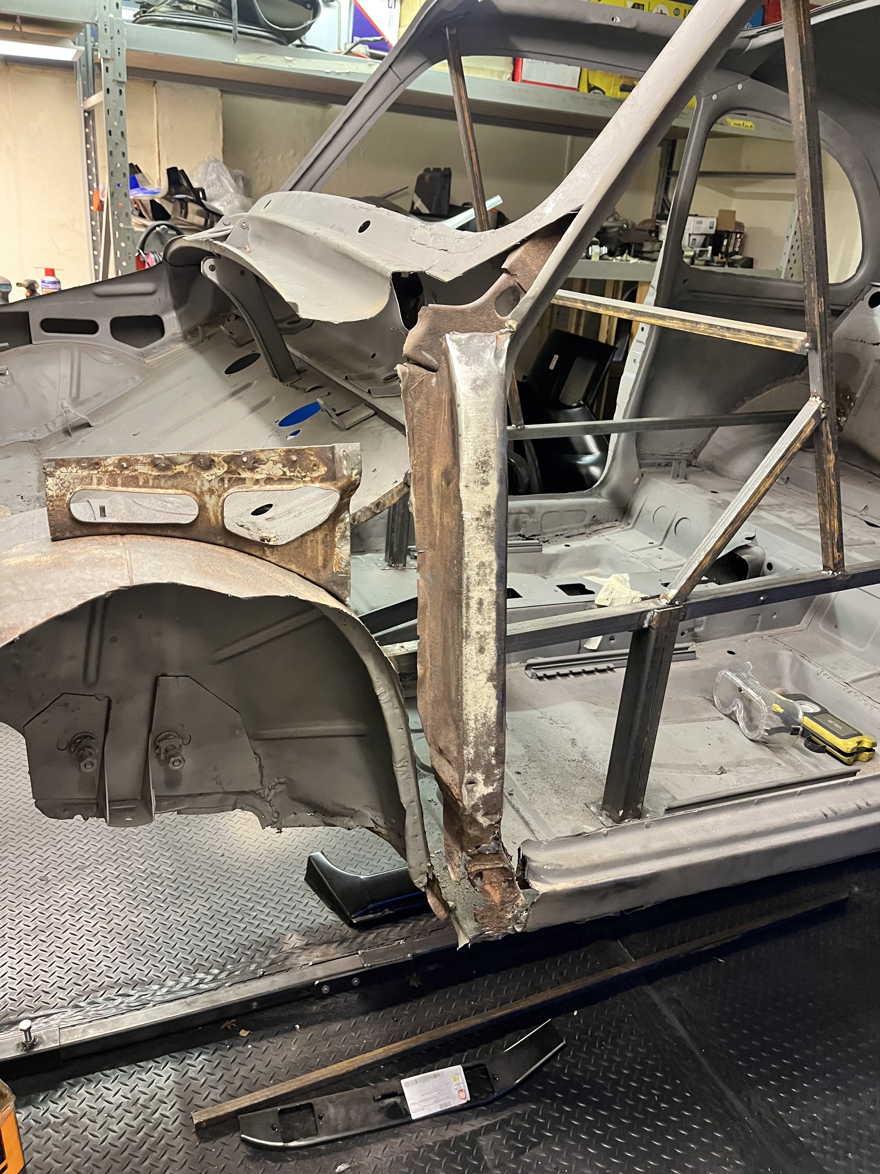

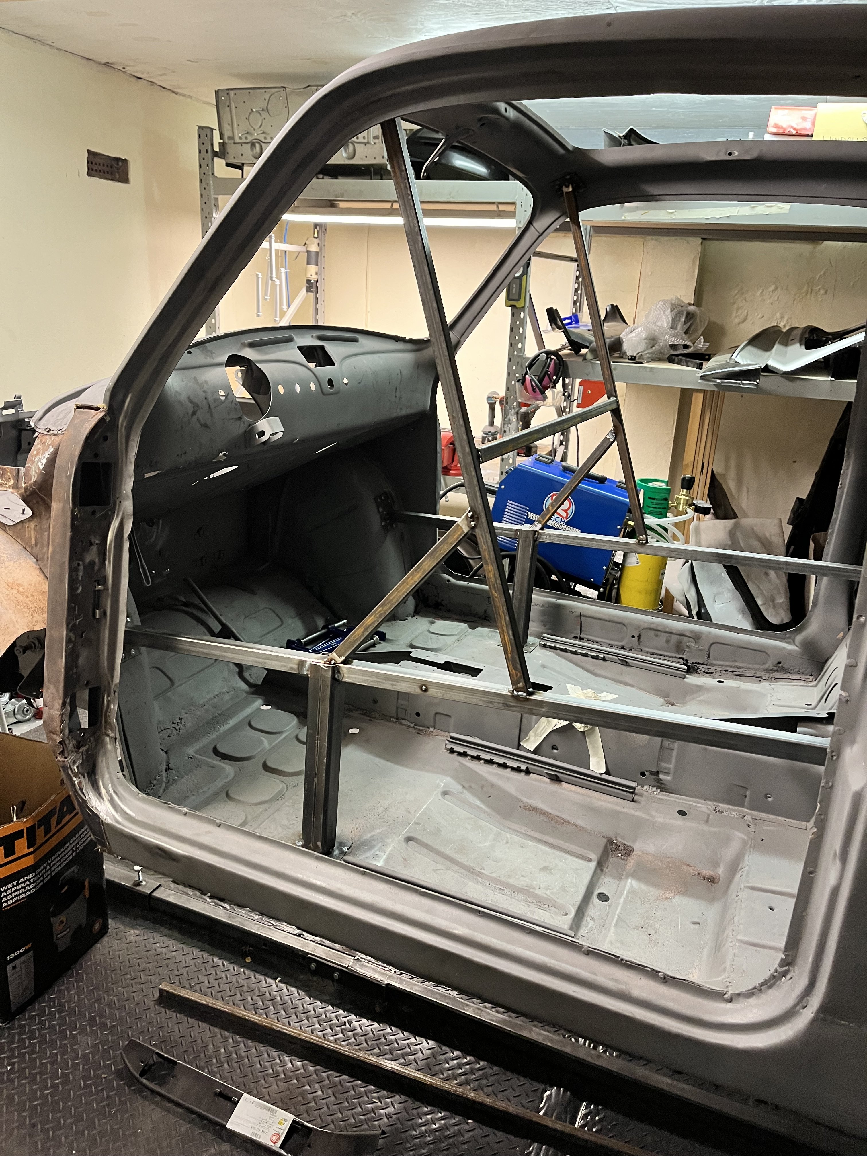

Hi all, thank you for your replies. Much appreciated. As an update please see below a couple of pictures after bracing the body to avoid deforming the door frame area and after some chopping to expose the a-pillar and the skin that covers it (the skin is part of the door frame as you can see in the picture from the spare parts book circled in red). The skin is in pretty bad condition and requires fixing or ideally I can replace it with a repair panel available somewhere.
Does anyone know if a repair panel for the skin mentioned exists and where to purchase it? Fixing the skin will require some serious fabrication skills otherwise….

@francisco83 , did you post this on the wrong thread? I thought you had started elsewhere.
The only way I have see that panel available is on a complete side replacement panel, which is so rare and expensive that I have only seen them twice in twenty years; and although I have one of them as a display item, it is priceless to me.
Maybe you could adapt a section from a full, rear quarter repair panel from the opposite side of the car? It might be easier than making something from scratch.
Thank you @fiat500 and yes I posted in the wrong thread. Sorry for that, I didnt mean to divert the focus of this thread. I just reposted it in the original one.
