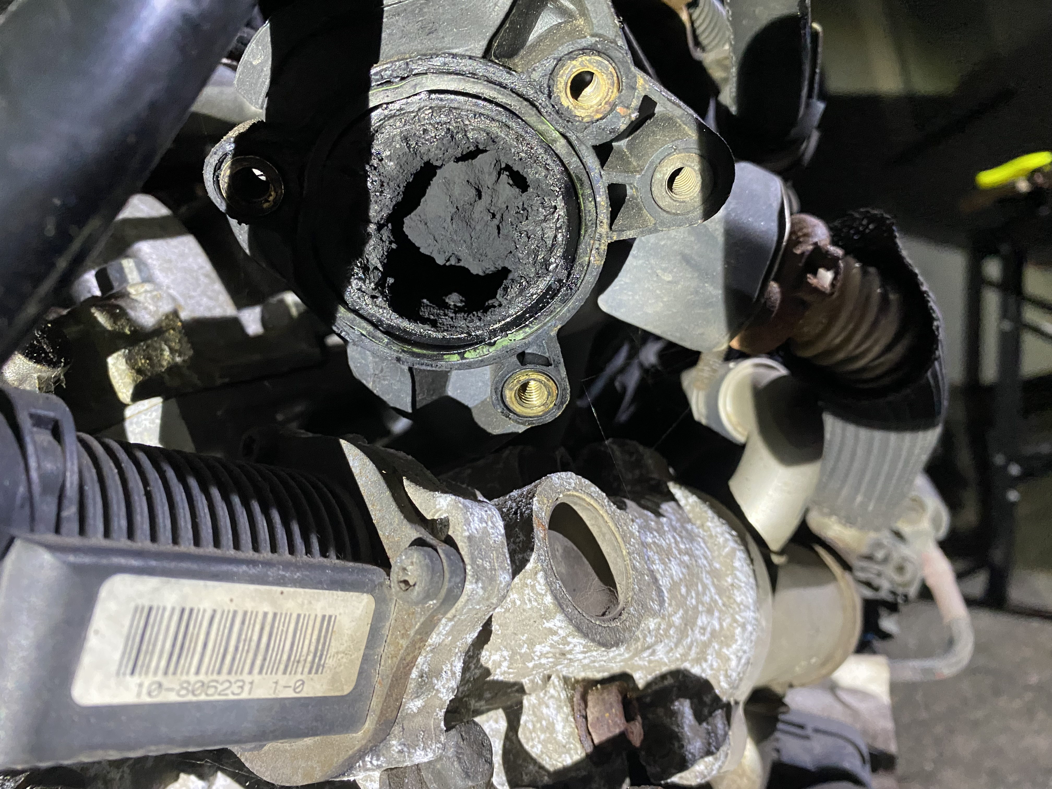

I bought mine with a broken timing chain, but found the inlet side of the engine was clogged solid with soot. Drive it too slowly and soot will build up until the restricted airflow become s self-sustaining soot collector. But I paid only £100 so it was worth the punt.
The valve rockers break if the pistons hit valves the rockers break off. Mine had two broken and two with falling apart needle roller bearings.
This was my inlet manifold caused by excessive slow driving.
