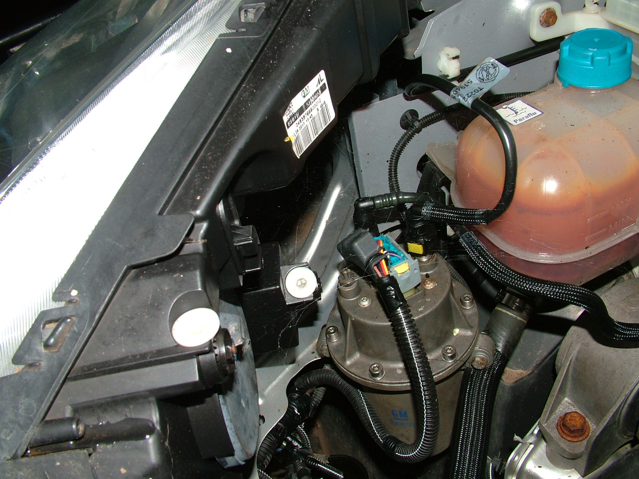

Some models have a big UEFI ? fuel filter unit that has I think five wires going to it that may be related to that.
I have a couple of 2010 1.6 Doblo MJs and a 2014 Vauxhall Combo 1.3 which I think from memory has that type filter, but none of them suffer from the issue mentioned. I haven't checked for fuel temp readings. This is the Vauxhall one on the 1.3MJ Combo.
