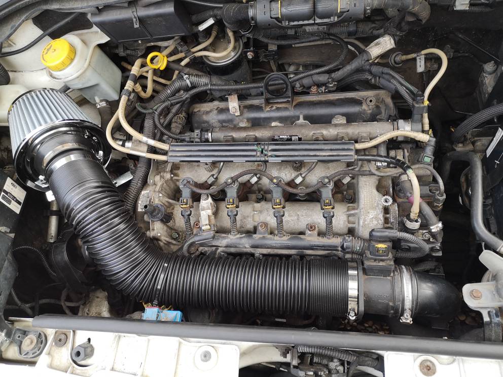

Don't make the same mistake i did and buy an engine second hand as the one i ordered originally was to have only done around 50k ended up with no compression a hole in the manifold seized alternator EGR pipe cut and completely carboned up
In the end i had my original engine reconditioned and was the best thing i did
Runs like a new engine and cost me £700 with a good warranty
Currently its been great and have done about 70 miles
Luigi
