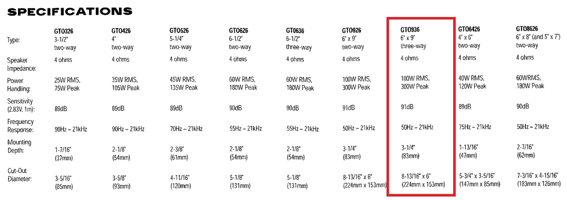

Here are my amp, speaker and player specs:

You can connect the speakers directly to the stereo, but without a separate amp the speakers will only be working at about 20% of their potential.

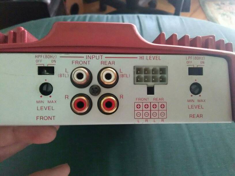

Can you tell me are those setings ok for my speakers?
HPF(80hz) ON
LPF (80hz) OFF
And those Levels, one under HPF, I think that it is front level, around middle, and level under Lpf, I think it is rear level is bit more to max from the middle.1536141455080.jpeg
HPF filters out higher frequencies, it's usually used when you want a very bass-heavy output, I'd recommend keeping it OFF.
The LEVEL dials will allow you balance the front and rear speakers when you are using all 4 outputs on the amp, adjust to suit your own preference.

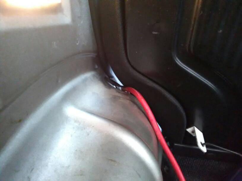

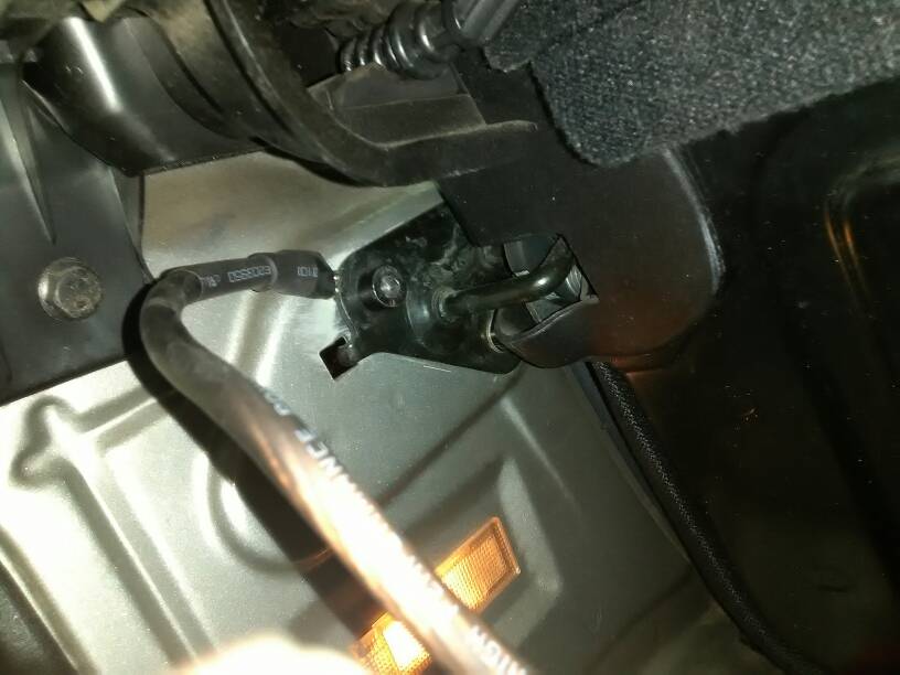

Update: I need to sort out wires, to make them look bit better. I have connected ground on bolt behind rear seat holder. I scraped a bit of paint to make better contact to the car body.

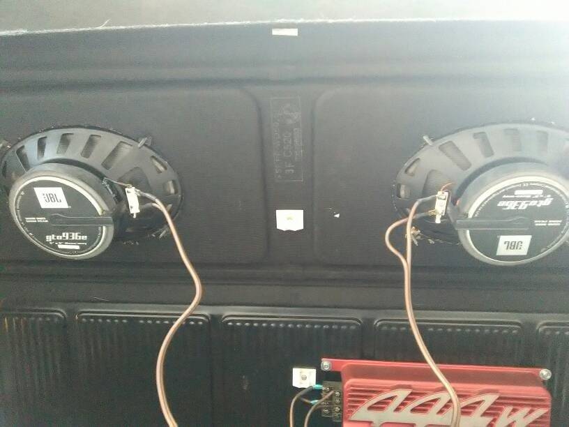

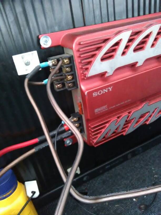

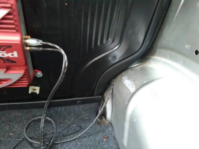

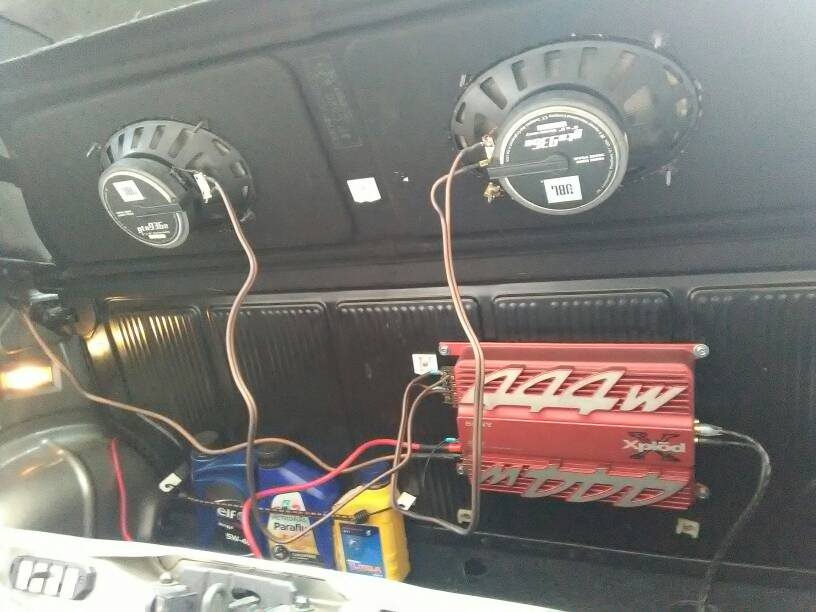

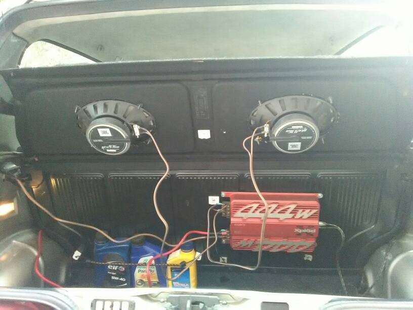

Here are the photos, someone might find it helpful. Speakers are connected in bridge (btl) mode (2x222w max, 2x80w rms...speakers are 100w rms and 300w max).
Hope you like it. :D
I am having problems with my phone when I try to upload photos, so I must write seperate post. :(IMG_20180929_165027.jpegIMG_20180929_165035.jpegIMG_20180929_165052.jpegIMG_20180929_165059.jpegIMG_20180929_165112.jpegIMG_20180929_165126.jpegIMG_20180929_165137.jpeg
I am having problems with my phone when I try to upload photos, so I must write seperate post. :(View attachment 194485View attachment 194486View attachment 194487View attachment 194488View attachment 194489View attachment 194490View attachment 194491
