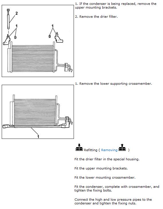

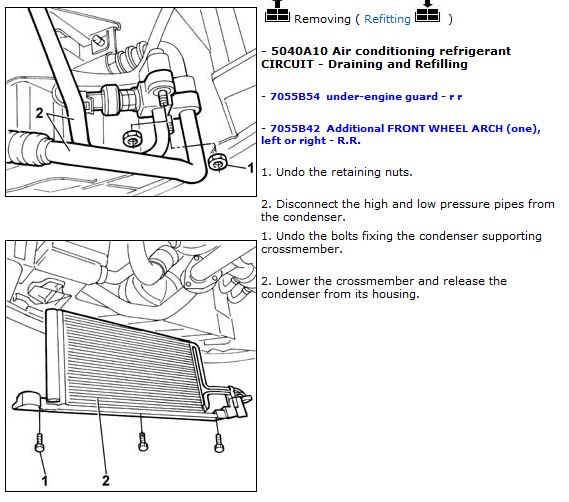

The condenser complete with the drier comes out from underneath the front of the car. You will need to jack the car up high enough to lower it out.
A new condenser is usually supplied complete with a new drier so you won't need to remove it from the condenser.
