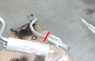

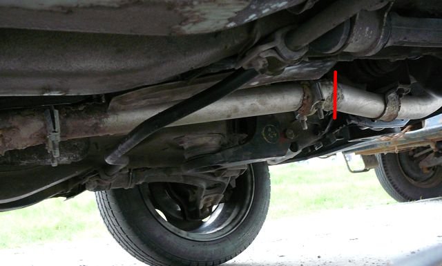

for user 'phatcent':
cut here, find tube with similar diameter and lenght (try junkyards)and weld it in same direction as cat-this is very important, because rest of exhaust wont be sitting very well-touching and knocking on underbody, then fix with new fastener as normal part
or you can do it like me-weld short piece of pipe with higher diameter on that front exhaust pipe and put that pipe in-you can swap to cat without welding anytime
use new fasteners and exhaust sealer, store your cat if youll need it. seis exhaust should be the same
